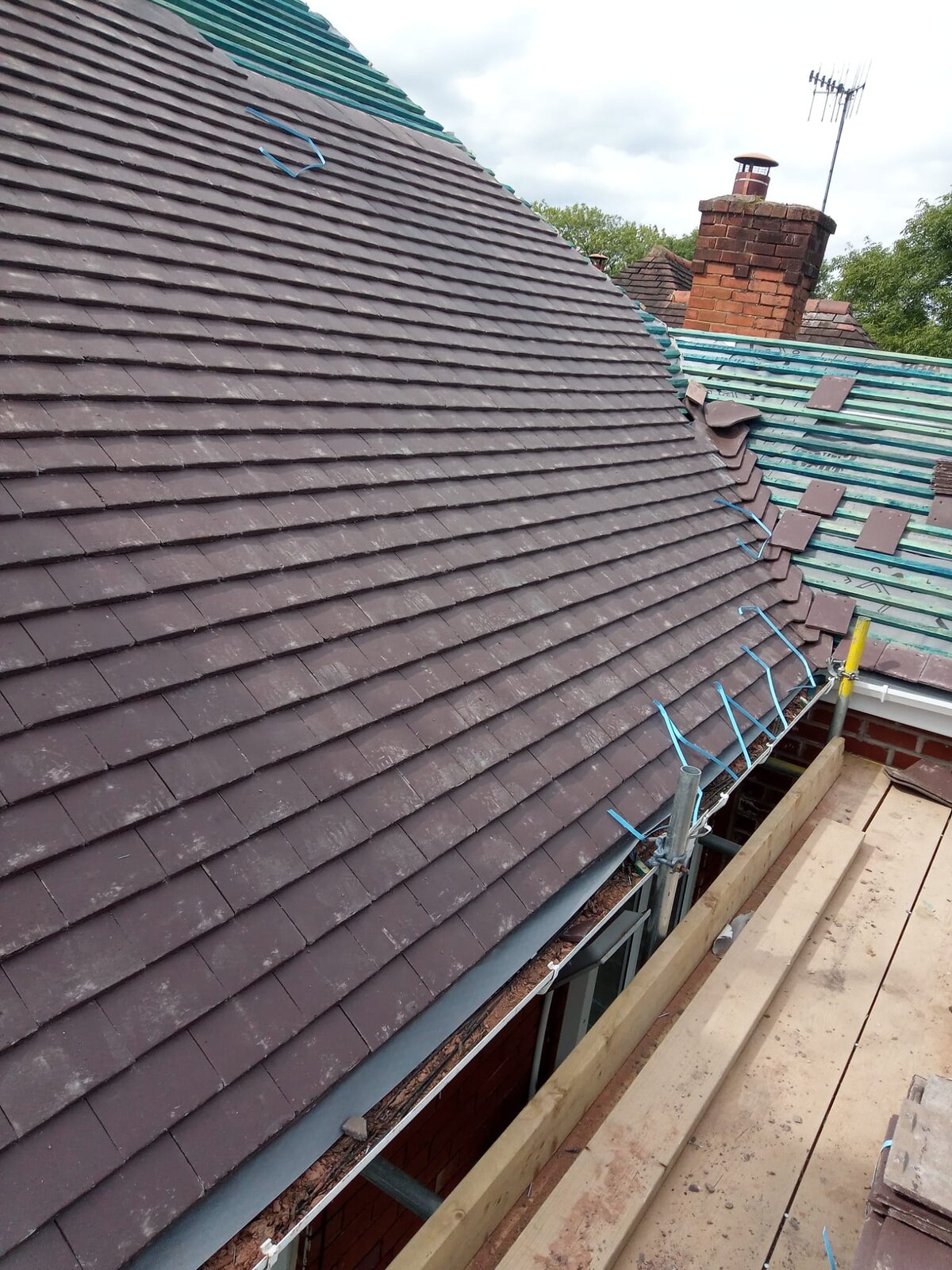

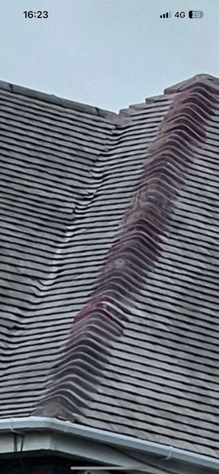

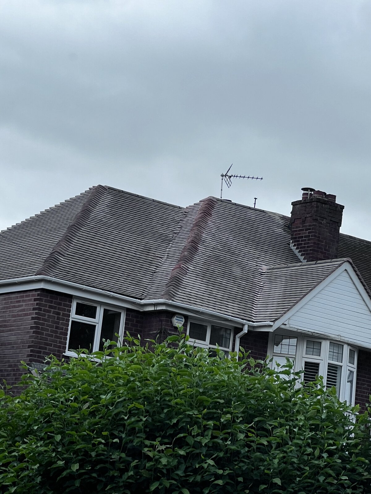

We’ve been dealing with a cowboy builder and have reached an impasse.
There have been various incidents of poor workmanship and all of the other hallmarks.
We are not in the trade and have young kids so had to put our faith in someone who had come recommended but didn’t turn out to be what we’d hoped.
We had expected the new roof to be outsourced to a proper roofer but he basically gave it a go it seems.
Do you think that this looks sufficient to claim poor workmanship? The valleys are wonky, the wrong hip tiles have been used and are not fixed straight and there is a tremendous amount of staining and mortar on the tiles all over the roof.

Yes. Poor work by whoever did the roof.
Besides the obvious:
The hip irons are missing.
The bay ridge lacks a lead saddle and has been codged up with mortar.
Pics looking down into the gutter might also help?
The valley's might have difficulties discharging into the gutter?
The stack back gutter needs checking.
FWIW: you need new correctly installed flaunching on the stack.
It will be difficult to get front gutter pictures although I will try.
You can slightly see it on the picture but I wonder whether the step up where the two roof ridges meet should have been done in ridge tiles rather than bonnet.
Bonnet shouldn’t have been used in the first place, the brief was to match the existing which were arris but I suspect the builder didn’t know the difference

It's as rough as a bears arse, yes.

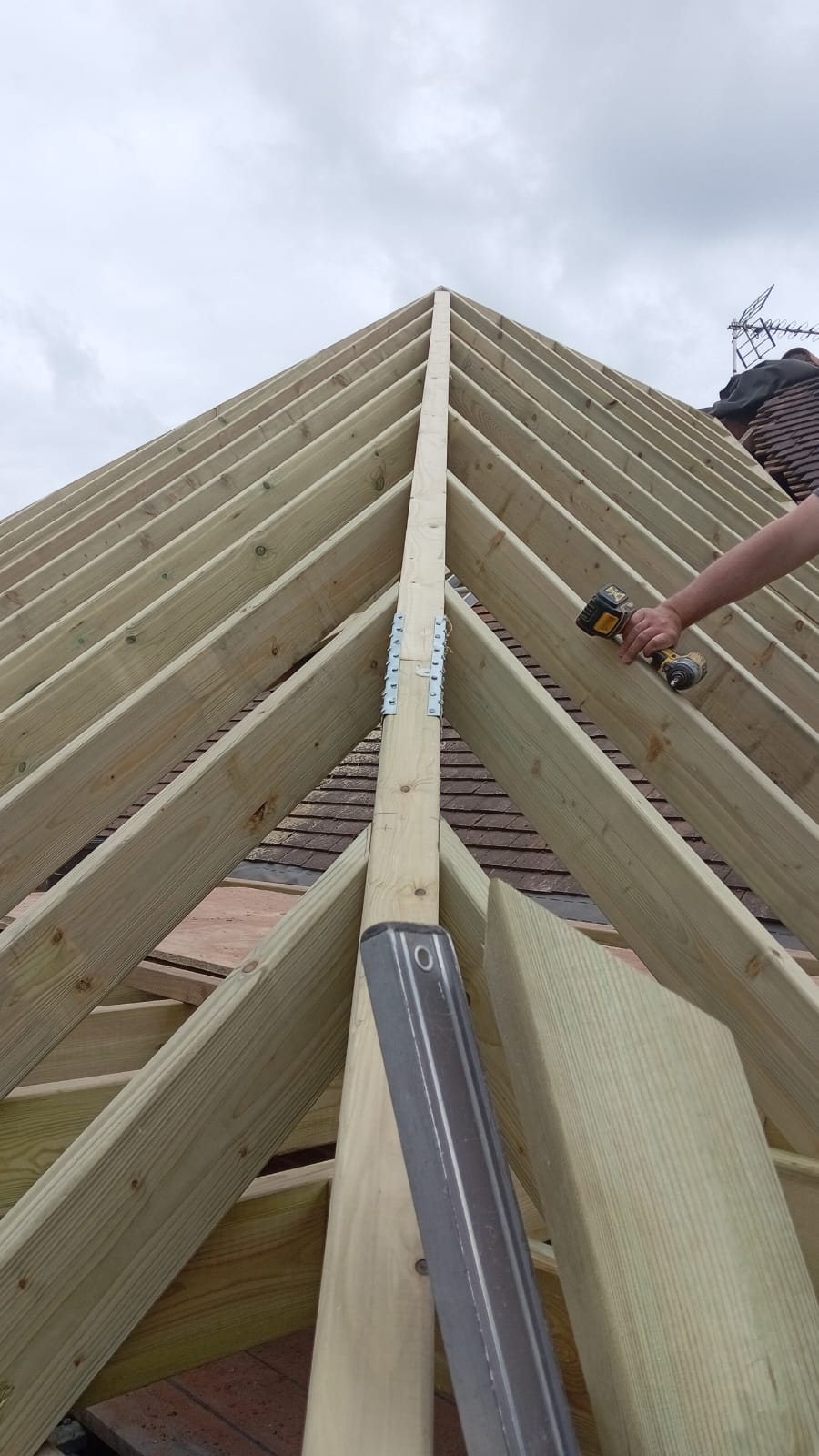

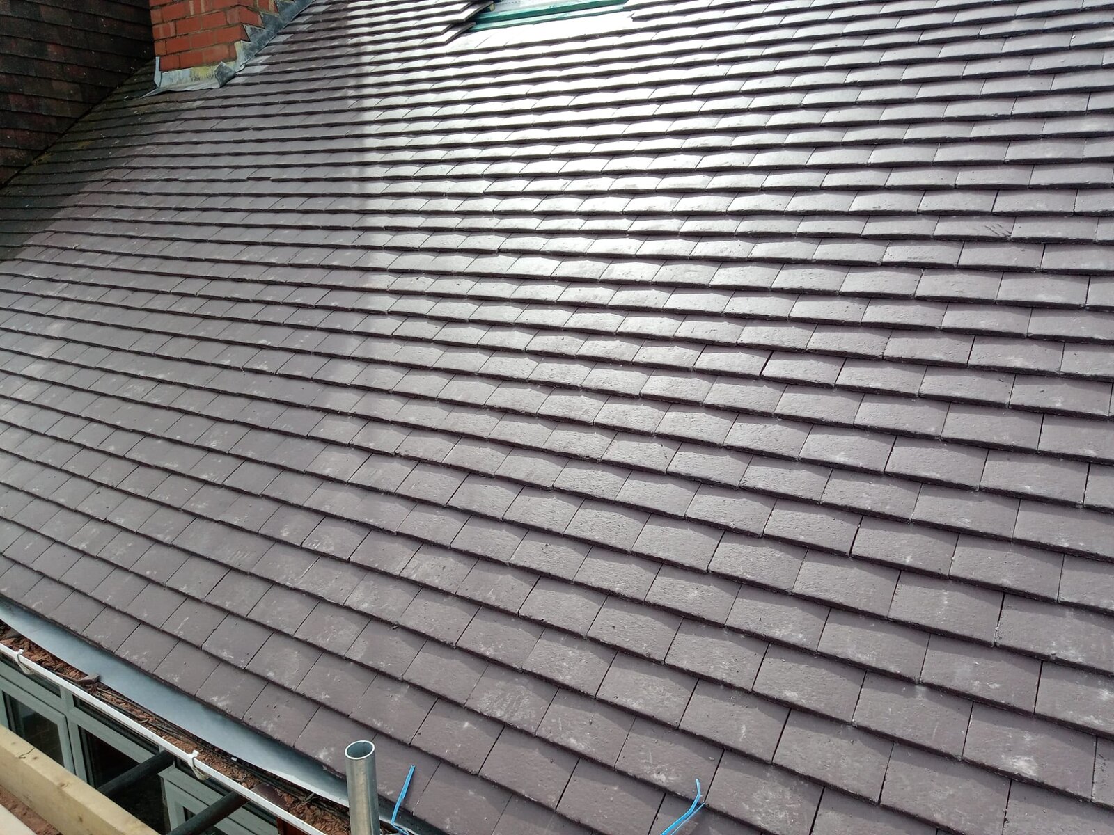

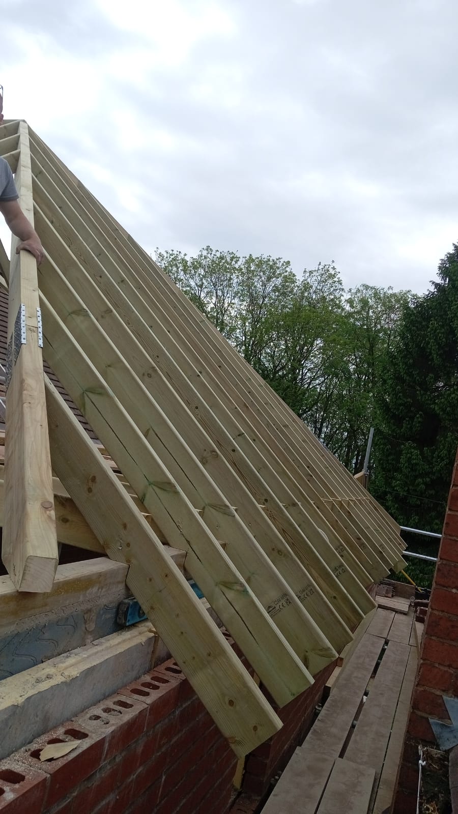

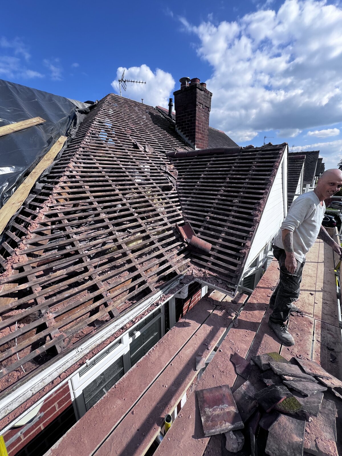

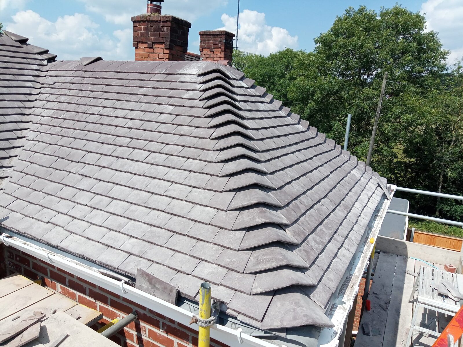

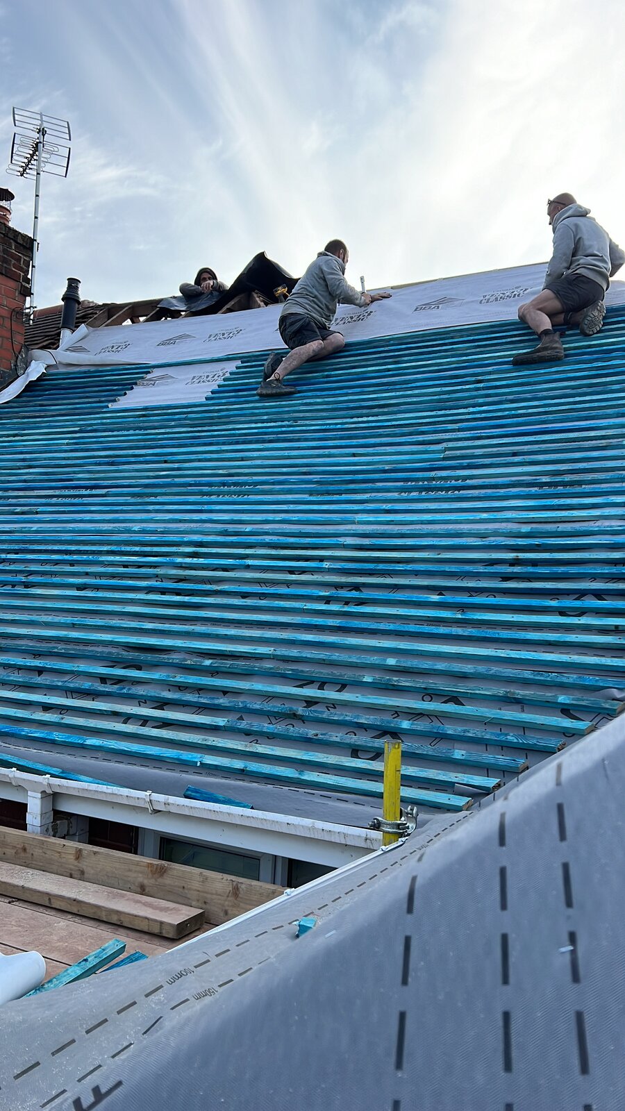

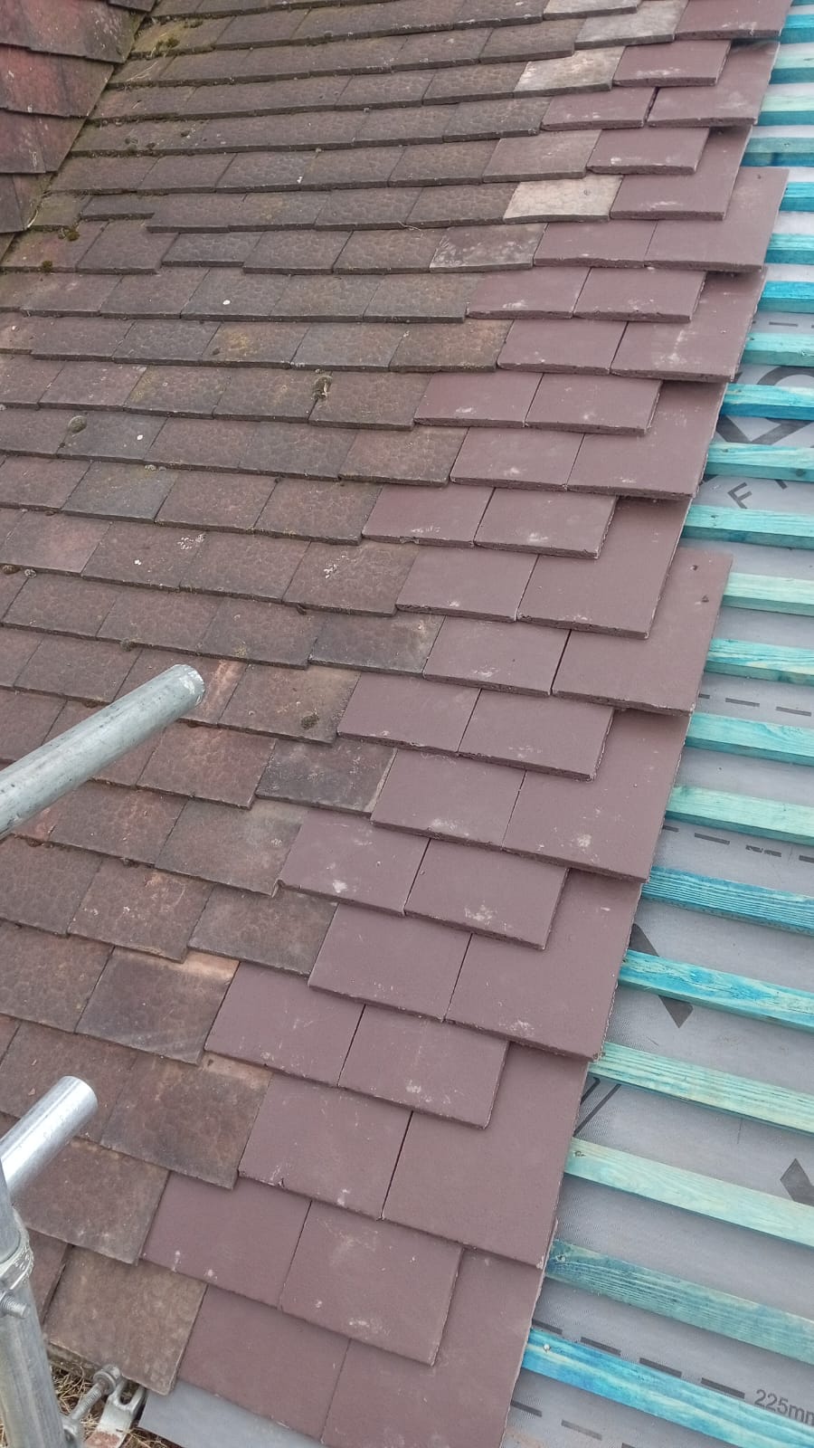

Do you have any pics of the work inprogress?
I’ve got a fair few - to avoid me bombarding, what is it that would be useful to see?

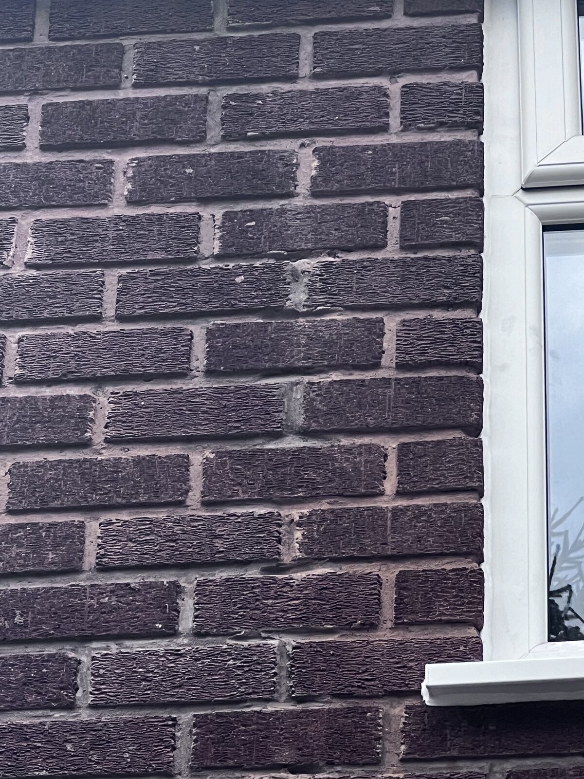

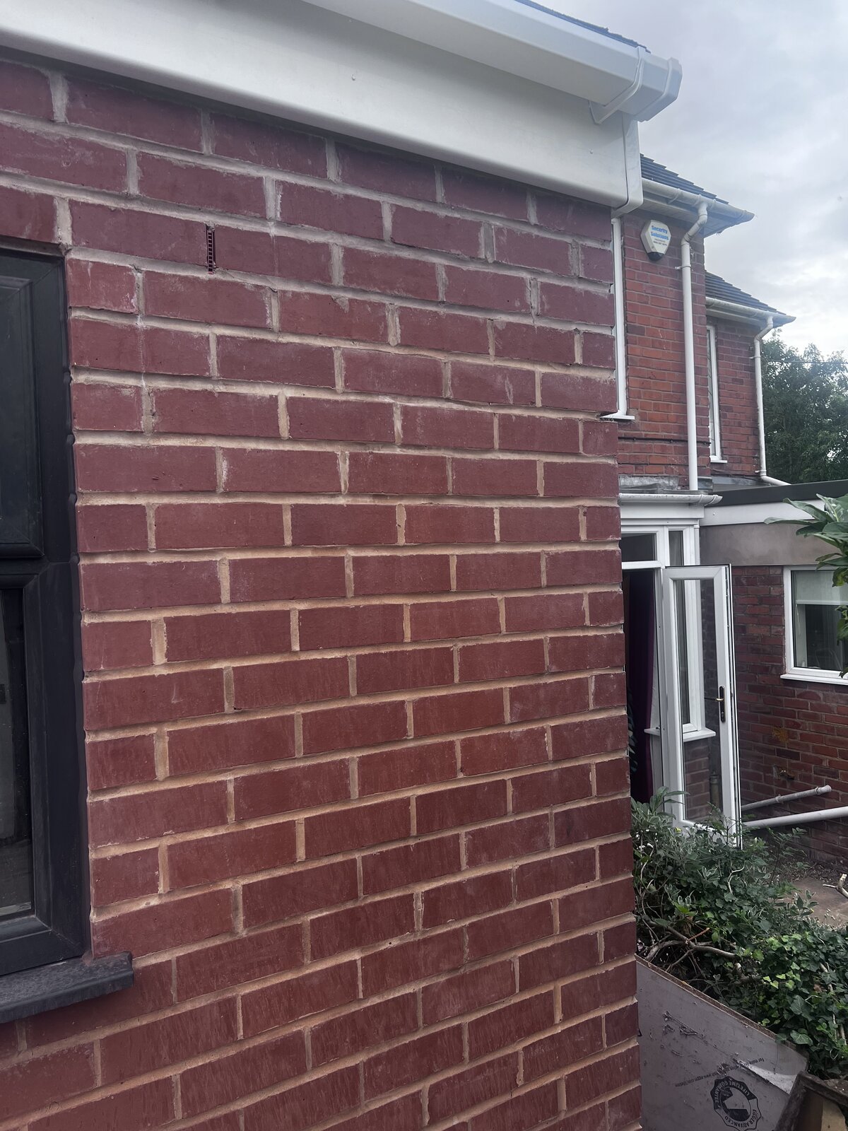

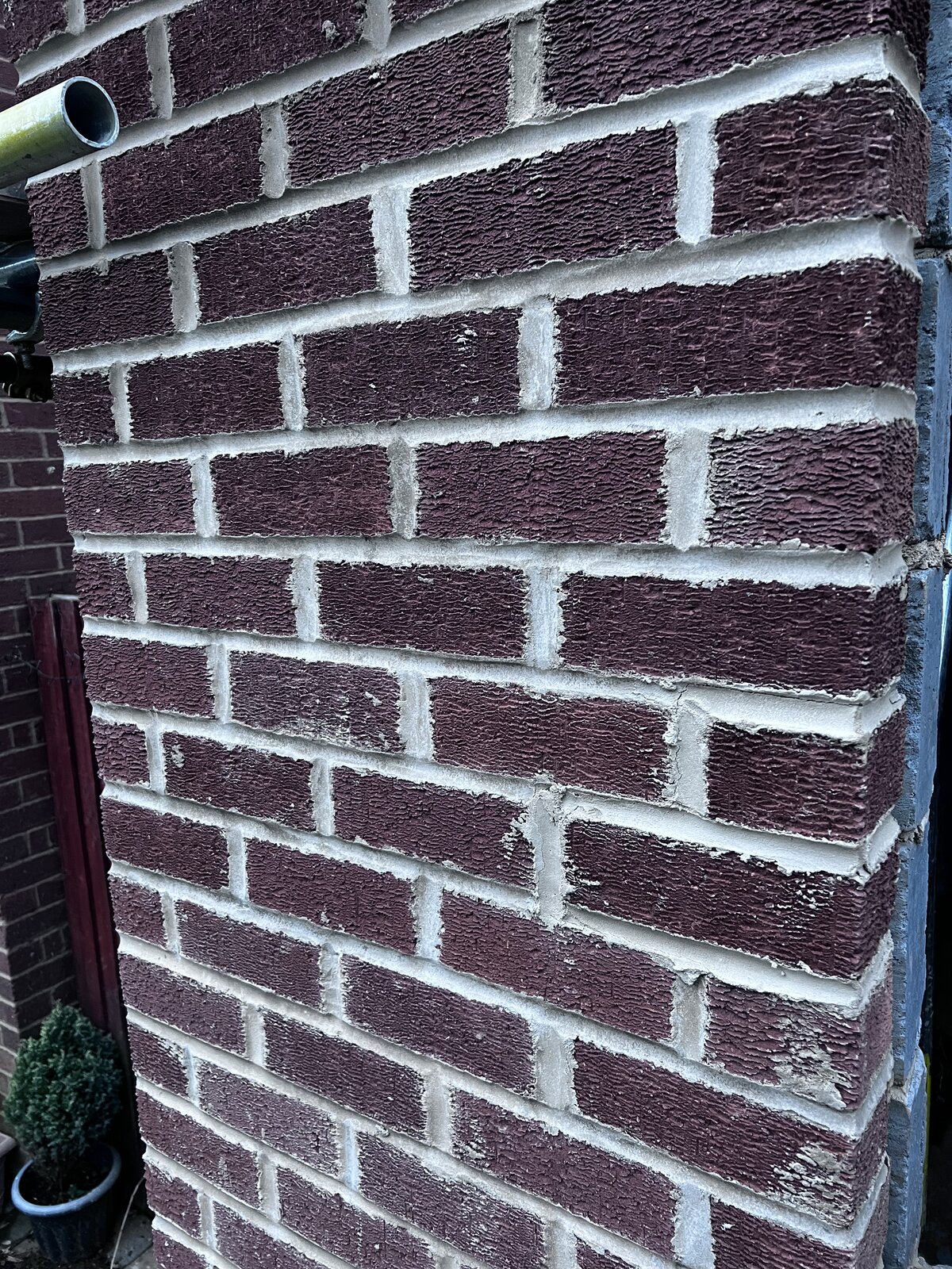

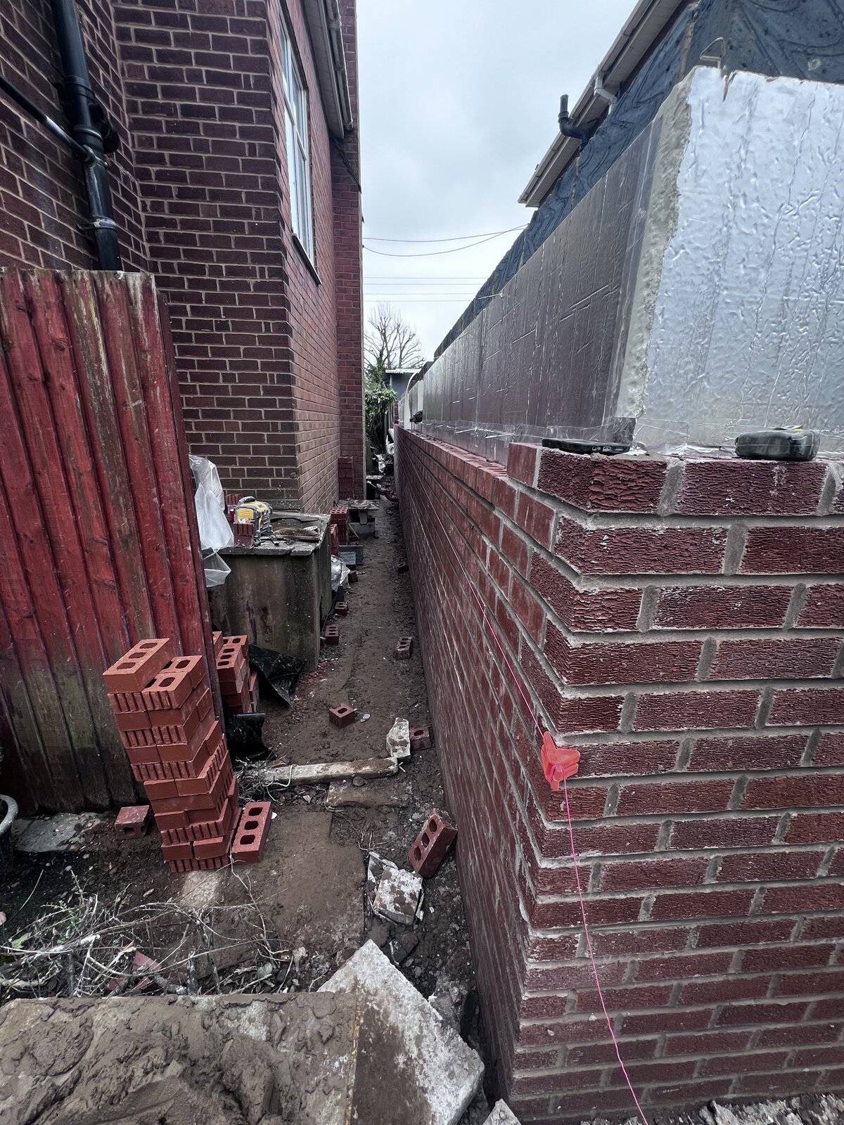

I’m afraid the brickwork is worse!
While I can imagine it’s hilarious to see such clownery - if anyone has any guidance about what action to take, it’s a very unpleasant situation to be in.

I am not an expert but it looks to me they have the basic skills but have miscalculated the important bit of lining up the new hip with the old roof frame. Its a plus if its water tight but unacceptable in appearance

Ref any gutter pics - they are not needed since I can now see down into the gutter with your new pics.
I was looking to see if the felt peeped over the gutter - it does.
FWIW: the cut roof hip rafter & hip jacks are first class so is the batten work.
What to do next is indeed a difficult business - eg. Solicitors typically might say dont approach the law unless you have an Expert Witness report, & have worked out costs for various alternatives.
Before getting involved with lawyers, perhaps get very prepared & then talk to the Builder?

That would be because it was outsourced to carpenters!
The battens followed the path of the neighbours so presumably not too hard to mess up!
