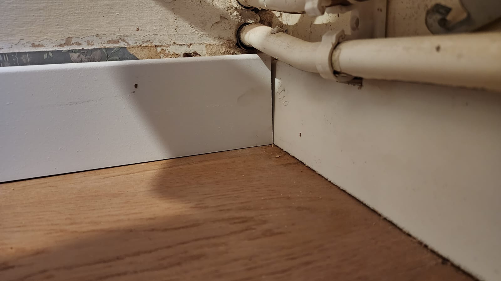

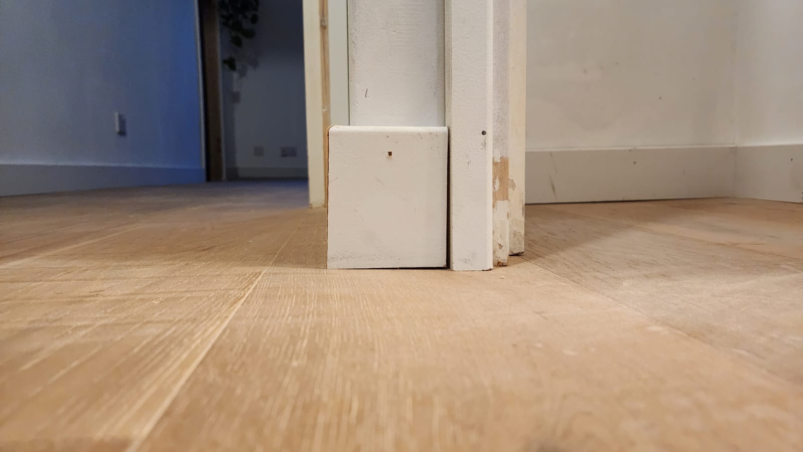

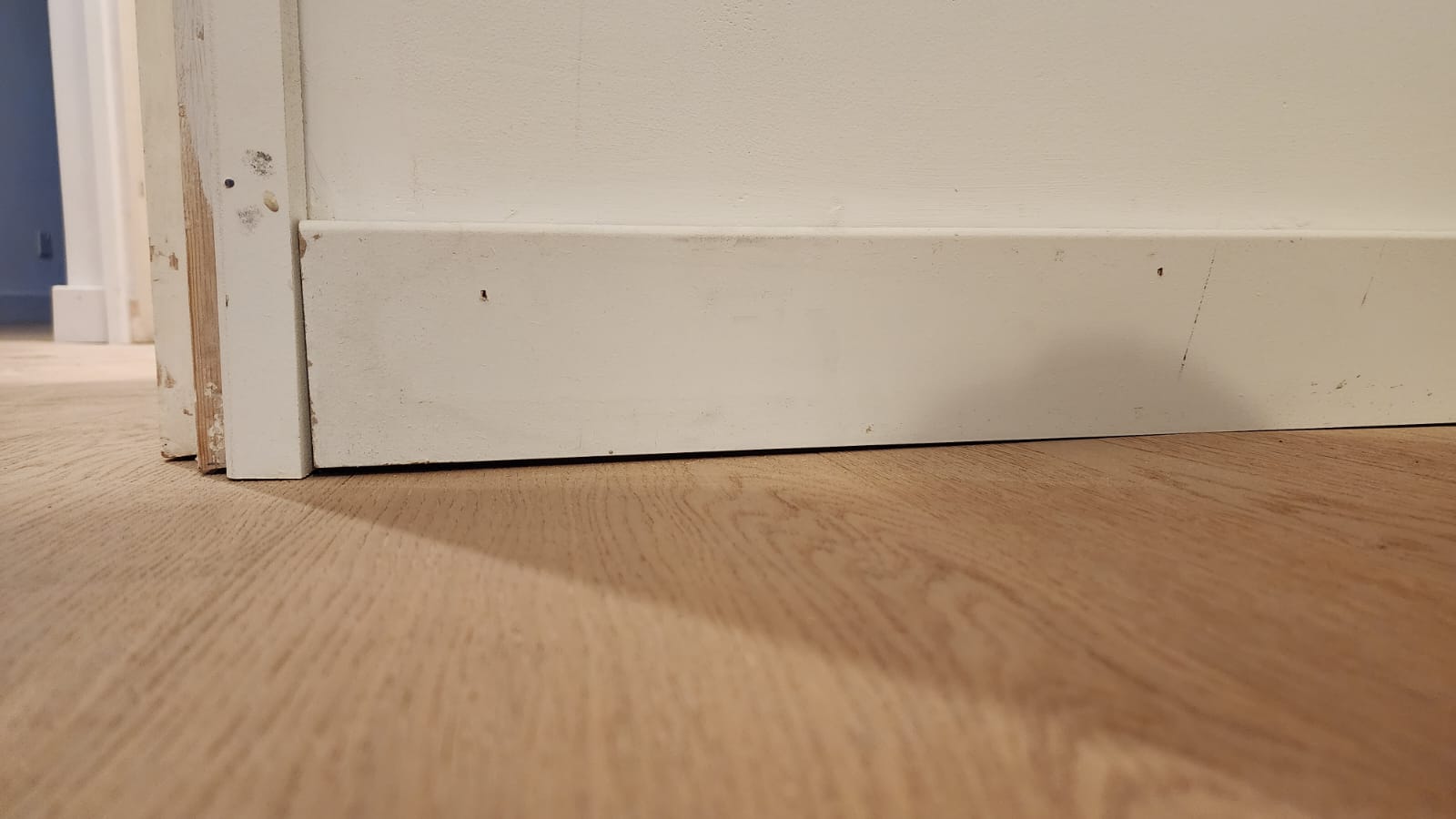

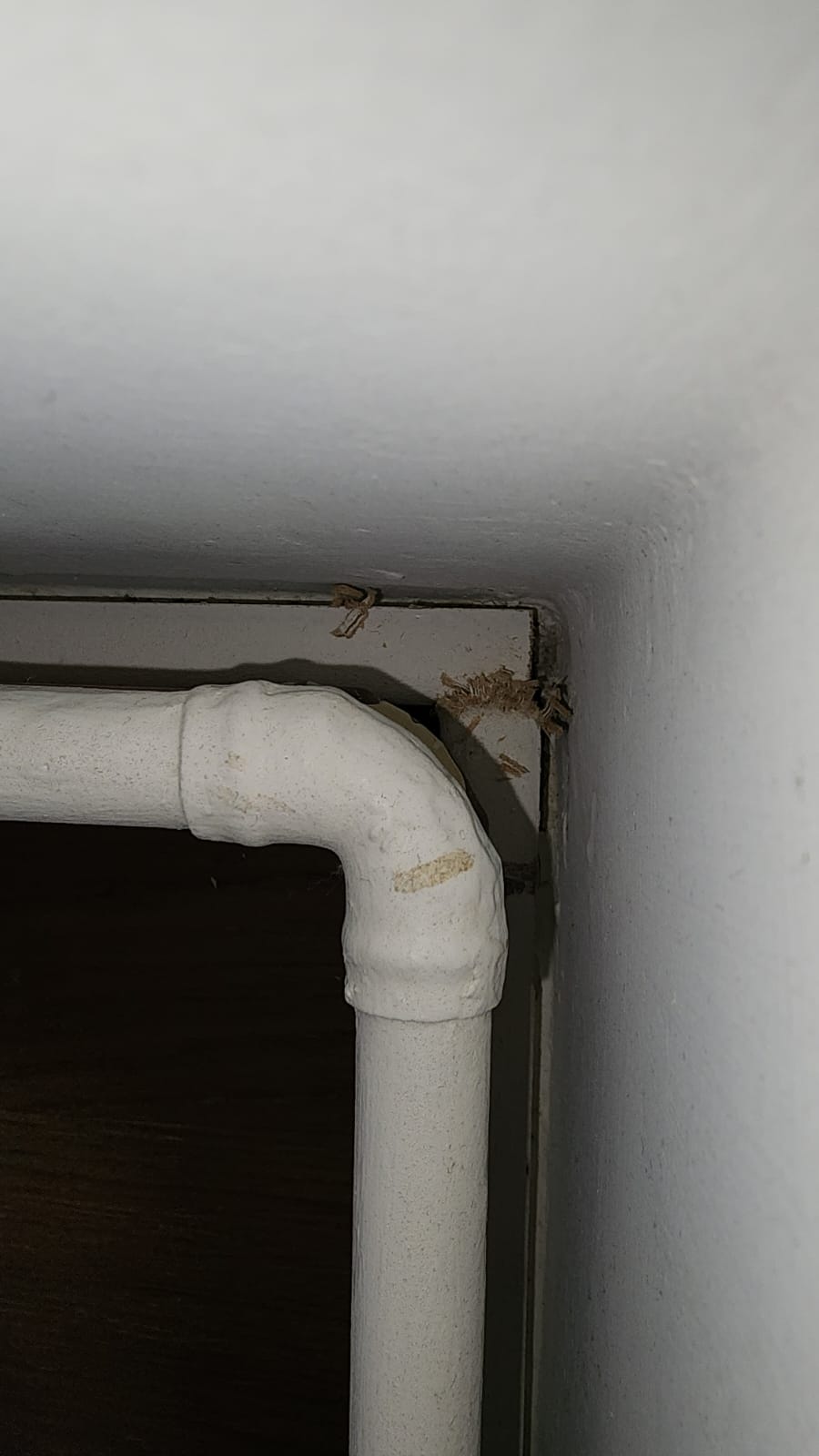

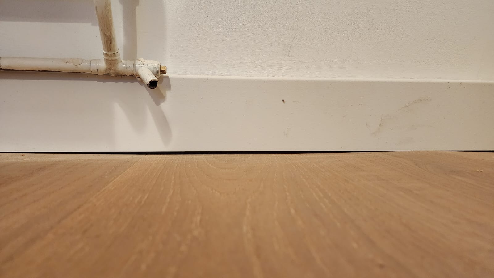

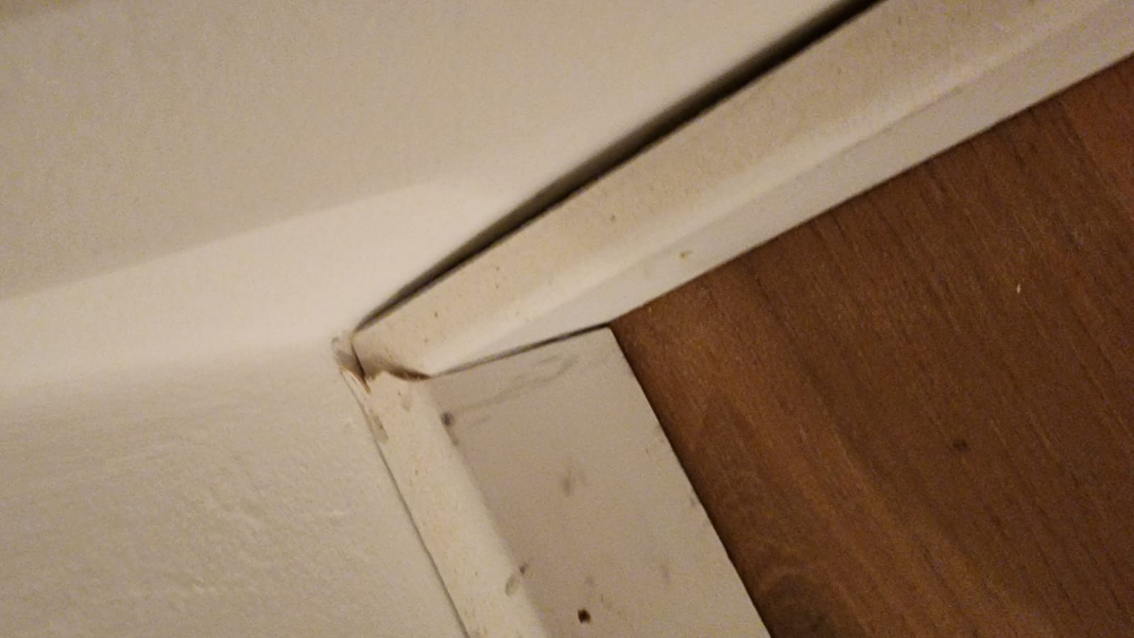

We recently had our entire 1 bed flat re-floored with engineered wood. Part of the quote included the installation of skirting boards, with the caveat that this would not include decorating & finishing. However, we are appalled with the final results. We have been doing most of the reno work ourselves (including full bathroom refitting) so we are pretty handy, but we feel given the price we've paid for this particular project, this is not up to standard.
The flooring company said we need to get a decorator in to finish it off - but there are parts where the adjacent skirting boards are not level at all; areas where the skirting sticks out from the wall by about 2cm, huge gaps along the floor, and parts where the wood has been forced in so has split. They have also been installed inconsistently, with some corners being cut at angles and others running straight into each other.
I've attached a few pictures. Are we within our rights to ask someone back to tidy up the job?

Not much can be done about the floor gaps IF the skirts are level, however, the fitting of the skirtings and the finish/mitres etc is clearly not acceptable.
If the same outfit fitted the floor and skirting, surely they should scribe the skirting to follow the floor?
I do agree with the rest of your post though. The end scribe in image 1 is pants. I am a decorator. The only way of making that acceptable would require me to use a very sharp chisel to remove the mess. If I used two pack filler, that corner would take about 15 minutes to sort out.
Again, image number 1- if they used screws rather than a pin gun, they should/might have been able to reduce the gap.
I would not be happy, and as a decorator, the cost to fill the gaps to high standard will probably cost more than the labour paid to fit the skirting...

I think it was more likely that he trimmed the underside of the door frames to accept the flooring. Doing so will allow the flooring to run under the door frames- it is a plus.
Image number 1- screw and plug would have probably pulled it in. It is brick, you should be able to get a decent fitting.
You seem to have had a guy using a 15 gauge pin gun to fire brads (read: nails into the wall). I have previously used a pin gun in similar circumstances.
They used brads/pins which will hold the skirting is place as the adhesive sets, but they are unlikely to pull the timber into the wall (whereas a screw and fitting would).

You pay pros, you should expect a (close to) flawless finish. That's a lot worse than my DIY. The gaps in the floor-skirt are IMHO unacceptable. If they used levelling compound the floors should be level!. If the skirt is straight the flooring isn't!! Have a look at the spec sheets from your laminate supplier - I have a feeling that gap/hump is outside their spec, in which case the joints are stressed. They will probably be OK, but doesn't look great and it's more leverage. For example, Quicksteps flatness tolerance is 2mm/1m or 1mm in 20cm. That looks like 2-3mm over 500mm. If it's out of spec, it hasn't been installed properly.
They could have scribed the skirt. As to that internal coped joint! I think you are quite within your rights to withhold the final payment until it's corrected.
