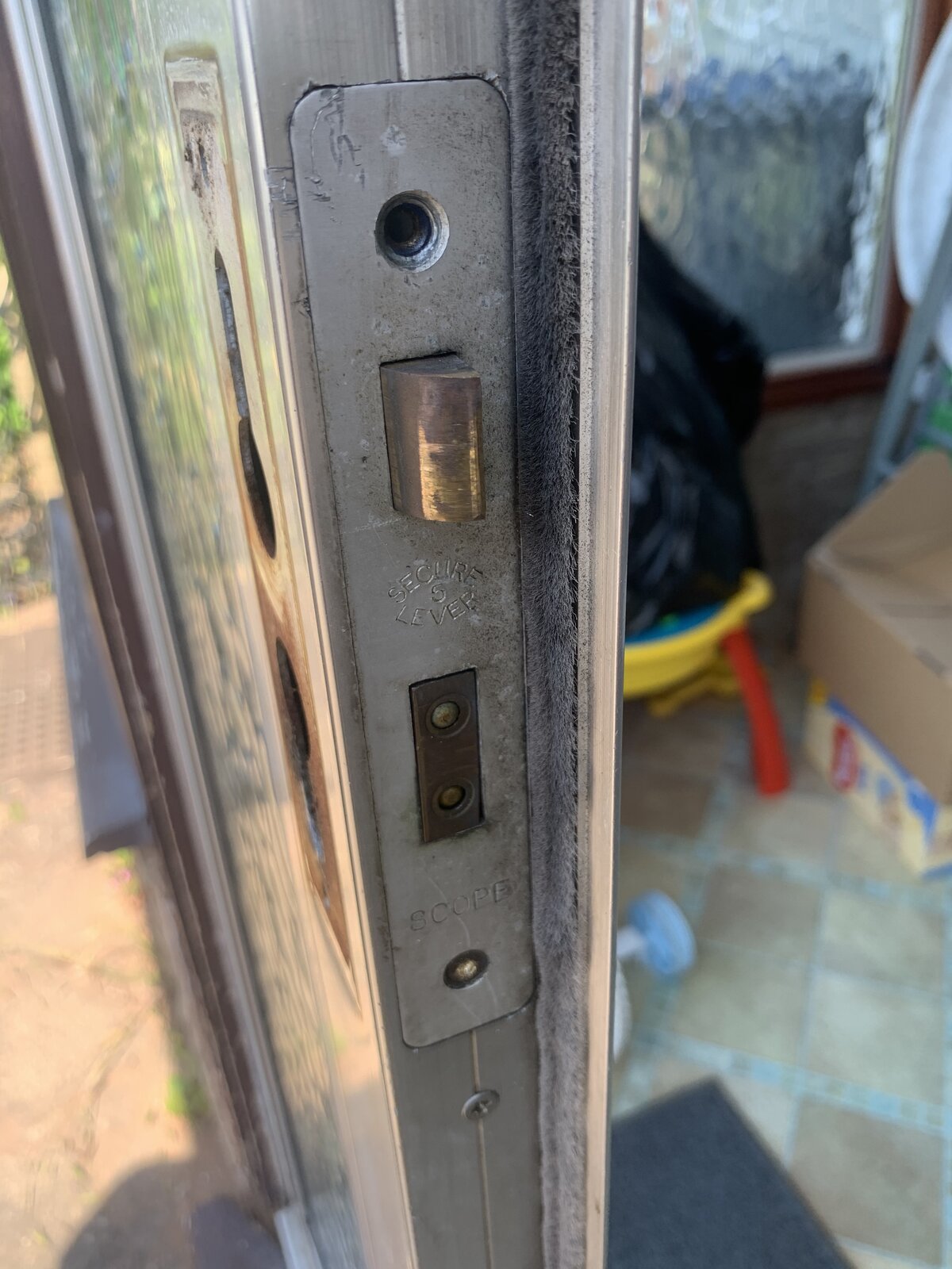

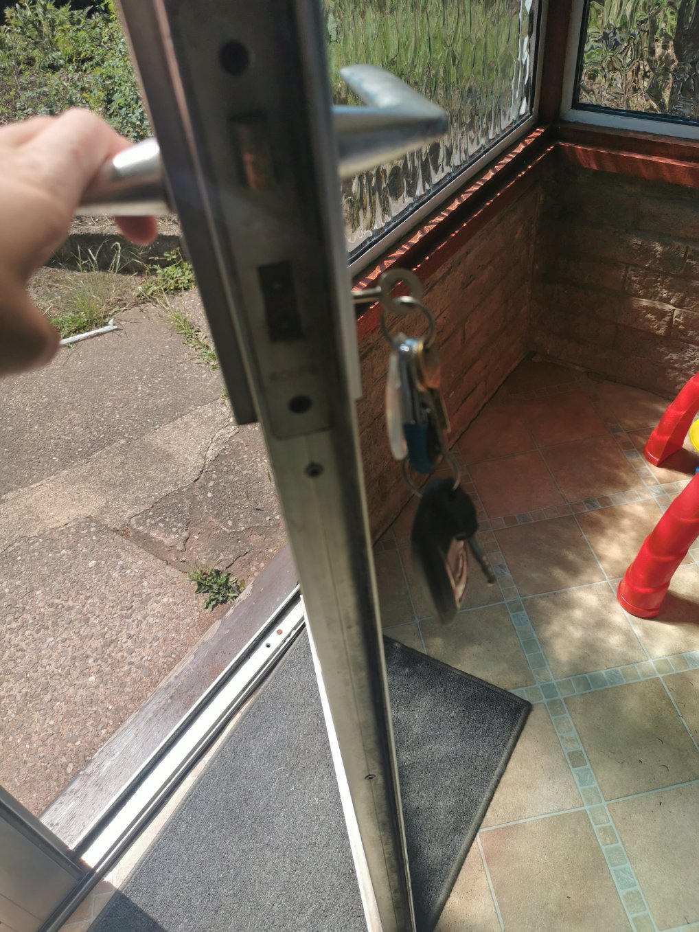

have a aluminium inset into wood porch and the lock has been playing up and want to change it.
Anyone know what type of lock it is and where I could get a replacement? Pictures attached

It’s a sash lock but very narrow and only 35mm backset
try and take a photo of the lock that is in focus and lit.
so we can read the markings
And of the key which may have a makers name on it, and the other end which will identify number of levers.
Until you can get the lock out and measure and photograph the case, please measure the fore-end.

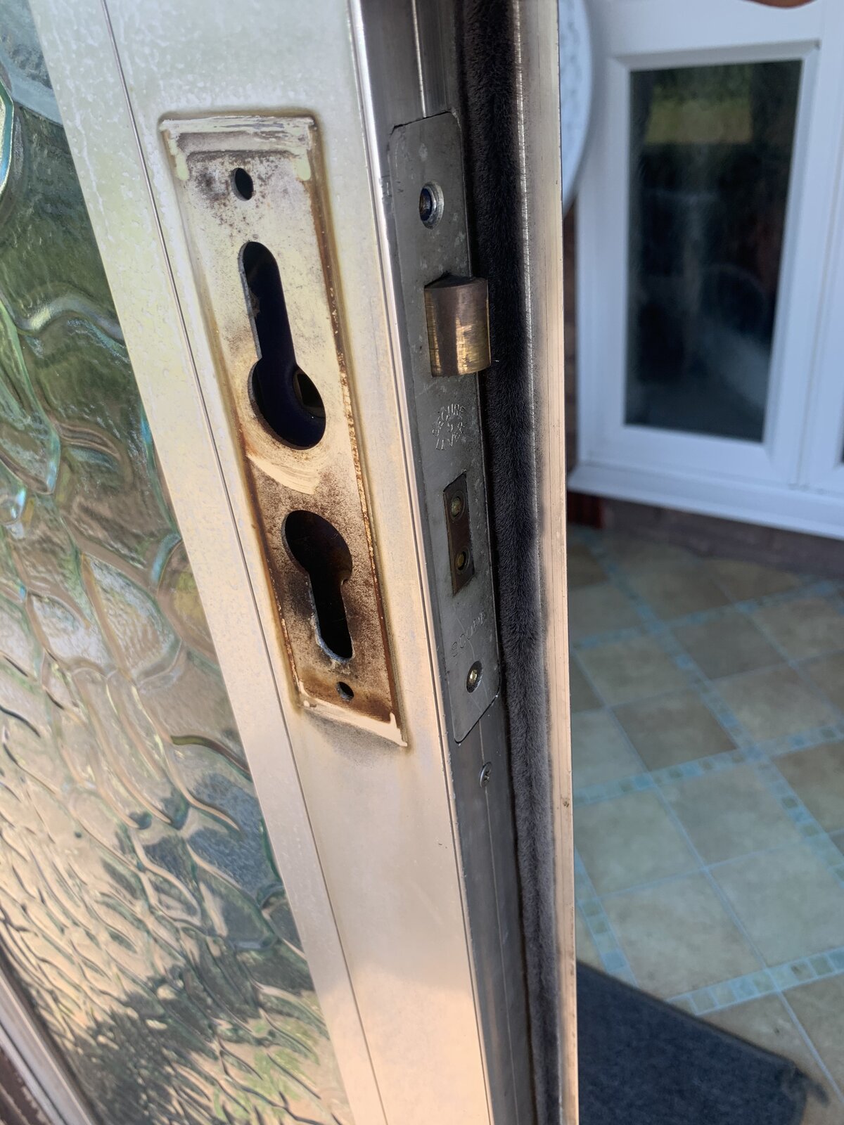

92954A8F-8DA5-414E-A4E6-83307901C71D.jpeg C5ECEAB0-CC9D-4116-BE30-2E8B8D9A104E.jpeg
It’s a 5-lever lock made by Scope. I haven’t got the key with me but will try and get a picture
so it's a 5-lever but not BS3621
Compare it to Willenhall M3 lock, which IIRC is a copy of a Legge design.
Also look at ASEC AS11357

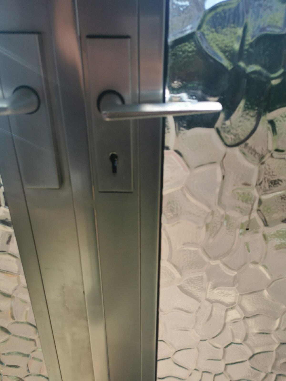

It’s weird the door has hole for Euro cylinder, but would
Need handles that fitted that door
I'm not sure the holes are actually for Eurocylinders.
