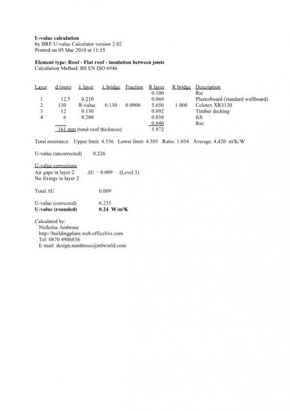

Reflective cavities are essentially free insulation. A vented cavity (above Celotex) has an R value of about 0.47 (actually a wall cavity R value from Proctor's "Reflective Technology" brochure). A sealed cavity (at least 19 mm) between the Celotex and the plasterboard has an R value of about 0.64 (same source). Together, they are like an extra 25 mm of Celotex for free. :)
Using GA3100 with 2 cavities, you get U value of about 0.18 between the joists. This is not bad, considering 250 mm of mineral wool has a U value of about 0.16. 150 mm of mineral wool with a 50 mm non-reflective vented cavity has a U value of about 0.25 but is a LOT cheaper than Celotex. The actual U values will be increased by thermal bridging of the joists but decreased by the other roof/ceiling layers.
