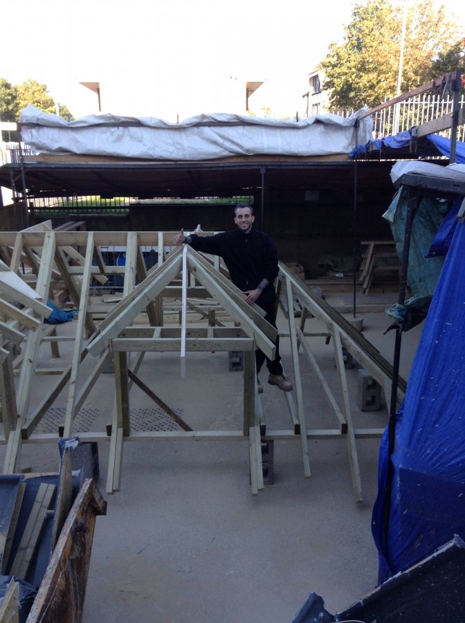

Pic from the course

I didn't even know the hip rafter was a different angle, on the course we pitched a 45 degree roof and the hip angle was about 35 degrees.
