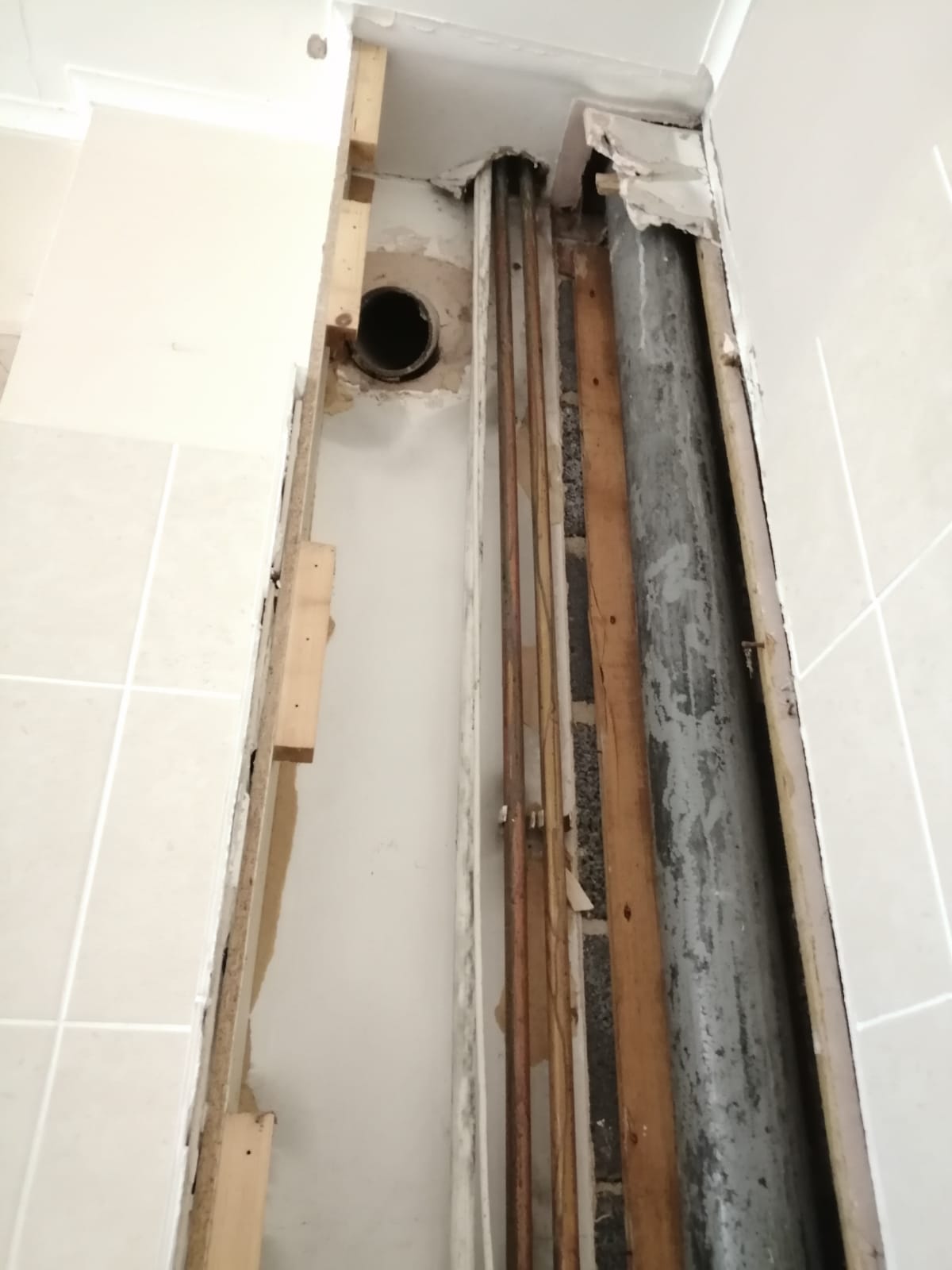

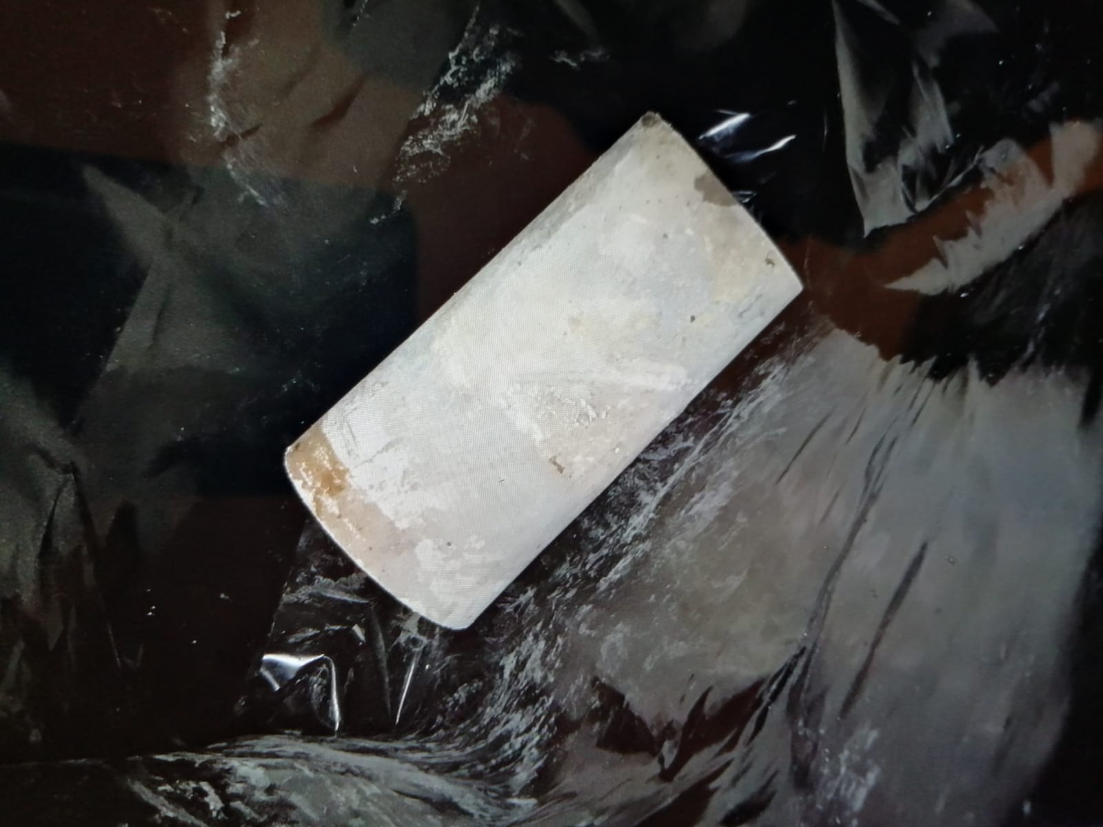

Advice needed! My husband found and removed a small section of pipe from the kitchen wall after removing some boxing where what looks like an old boiler was. He has said it slid out from the wall easily and was fully in tact and in good condition. However I'm just worried about the potential dust or particles that may have been released from doing so. Is there any need to be worried? any advice on what I should do next, is it worth arranging a test to be carried out on the pipe for peace of mind?

It doesn’t look like asbestos, although the picture isn’t the best. Asbestos fibres are generally released when damaged. Have you looked inside, to see if it’s aluminium? Can you apply some slight pressure (using hands with gloves on)to it? If it bends it’s not asbestos.

Impossible to tell from those photos, but if it is asbestos then any dust will have already floated around in the air so it's too late now.
the picture doesnt really show clearly i know. it's definitely not aluminium, its a cement product.

It's an asbestos cement flue pipe and the safest of all asbestos products, if it just slid out then the chance of any fibres being released will be minimal. Use a damp cloth to sweep any dust that came from hole then double bag the pipe and cloth . Local tip may have an asbestos skip for it to go in
Yep there’s not much else it could be to be fair. best practise is as above but spray water on it before removal! Obviously too late now!
