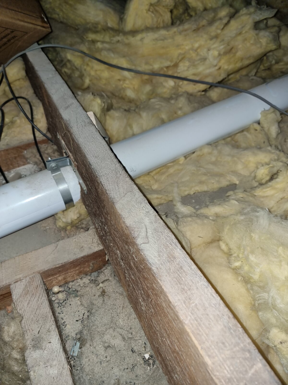

Possible bodged boiler install

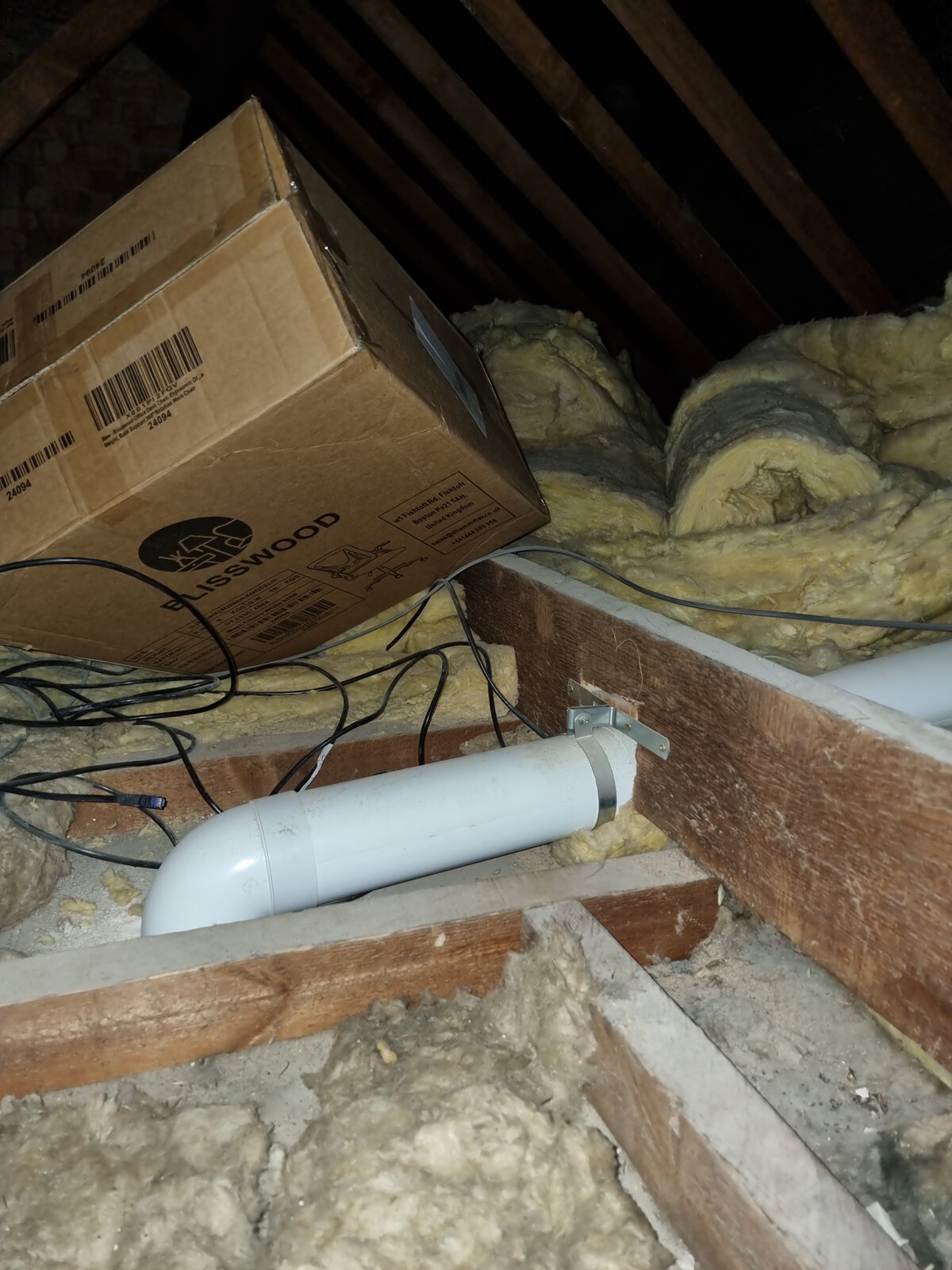

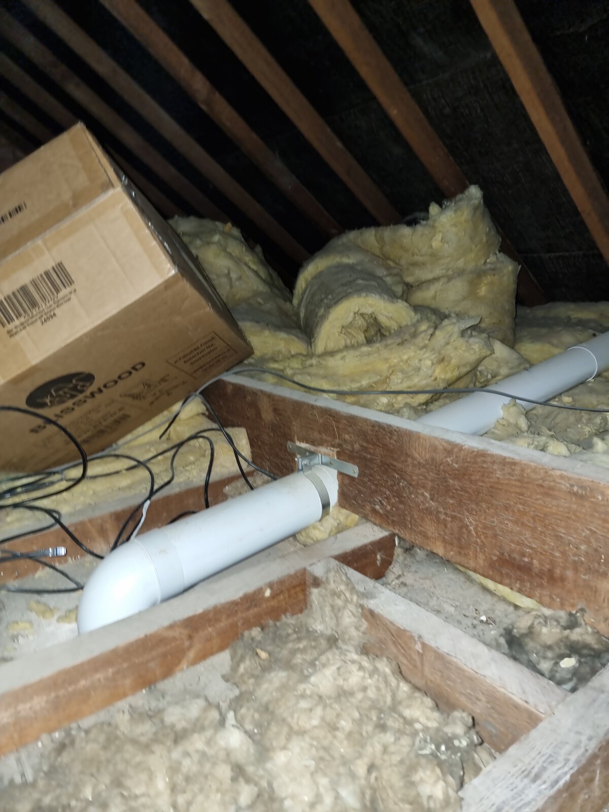

I also have now noticed when taking pictures of the loft, that the joist has been cut significantly for the flue to run horizontally, is this a possible structural issue?
In my judgement, yes, that is a serious structural issue, it weakens the entire ceiling, loft floor. What was he thinking, when he cut through that?

I nearly fell off my chair as well when I saw that "notch", but if the walls of that airing cupboard are structural it's probably not really an issue.

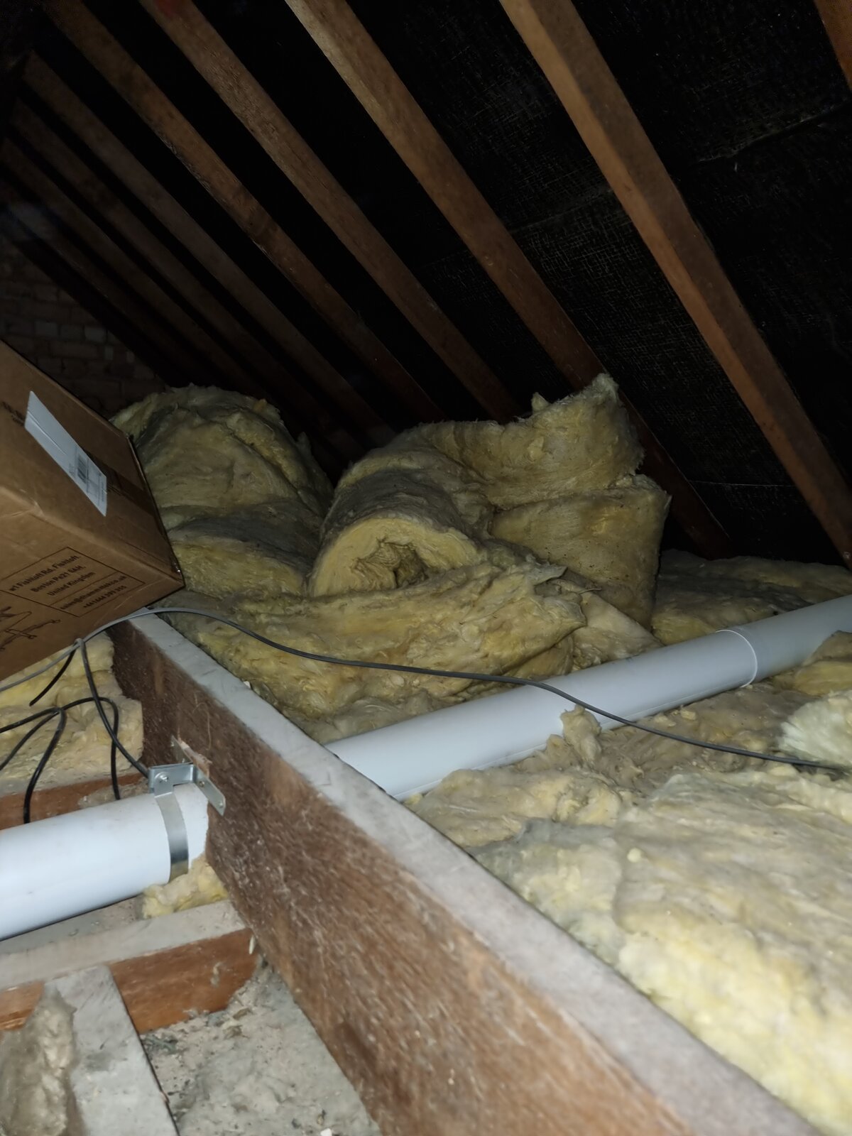

from the pics the flue looks like it does not have the required fall back to the boiler the flue outlet looks a complete bodge . although unorthodox if there is a minimum of 300mm from the bottom of the terminal to the roof then it will usually be acceptable the 300 is for snow etc .
As for cutting the beam wtf was he thinking of.
You can ask gas safe to come out and do an inspection it
The MIs for my boiler flue say it must be fitted level as the fall takes place on the inner pipe internally.
IMO notching the beam like that is the worst thing there by far. Not supposed to notch anything at all from the bottom.
you will find its only on a standard flue that the fall is built in once you start fitting extensions then it isnt
I don't need the extension on mine but I've looked at it and it definitely maintains the fall internally. That said it is an oddball boiler (Intergas) so that might be why !
Yep many do have them built into standard flue as it is a very short length of 60/100 flue but impossible when extensions come into play as is the case with this install

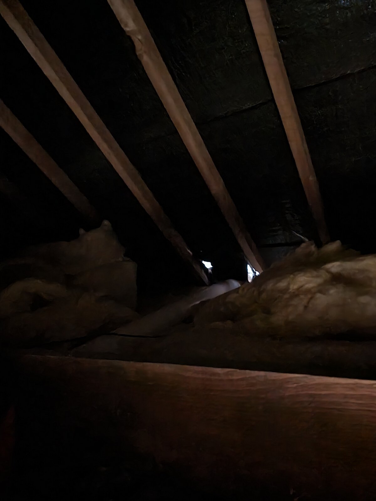

I took some better photos, cleared insulation covering the flue pipe and have cleared most empty boxes in the loft in light of the possible issues with the beam being cut. There does appear to be a slight incline in the pipe down towards the boiler, but this is only until the joint where it meets the cut timber beam.

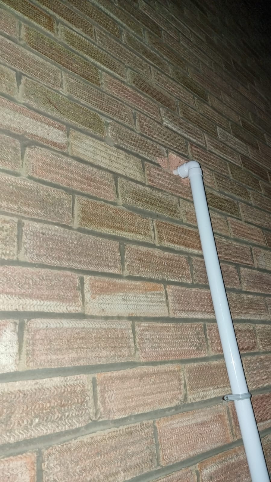

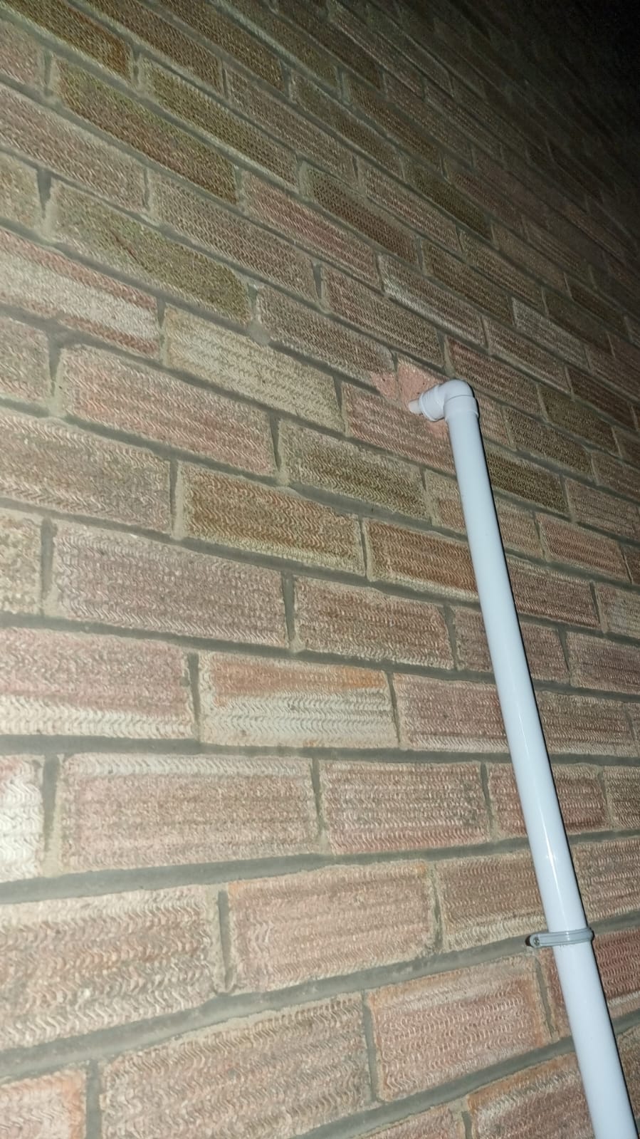

3. They installed the condensate pipe, blew the brick, and failed to fill in around the pipe outside.

8. As part of my insurance a different / third-party attended to service the boiler the same day 30/5/2024, as above / health check and this is when he raised the issue with the flue. It is only when taking a look for myself I noticed the big cut in the roof beam.
9. I also noticed today there is daylight where the pipe exists from, it's too far to see if water ingress has occured. Perhaps I need a bright torch.
If that condensate pipe runs externally the that’s been done wrong too, as they’re now supposed to be lagged or prevention against freezing conditions.
