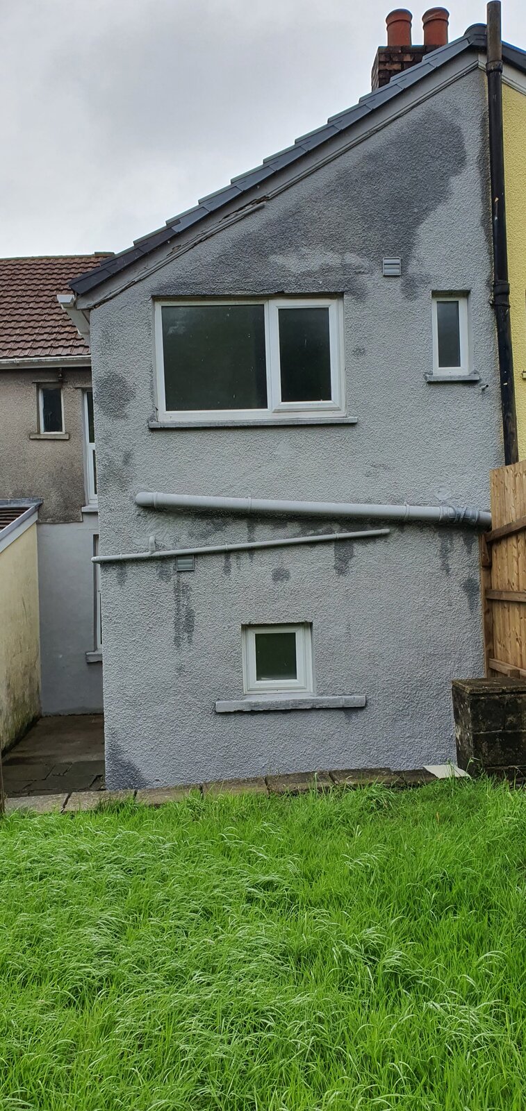

I'm looking at a property to purchase but very concerned about the damp patches on the rear wall (is it penetrating damp) of what I believe is a fairly new extension. I'm far from an expert but it doesn't look good to me and I don't want to fork out more money on bad surveys etc etc. I can obviously see that fascia boards need replacing but I wonder whether someone would offer some advice please ? Picture attached

I would suggest forking out for a good survey. It will most likely allow you to negotiate and cover the survey
Costs and any remedial works
Penetrating damp would be damp on the inside. If it's a cavity wall the idea is that the external half (leaf) can get as wet as you like, but it can't hop over to the internal leaf if it has been done right.
At the moment that photo just shows some water marks on an external wall.
Interesting pattern of stains.
It makes me think of heavy rain blowing off the end of the roof in a storm and running down the gable end.
Is it in a coastal or exposed position?
Have you looked at the wall in dry weather?
Is that the East wall?

Surely the whole point of a survey would be to tell you about defects like this and whether the property is worth buying?

According to this guy who seems to be knowledgeable it may be down to simply condensation - he really explains it all.
https://www.heritage-house.org/damp-and-condensation/managing-damp-in-old-buildings.html
