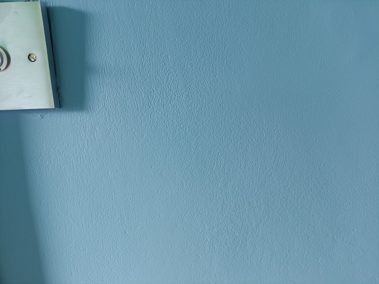

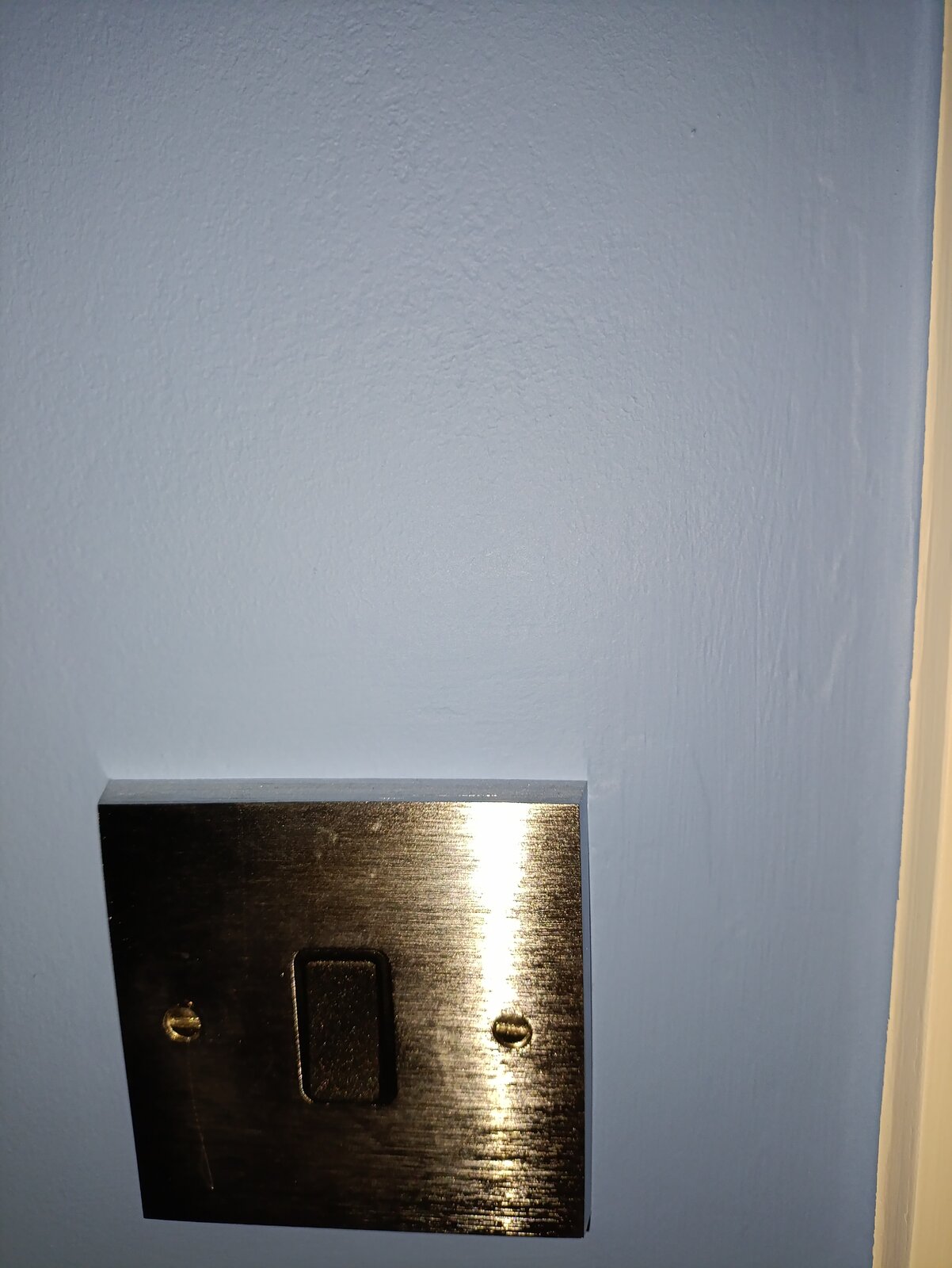

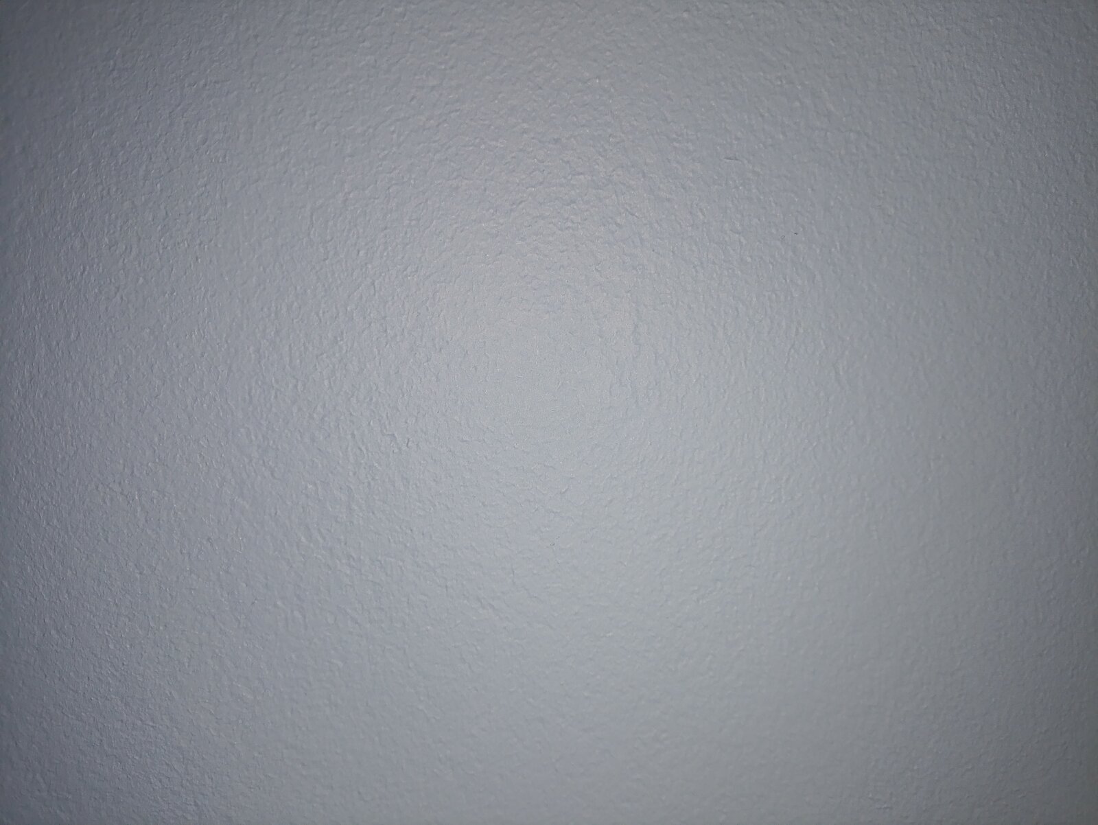

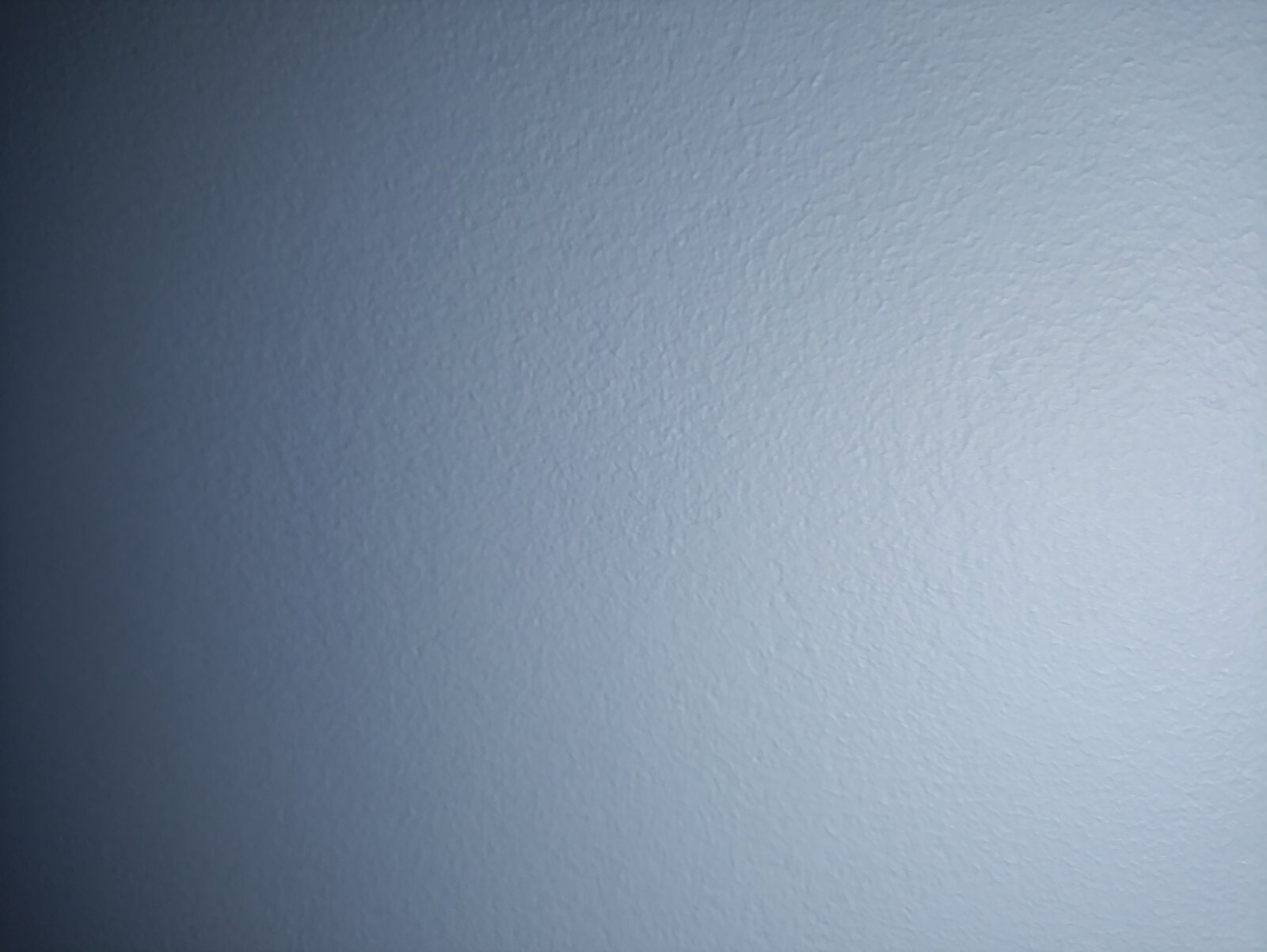

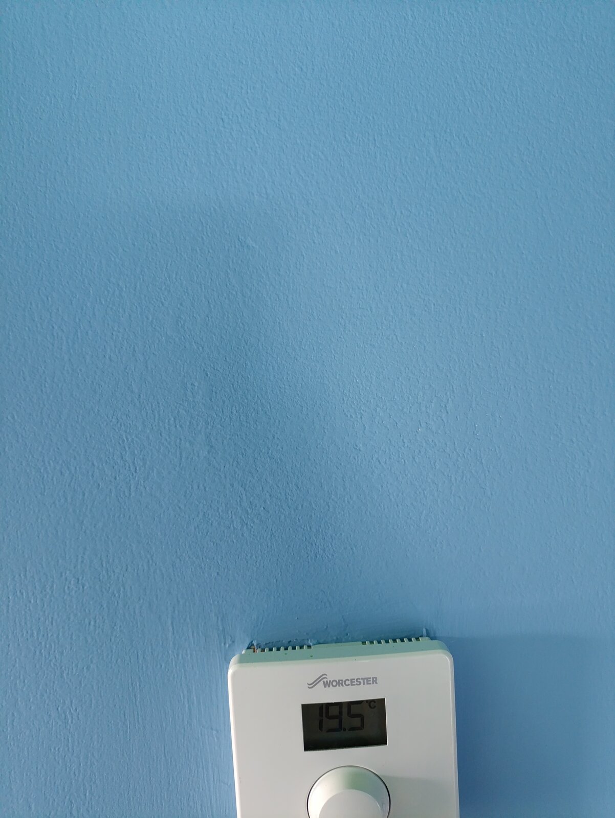

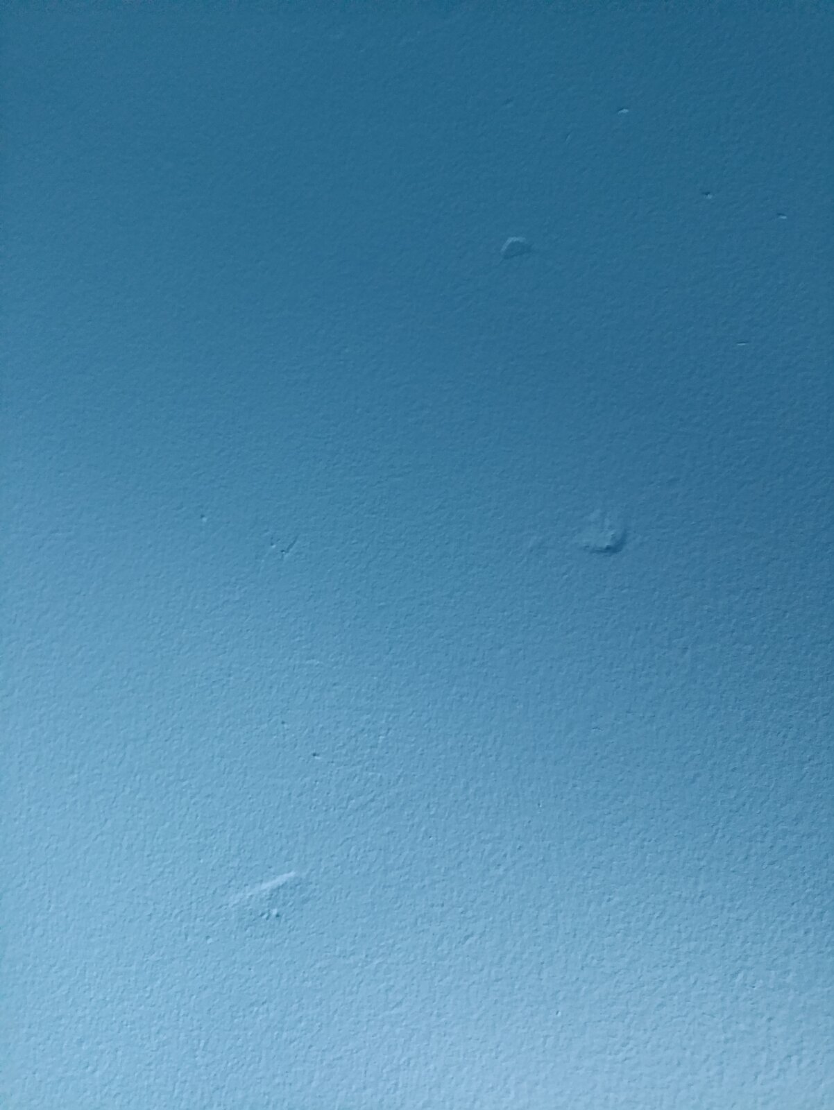

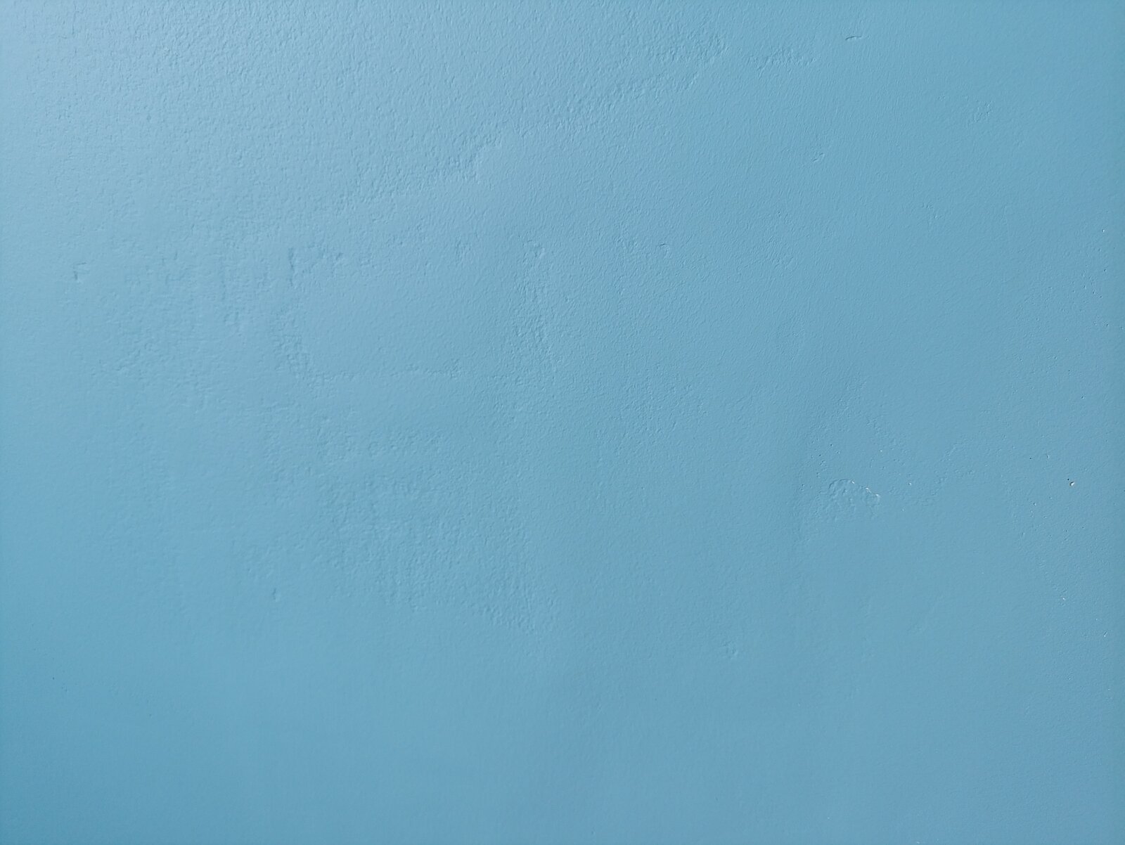

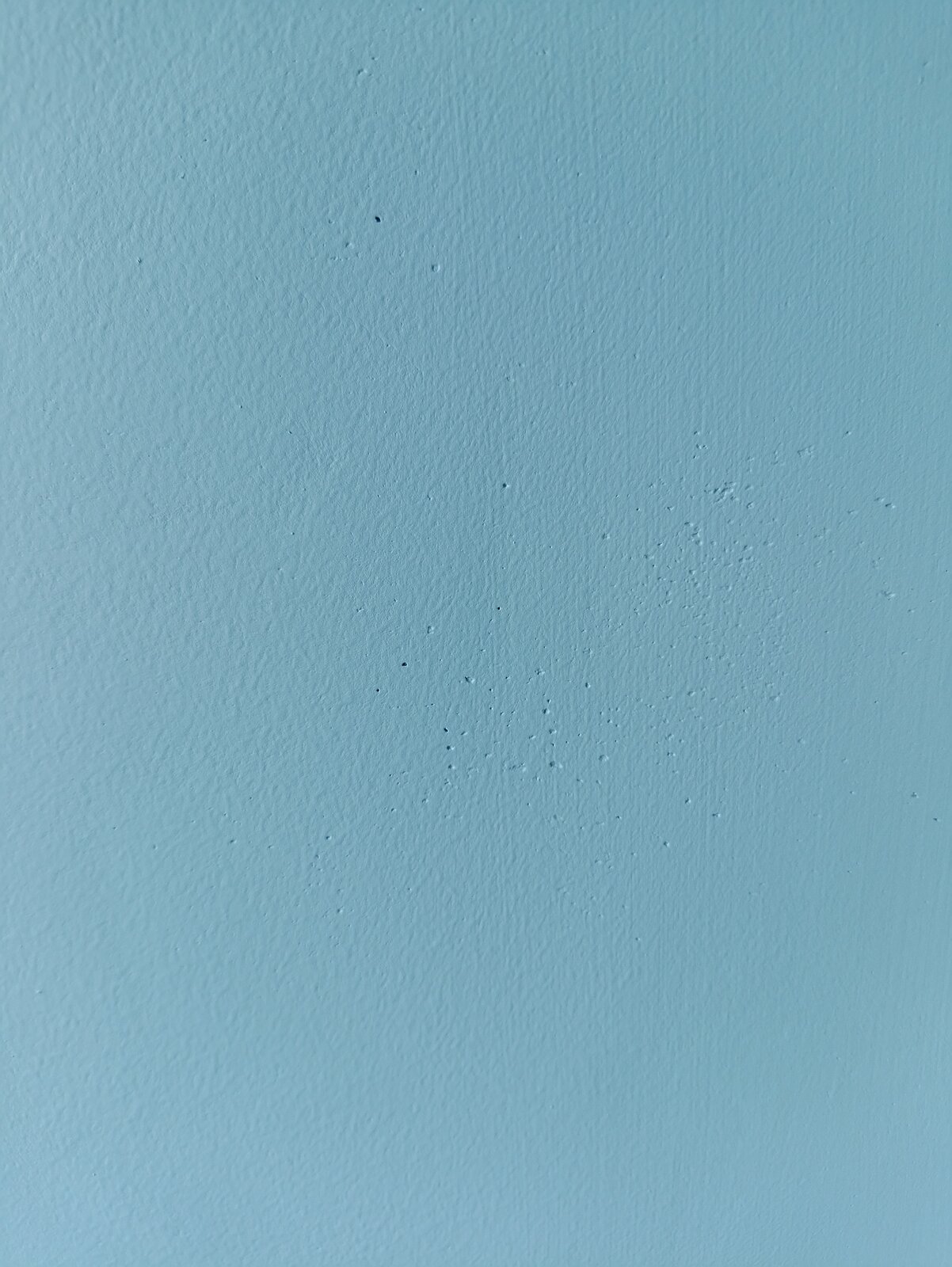

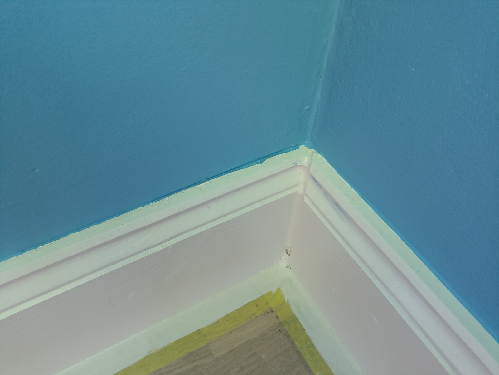

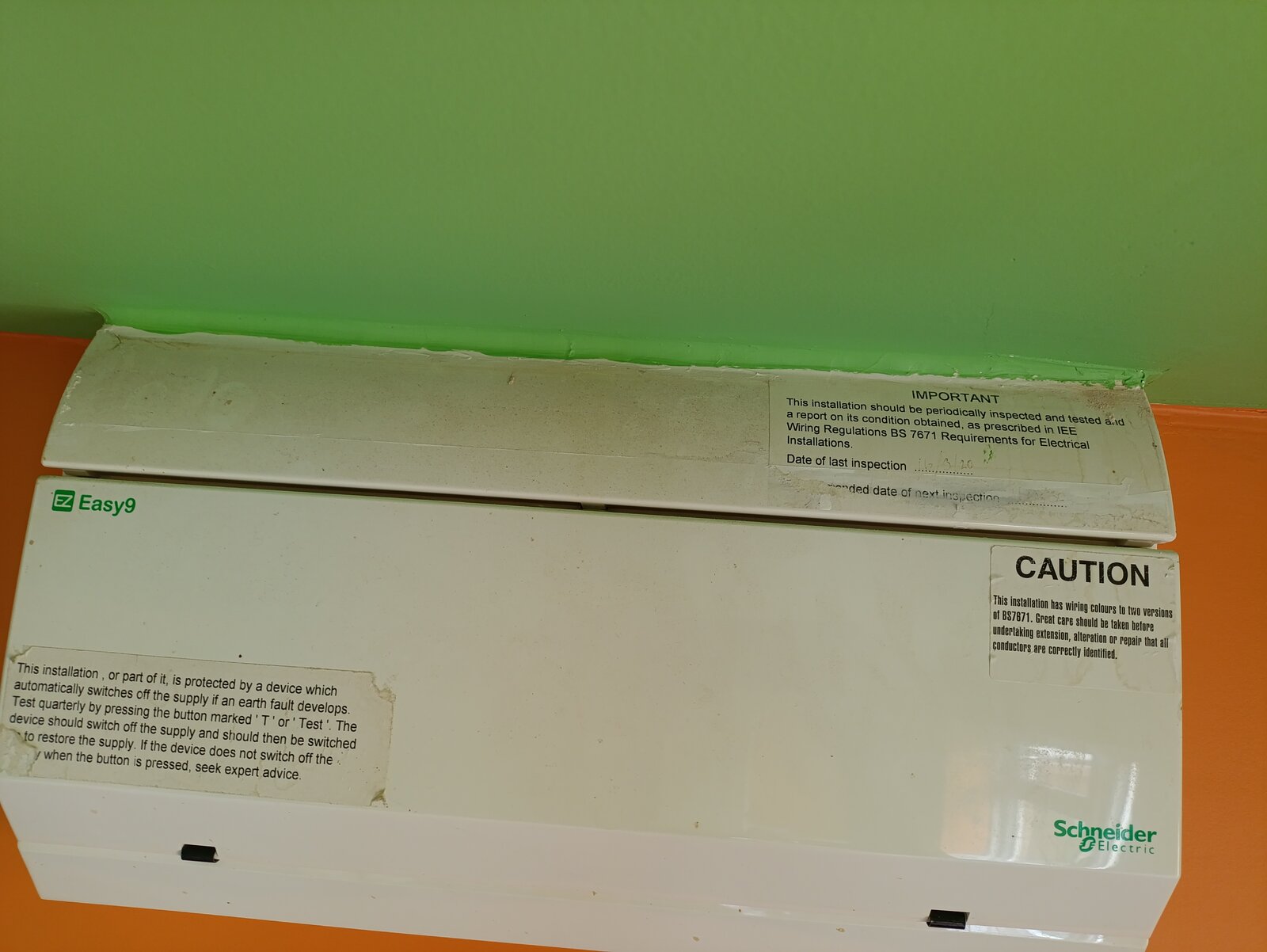

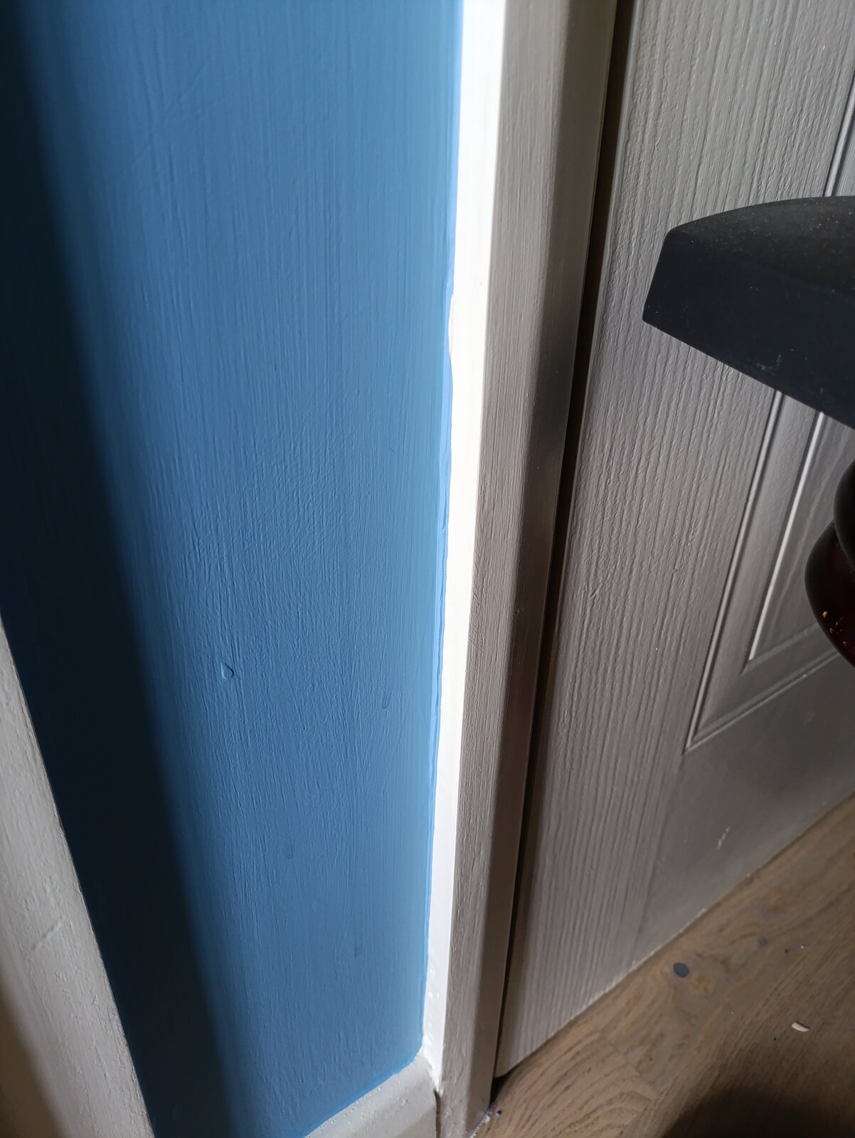

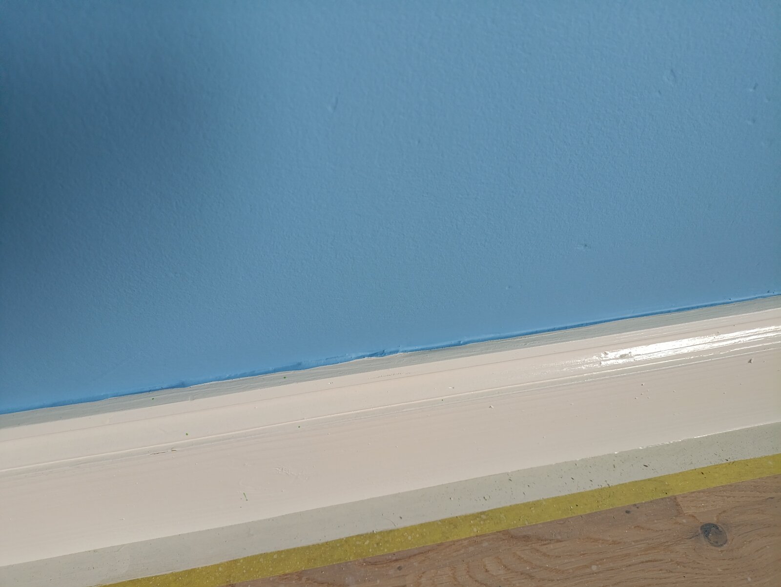

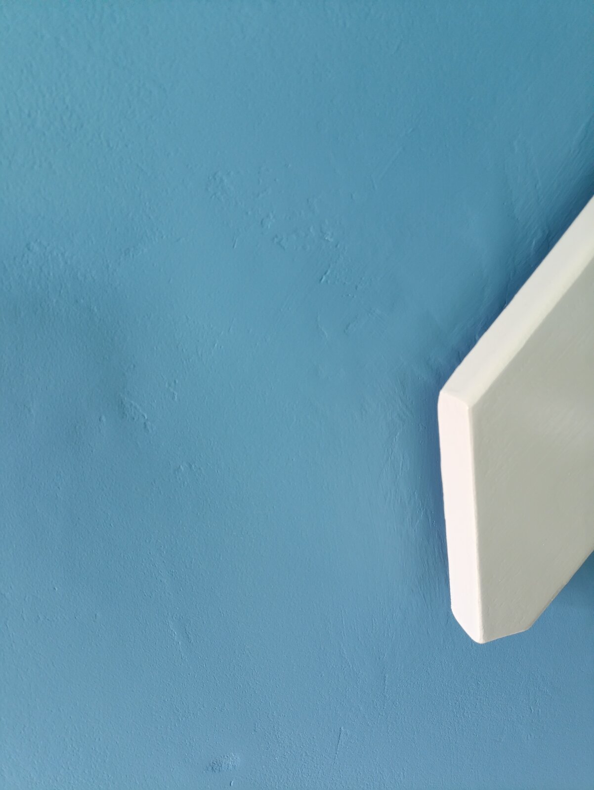

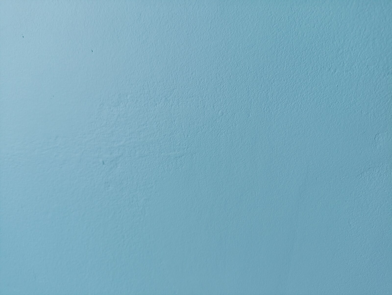

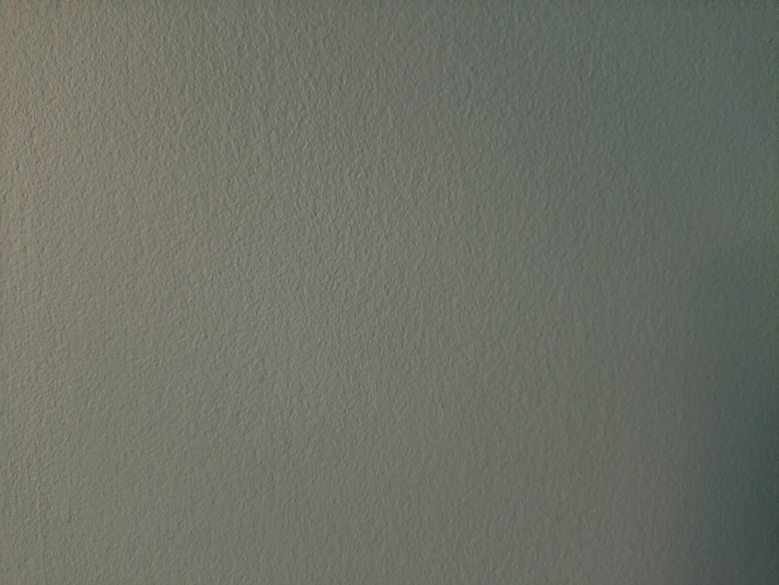

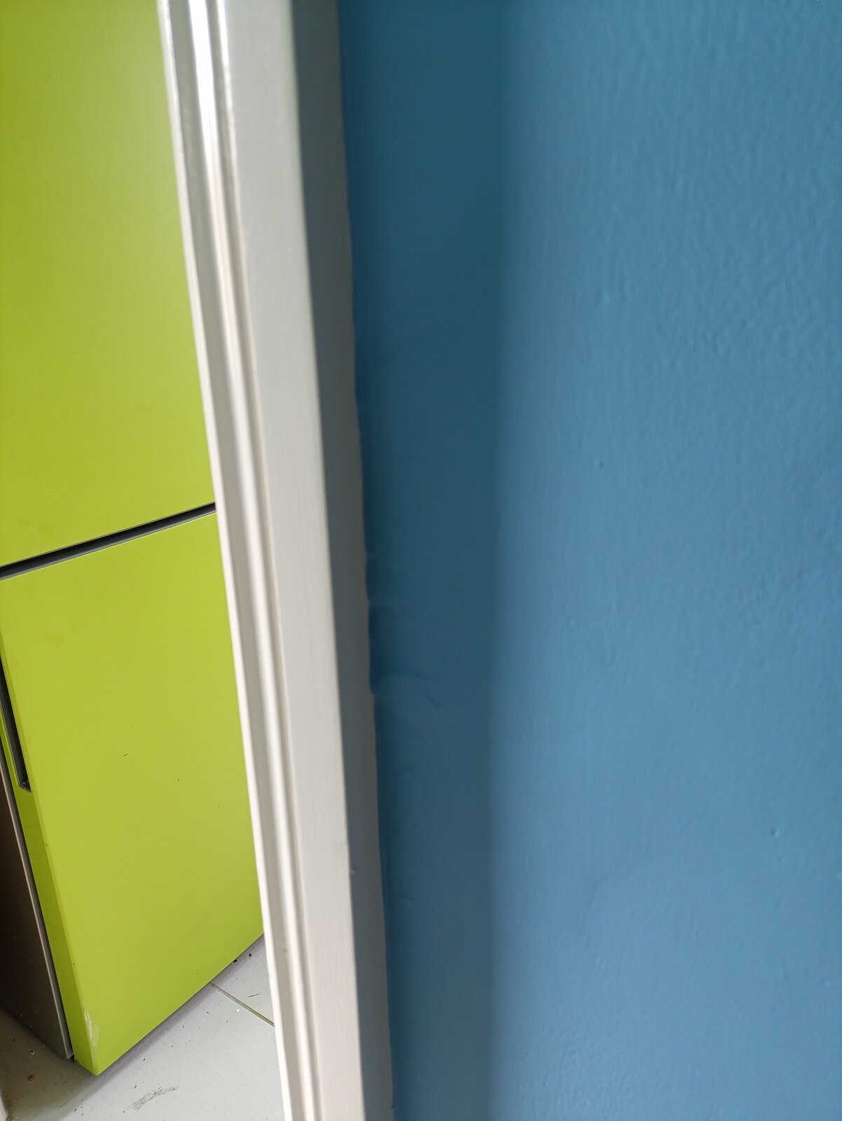

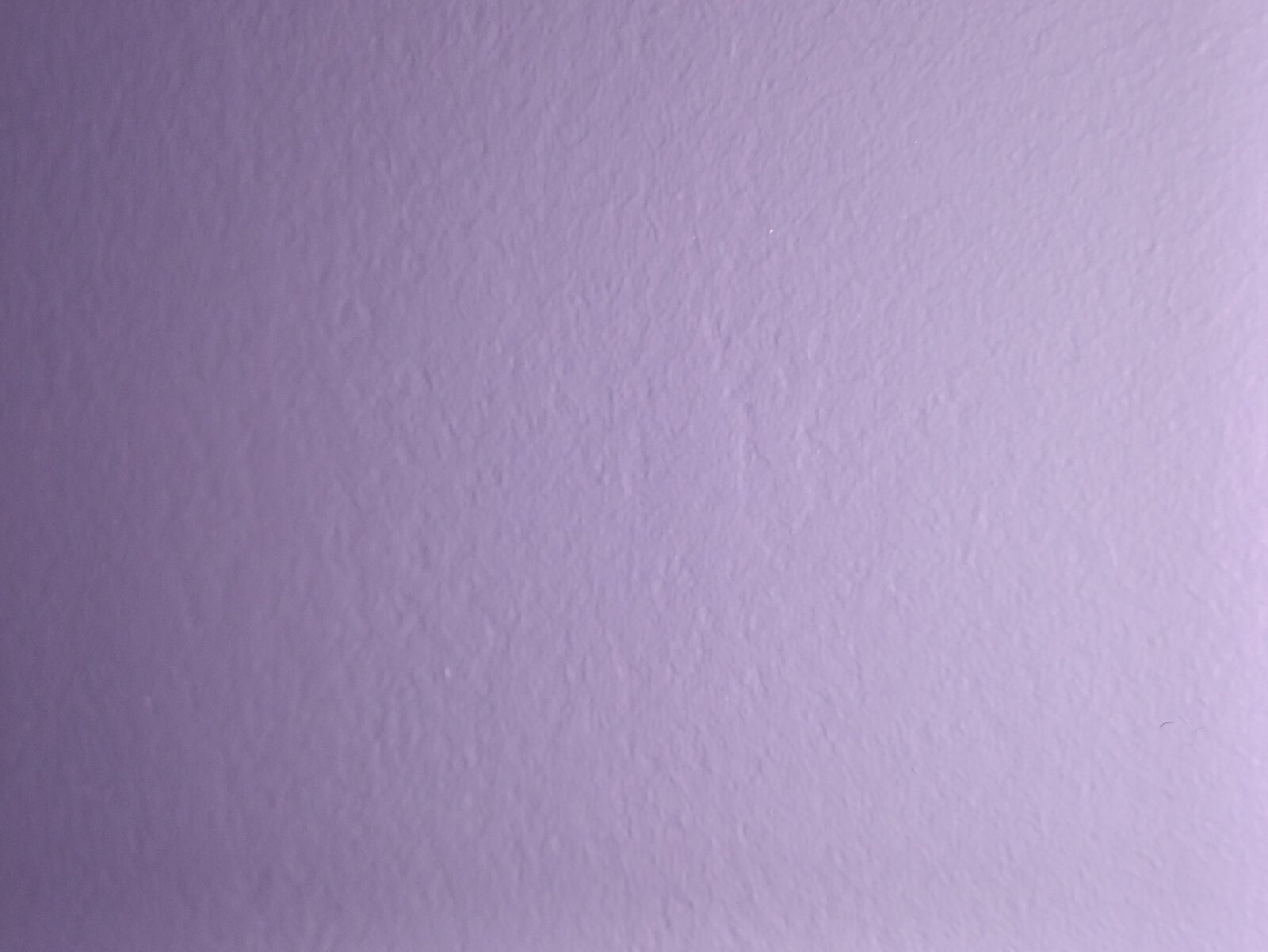

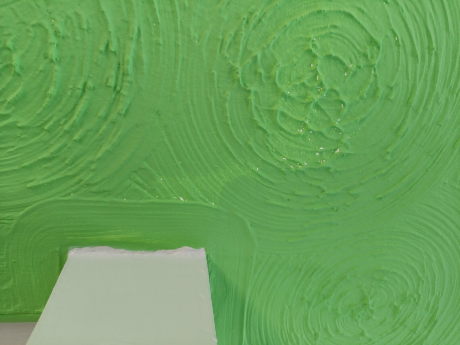

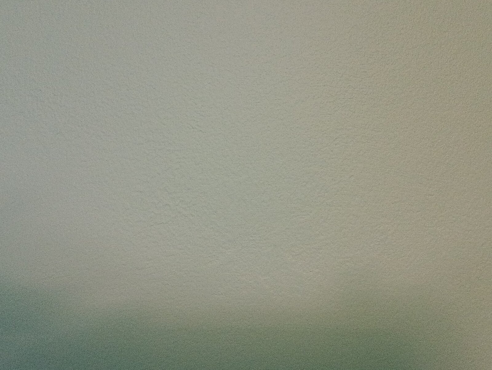

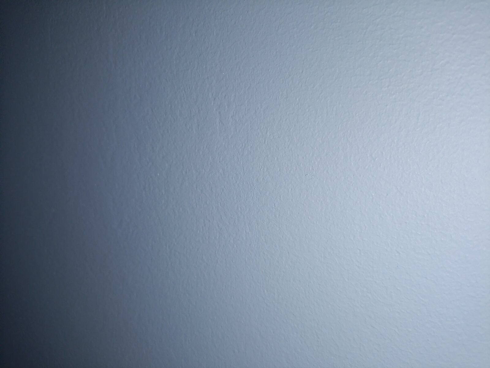

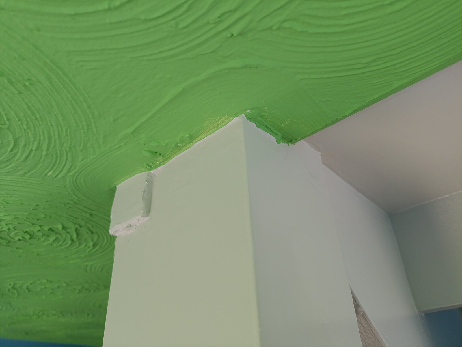

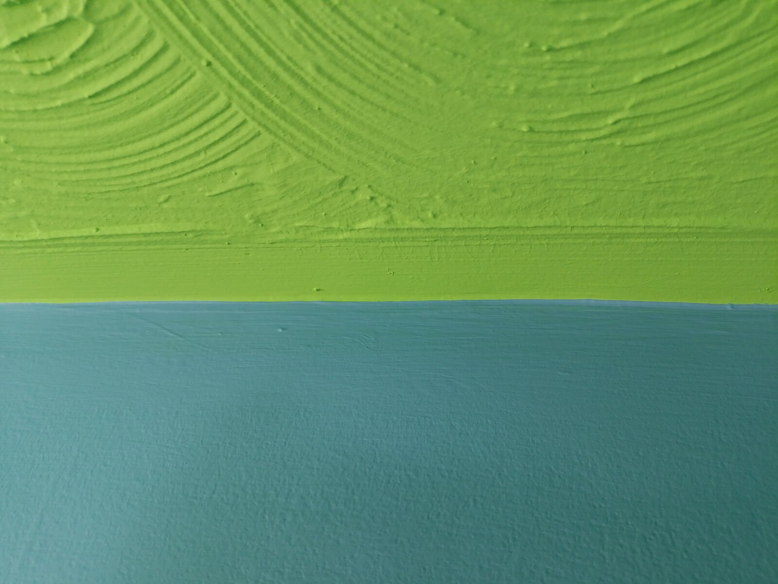

Hi all, advice would be really appreciated.
We have a decorator here at the moment and he has charged loads of money so far and as it was an estimate (7.1k)for a 2 bedroom small house, has no hallway, just a front room, kitchen, small bathroom, upstairs landing and 2 airing cupboards and a staircase to paint and has said now on top of the 5 weeks he has taken it will be another 2 and will offer us 50% off and charge 1350 to finish the job, but we are concerned about his work after talking with a neighbour.
In the first bedroom he did all sanding ect then the paint all came off the walls as it had never been primed he said when house was built so he spent a couple of days then removing it all, then lined it all with lining paper which took him about 6 days total work, then painted and the room looks lovely, the paint is all flat and smooth.
Then doing the other rooms he said to try to avoid us any extra costs he would try to ensure not much more paint came off and filled and sanded ect as expected, but not sure if he sanded all of the walls where there wasn't filler or not. The walls do not feel flat and smooth, instead they feel all bumpy and rough to the touch with lots of obvious bits lumps and bumps all around.
I asked him about it and he said there is nothing you can do because it's how the wall is, but talking with a neighbour I am concerned now he has done a bad job, I took the pictures when the rooms were dark so sorry about that and the walls are tivoli blue little green intelligent paint ie top quality (he provided it)

Have attached a few more pictures now it's sunnier so you can see better

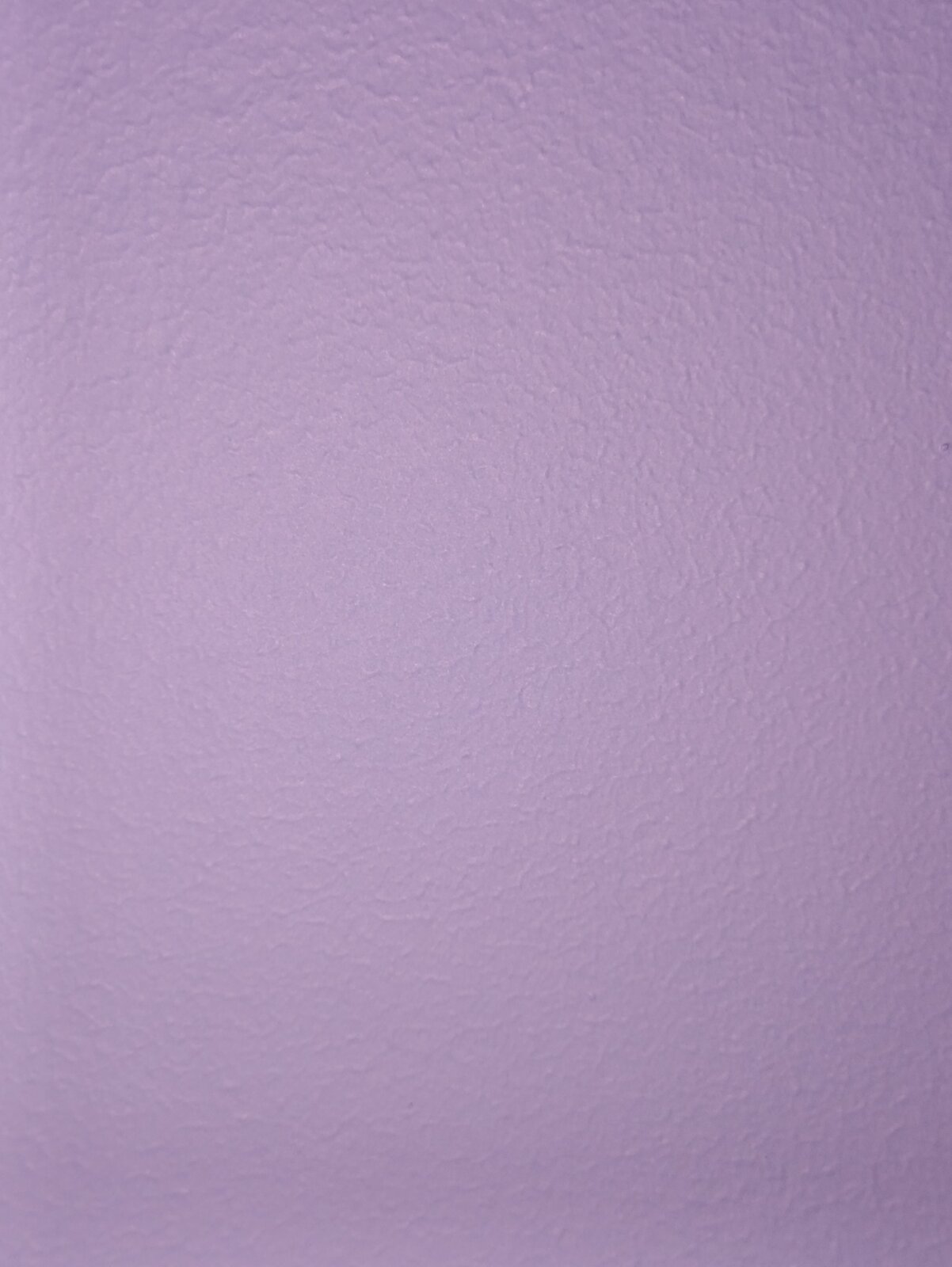

6 days to line one room? It should take about 1 day.

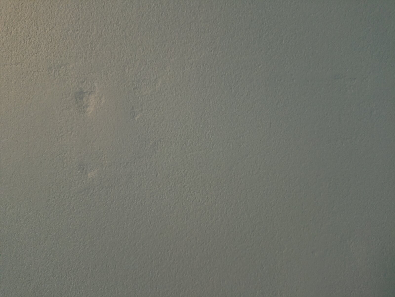

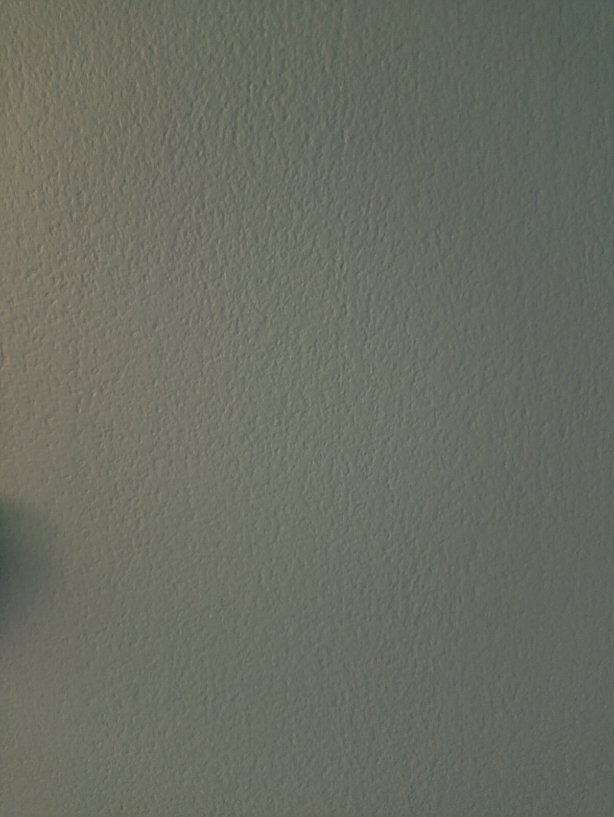

If the existing walls have really heavy orange peel (paint build up), I normally recommend lining them, however, before lining, I thoroughly sand the walls first, filling as required.
In your images, a decent random orbital sander should have been able to smooth the walls.

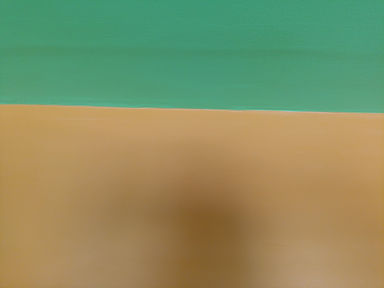

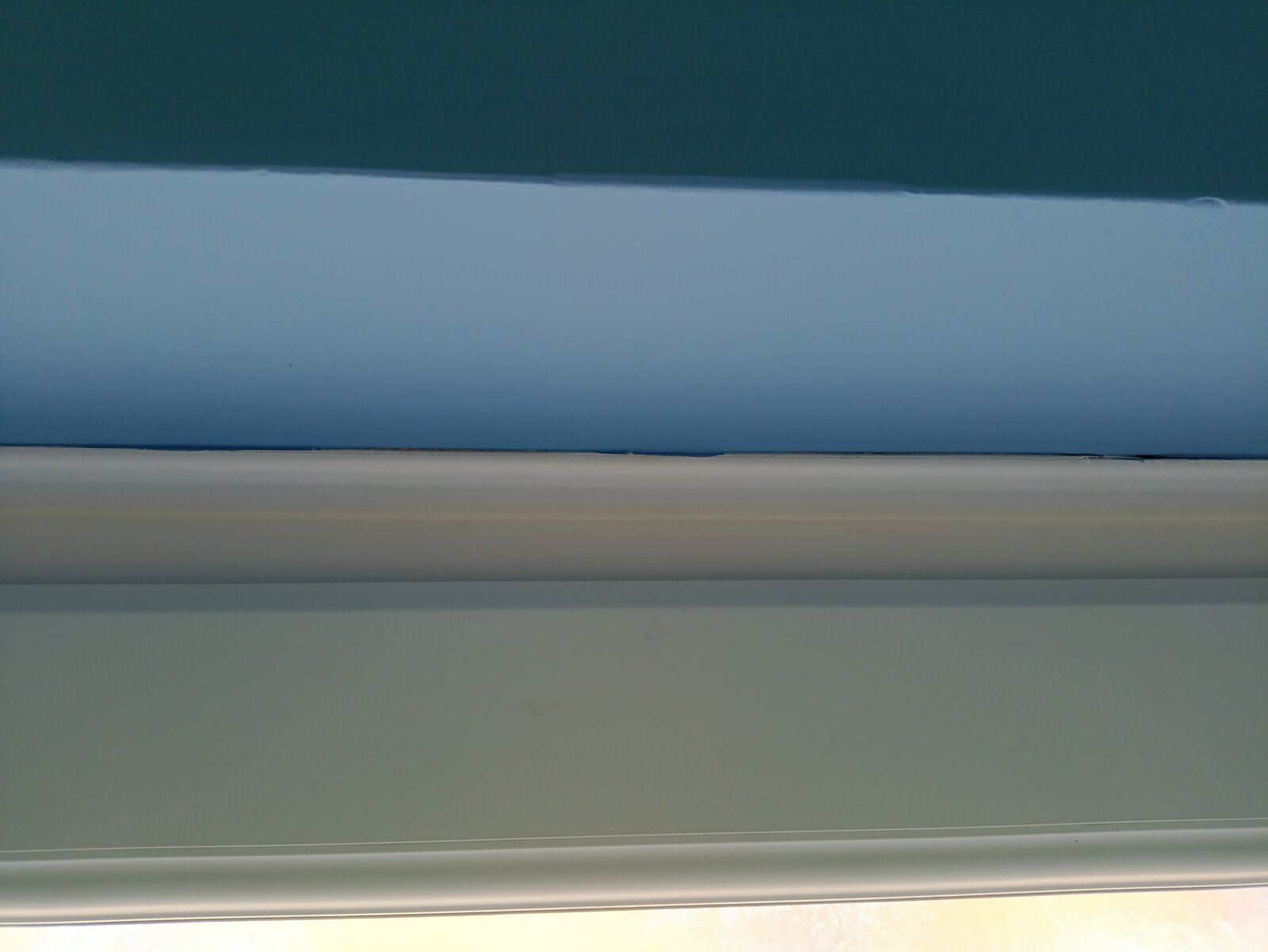

Based in London, I charge about £1000 for largish room, but I aim to provide a much higher quality of finish. Where are you based? Photos of the cutting in would be useful- granted you showed one, and frankly, it wasn't very good.
Based on what I have seen, I would not recommend him...

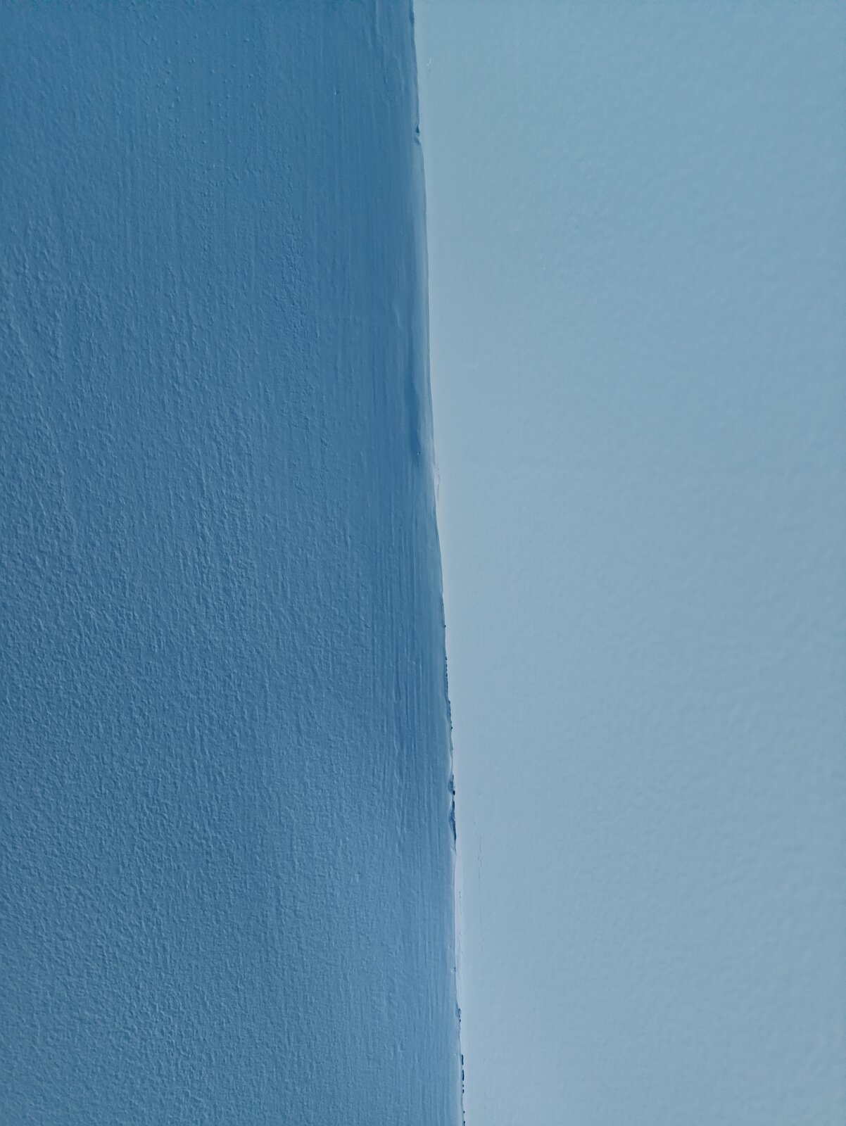

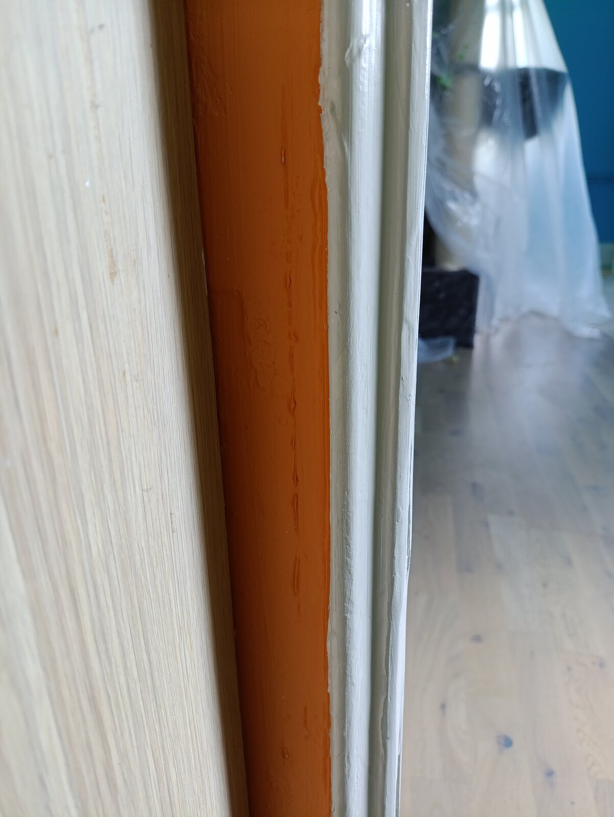

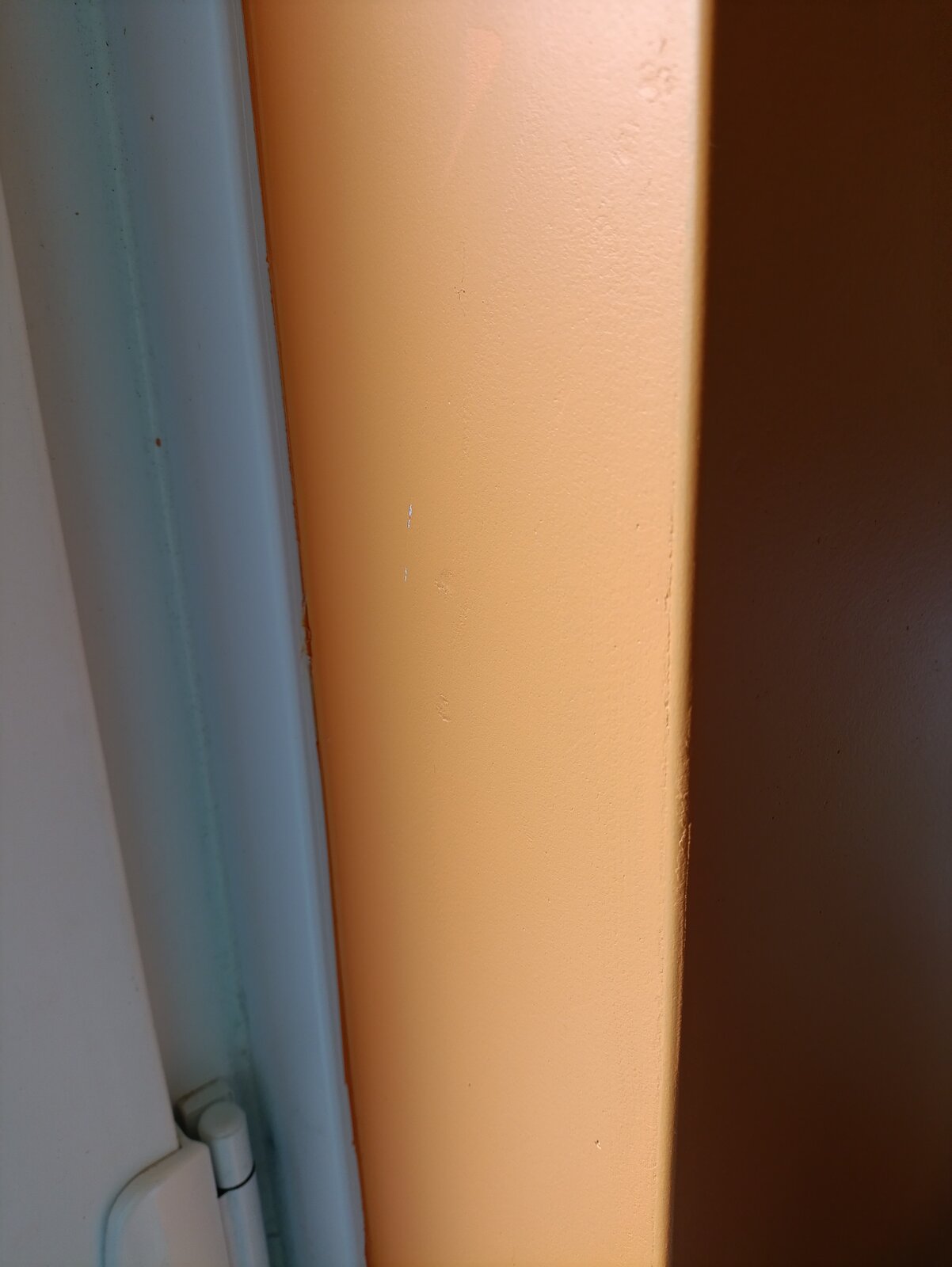

Cutting in pictures, these are all areas he has totally finished doing except any errors that we point out to him he said he will make right.
Unfortunately we are in Boston Lincolnshire and he was the most expensive decorator by Miles with a dust less sander system and nvqs in painting, been painting for over 20 years and he says he's got ocd and hes a perfectionist and everything will be totally perfect ect.
He spent 3 days in first room filling and sanding ect, then he noticed the paint was peeling away and loose on the wall so he removed it all then lined ect and that room looks totally perfect, flat walls and really professional, but then he said it's going to be loads of extra money because it was only an estimate so he will need to charge lots more because so much work to do and he was saying he needs to be finished ASAP because he has external work to do.
Friday he took all of his tools and left only the paint trays and paint here and said he would charge us £2750 extra because the house was so long to do but as we have limited income he's happy to sette for 1350, paying him 300 cash a month until it's done and that the house is finished except for a couple of cupboards, the stairs and any imperfections we find and he's been off all week with a bad back with all of his tools.
He was expecting to come round today for the first £300 and said he would do what is left when his back heals, but we are worried he won't ever give us a good finish, already paid him the 7100.

I suspect that he has taken his tools because he is worried that you might keep them as leverage.
That work is awful. Sorry.

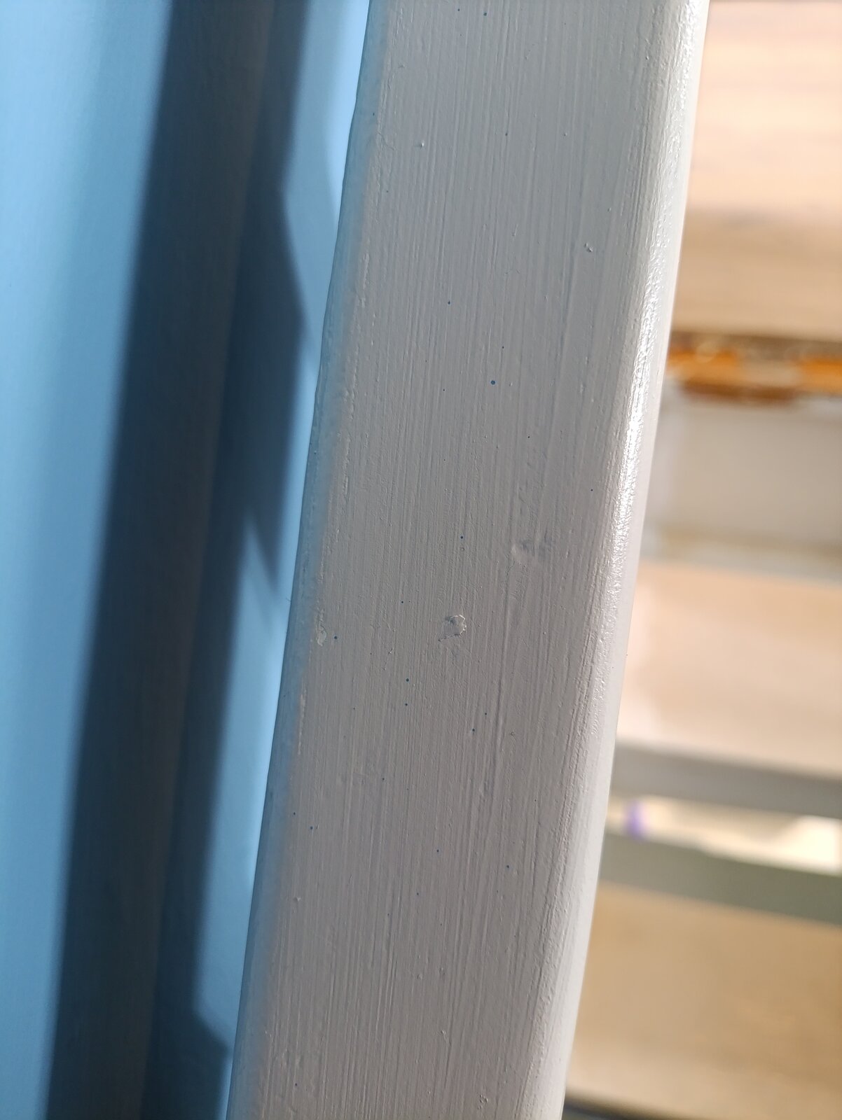

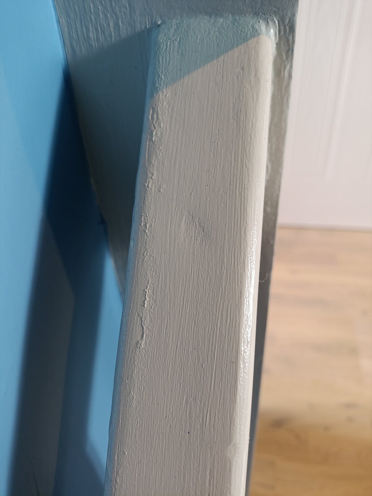

IMG_20240606_124619.jpg Why isn't the paint work flat? Why is there grit in the finish?
I can only advise that you get quotes to rectify his work and then consider going through the small claims court.

Im not sure why its not flat and also why there is grit in it, we have told him we are not happy with it and he is going to come tommorow to look it over and said he will sort it all out, so will see what happens and go from there, thanks a lot for your help
Only two of the images of the cutting in look acceptable (IMO).
Perfectionist? I am always sceptical when a tradesman comes out with that line. A perfectionist should know that perfection is unattainable. I have never walked away from a job and thought that my finish is perfect. I have to set practical benchmarks- I walk away thinking "yeah it looks good- and better than a finish provided by most other tradesmen (at the price point)", but never perfect.
All of my powered sanders are connected to dust extractors (read: vacuum cleaners), I even have Mirka hand sanders that are connected to my dust extractors. I am glad that your fellow had dust extraction, but these days, that should be a given, but unfortunately it isn't.
With regards to paint peeling off- probably not his fault- it is often down to the previously applied pain not having been sufficiently thinned over the plaster.
Given your location, the prices you are paying sound very high.

Sanding alone may not be enough to give a smooth surface but this needs to be sorted early on.
Sanding. Wall smoother. Lining paper or get it skimmed.

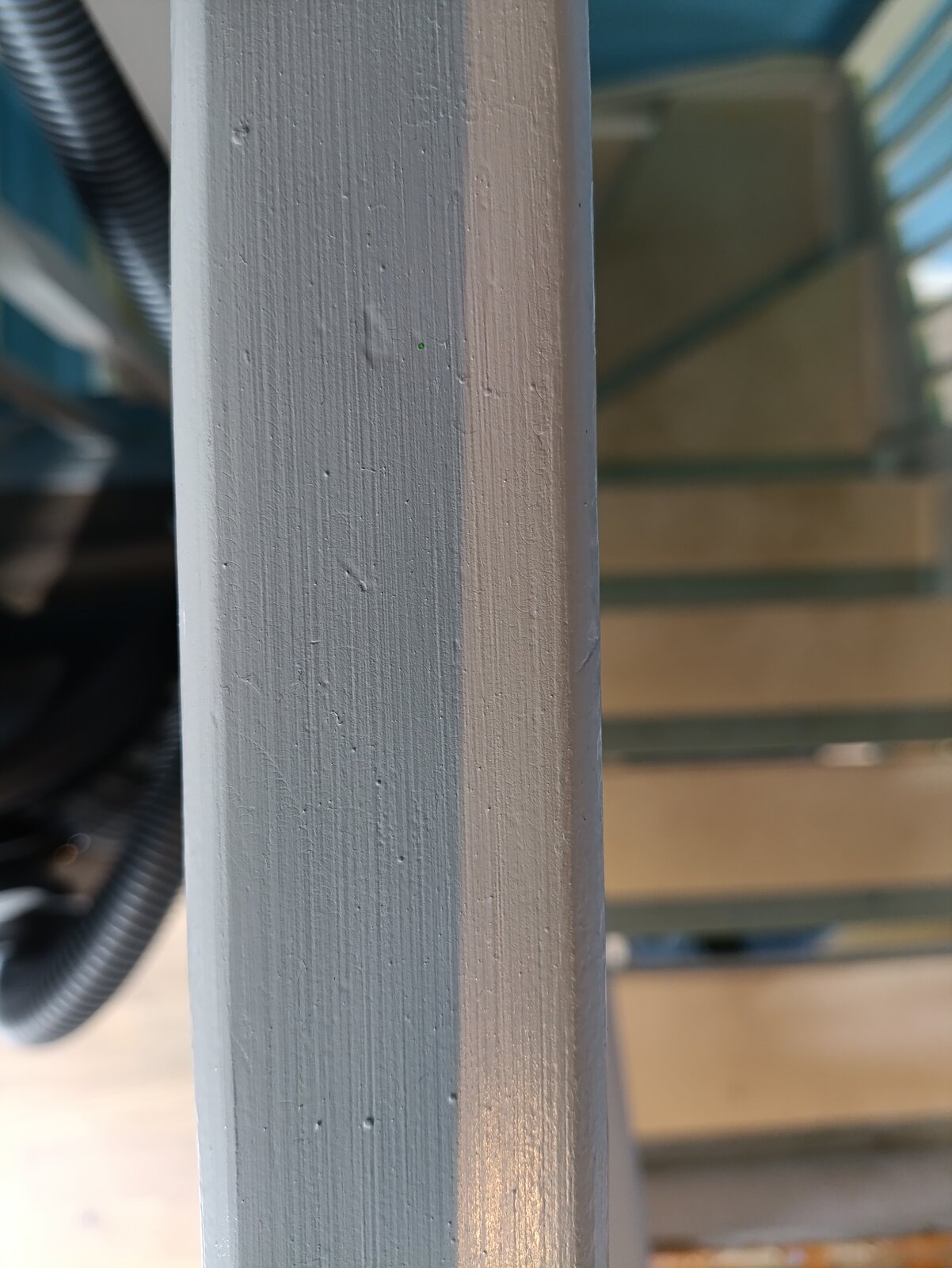

Theres also obvious grit in the banister too on stairs like there is in the walls and other woodwork. It just seems to us with the grit in all the paint, even the perfect looking ones in the bedroom plus the lack of lining and sanding of the bad previous paint is going to mean starting from scratch again :(

Also we never saw him washing any surfaces. The woodwork was sand, then coat with a coat of the little greene wood paint, followed by another coat a day or 2 later, the walls were filling, sanding mainly on the filler, then paint, 2 hours later paint 1 more coat, except the kitchen which he said needed extra coats
