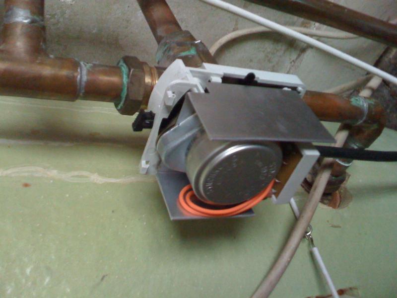

Hi all
First post - and very new to reading up on CH systems/problems!
About a month ago, I noticed that my boiler wasn't burning (although the pilot was on) when I put the hot water/heating on. It's a Glow-worm back boiler, installed behind a gas fire. After reading the manual, I checked the boiler and noticed that the main switch (with off, pilot/ignite, and burn) had moved somehow back to pilot/ignite. Once I moved it round to burn, everything seemed to go back to normal.
A week or so ago though, I noticed the boiler wasn't burning again, with the controls on. This time, the switch was on the burn setting so nothing I could do there. I even tried turning it off and then re-igniting. Still no burn.
I then read up on a few things here and shifted my focus to the pump (a Grundfos model) by my hot water tank upstairs. I unscrewed the big screw on the front and tried turning the spindle inside - all seemed ok. Did it all back up and nothing had changed.
I then turned to the mid-position valve (ACL Lifestyle model) and noticed that the indicator on the side was seemingly stuck on 'W'. It did allow movement towards the middle but it bounced right back to 'W'. We do have hot water so that makes sense but the radiators are always cold. The boiler burns if we need hot water but not with just the heating on (and the indicator stays on 'W').
I tried taking the front case of the valve off and checking the motor. The spindle turns ok although I wasn't sure if it was as easy as it should be. I sprayed a little WD40 on it and put it all back together again. No real difference.
However, I also pressed the larger black lever on the top of the valve. This seemed to click into a fixed position (down) and then the indicator on the side moved to 'M' (again, quite fixed in position. It moves slightly towards 'H' but bounces back to 'M' and doesn't move towards 'W' at all).
The main result here is that both the hot water and the radiators work normally now - both on at the same time. However, I'm not sure I've done anything permanent and may have just 'bodged' a fix. What does the bigger lever on the valve do? Just need a bit of advice before calling my boiler guy out (for possibly no reason but I would like him to check the system over).
Any input would be much appreciated.
sounds like the motor has failed in the valve actuator.
the lever on the end thats on a spring can be moved into the m position and will give heating/hw when hw called for.
the lever is a means of putting the valve in mid position when filling the system or draining the system.

I did have the motor pictured out and the little spindle on the rear of it (the opposite side from that shown above) does move round, and you can hear the whirring as you do that, so I assume it's ok, but I have no frame of reference.

Been a while since I did anything on this but problem continues. Since my last post, I've replaced the motor in the valve with a new one but I don't think anything has changed. The 'H, M, W' indicator needle still doesn't move to 'H' when I put just the heating on although, perhaps strangely, if it's already in the M position, I can push the manual lever over a small amount and the motor then seems to kick in and move it all the rest of the way to H.
If I have just the CH on, it seems to lock in the 'W' position - the manual lever then doesn't move at all.
Maybe I didn't fit the motor right? I wasn't 100% on where the manual lever is meant to be when fitting the new motor. The motor packaging said move it over 'to the left', fit the motor, then check for manual movement by moving it over to the right and releasing. That's what I've done but something's still not right.

The large black lever moves the moter to manual/auto. Putting it into manual will give you both heating & hot water at the same time. Not very efficient. It shounds like the motor has stiffened up (i've changed a few of these recently due to the same problem) I would change the valve, job sorted. Check the colour or the water and inside the valve itself when removed. (If it's jet black the chances are you will need to flush the system out as this is what will have more than likely caused the problem. If it is dirty water and you don't flush then you pay for another valve that will knacker up again in no time at all.)

Sorry - that's my pic. If you turn that pic 90 degrees clockwise, it'll be like it is in reality. The narrow pointy part of the motor is pointing up.
