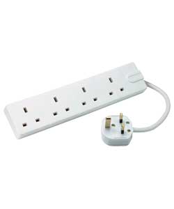

I have been asked to look at some electical issues in my new partners house ( more investigate than cure!!)
first one- bedroom
there seems to be only 2 double sockets in the master bedroom- neither in a usual place. So one socket has a 4way going to the other part of the room, it also has a plug but with flat twin and earth which i presume runs to another socket.
so this leads to 2 questions:
1) why run twin and earth to a socket - would it not be safer to run a 4way extention?
2) could I run a spur of this socket? I seem to remember (years ago) that you could run a spur (single socket?) of a double socket is this still the case ? if so is it per socket on a ring or just one spur per ring?

First question:
I don't really know you mean. There's a 4 way extension lead:
with t+e connected to it which then connects to a plug?
if that's the case, t+e isn't designed for 'flexible' applications, it's designed for fixed wiring, as the cores are solid. You're better off replacing this with some 1.5mm flex, such as this
It would. Not because of electrical loading - everything is supplied by a plug, and so is limited to 13A, but because twin and earth is not meant to go into a plug. There is no way to clamp it properly and it's not meant to be moved around like flex is.
Seeing that sort of bodge would ring huge alarm bells for me - if the electrics have been fiddled with by someone that incompetent who knows what else they might have done that you can't see?
this is what i was thinking, I can easily change the cable so that it is the correct cable
I have since found out that my partners ex did this "extention" and was too tight to buy the correct cable. he has done nothing else with the electics in the house
