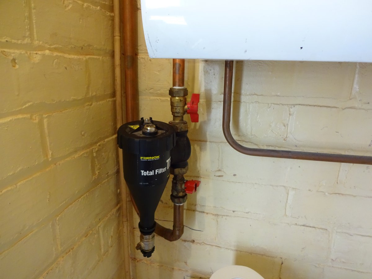

The boiler man did the annual service this afternoon. At 5:30pm the hot water switched on and the whole system was much noisier than usual. The noise didn't seem to be coming from any one place. Also, the pilot light in the boiler was off and it took several attempts to ignite it. I've noticed that the lower of the two red taps in the picture is horizontal, i.e. off, but I can't remember if this is its normal position or not. Can anyone advise?
Thanks Dan, all working now and much quieter :). The plumber was in and out very quickly so he likely had several more services to do before he could clock off.
Clean filter but no flow through it. And no flow through the boiler either. In effect the system was non functional. Lack of care and attention.

Make and model of this boiler ?
It's an Ideal Classic FF250, installed 2004.
