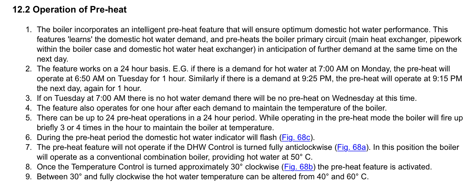

(Preheat indicator stays on after using the hot water tap?) Fitted a new diverter cartridge 28/05/21 which seemed to cure the previous problem where as the preheat was on constantly where has now it stays on after using the hot water. Any ideas anyone!!!!
Have a read of this:
Cheers CBW will give that ago. Where did you get that information from?
Baxi parts arena website, but it’s in the manual.
