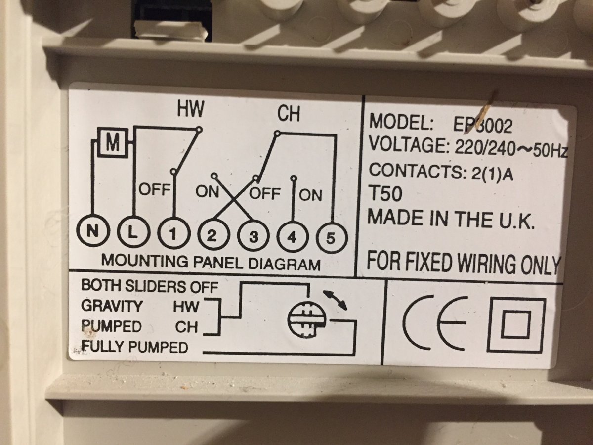

Can anyone give advice on conversion to 3rdGen Nest? ive looked at other similar posts but the wiring is slightly different.
this is my existing wiring.
cheers
H
There are two steps.
1. Replace the EP3002 with the Nest Heatlink.
There will be a wiring diagram on the back of the EP3002 that looks something like this.
This will allow you to identify what each of the wires does. 'N' and 'L' are straightforward and go to 'N' and 'L' at the Heatlink, the other three red wires can be identified as:
3, Hot water 'on'..... This goes to the Nest Heatlink 6 'Hot water call for heat'
4, Central Heating 'on'..... This goes to the Nest Heatlink 3 'Heating call for heat'
5, Central heating live supply linked to 'L'..... This link is removed and discarded.
Insert a link between the Heatlink 'L' terminal and the common terminals '2' and '5' As there won't be enough room in the Heatlink 'L' for all of the existing and new live wires, normally I add a separate new 'L' terminal and tuck it in the metal backbox and run just a single 'L' wire to connect it to the Heatlinks 'L' terminal.
The earth wires will need to remain connected together. Again, as there won't be enough room in the Heatlink for them all, normally I add a separate new earth terminal and tuck it in the metal backbox with just a single wire to connect that to the Heatlink earth terminal. Make sure that there is also an earth wire to the metal backbox.
