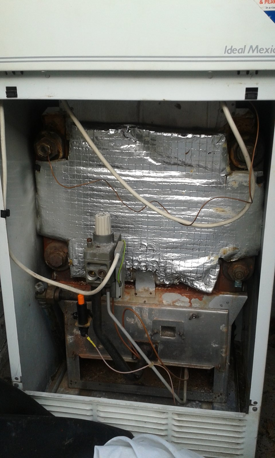

Potterton Ideal Mexico floor standing boiler
26 Apr 2021
2
i have been away from house for 6 months and need to relight boiler - all working fine before and serviced have opened case - which is the start button ?
Is it just the white knob or another reset button - where is that do you have Guide photo marker
thanks for help !
Press down the white know and turn to pilot position. Hold down and rapidly press orange ignitor until the pilot lights. Keep holding white noob in for another 30 seconds or so then release and turn to the operational positron
