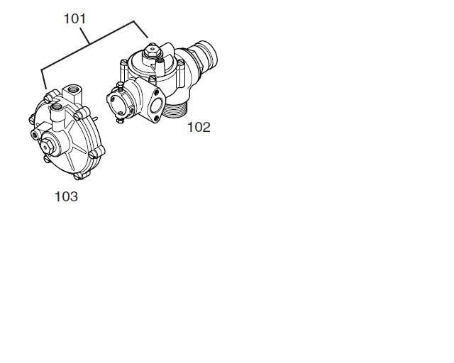

When I moved in to the house the pressure differential had been leaking, where the pushrod is. I replaced the valve in that and all was sweet.
Final question.
Is the the only part I need to buy?
http://cgi.ebay.co.uk/potterton-mai...543108465&po=&ps=63&clkid=7291880088259792514
or do should I think about replacing the differential valves (bit with the pushrod, I don't know the lingo)
Pic attached or in album !! ?!?!
http://media.diynot.com/151000_150624_31468_85286815_thumb.jpg

what tony ment was if you have the boiler on hot water only does the water heat or do you have the heating running while you turn the tap on.
i assume it works when only hw is on and would therefore guess its the main diverter valve that needs replaced as its passing. you could ask your dad to look at the colour of the system water as it could be related to poor water quality (choked up)
