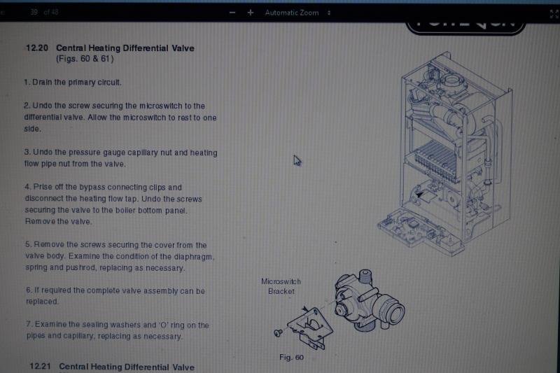

This is the page in the service Manual with the Differential Valve. Where is the Diverter valve in relation to this? How can I tell if it is working properly?
That's a system boiler part that you have posted.
The system variant doesn't have a diverter.

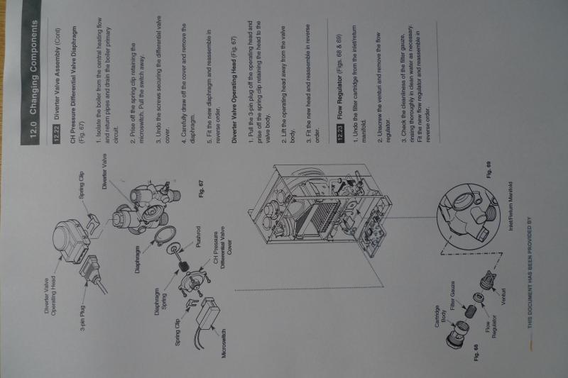

Right, I've found a Installation Manual for a Performa 28i. Will that be pretty much the same?
What does 'instant version' mean? It's definitely a combi. No water tank in the house.

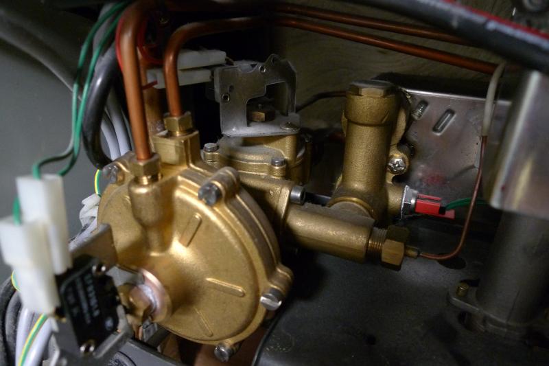

I've taken a photo of the insides of the boiler, and have found the right page from the Installation manual (sorry it's on its side!).
Hmmm... just had a good look, comparing the page from the manual with what I can see in the boiler and it doesn't look the same. I'll have to do a bit more searching for the right manual. :rolleyes:
That big brass section is the diverter valve. That will be stuck half in heating position.

From what I can work out, the hot water differential valve is the disc shaped one with two skinny copper pipes coming out the top of it, closest to the front of the boiler. And the central heating differential valve has a skinny pipe coming from the back of the boiler and this sits on top of the manifold. Is this right? And which one is knackered?!
Ok, so I've now opened up the boiler and tried to work out what's going on. When I run a hot tap, both pins extend from the differential valves and make their respective microswitches. This happens even when the selector switch on the front of the boiler is set to 'hot water' only. The radiators also get hot.
When I turn the selector switch to 'hot water & central heating' and then turn on the central heating via the wall thermostat, only the differentail valve that sits on top of the manifold operates.
I'm guessing the central heating differential valve is knackered and needs servicing/repair/replacing. Am I barking up the right tree?
Also, what would cause the central heating differential to operate when only the hot water is required (just curious!)? Not sure if it's relevant, but I live in an area with very hard water.
It's not either of the differential valves it's the main body of the diverter that's the problem. I've said it enough times.
The front diff valve is for HW. The one ontop, with the small pipe is the pump differential, not a heating one.
