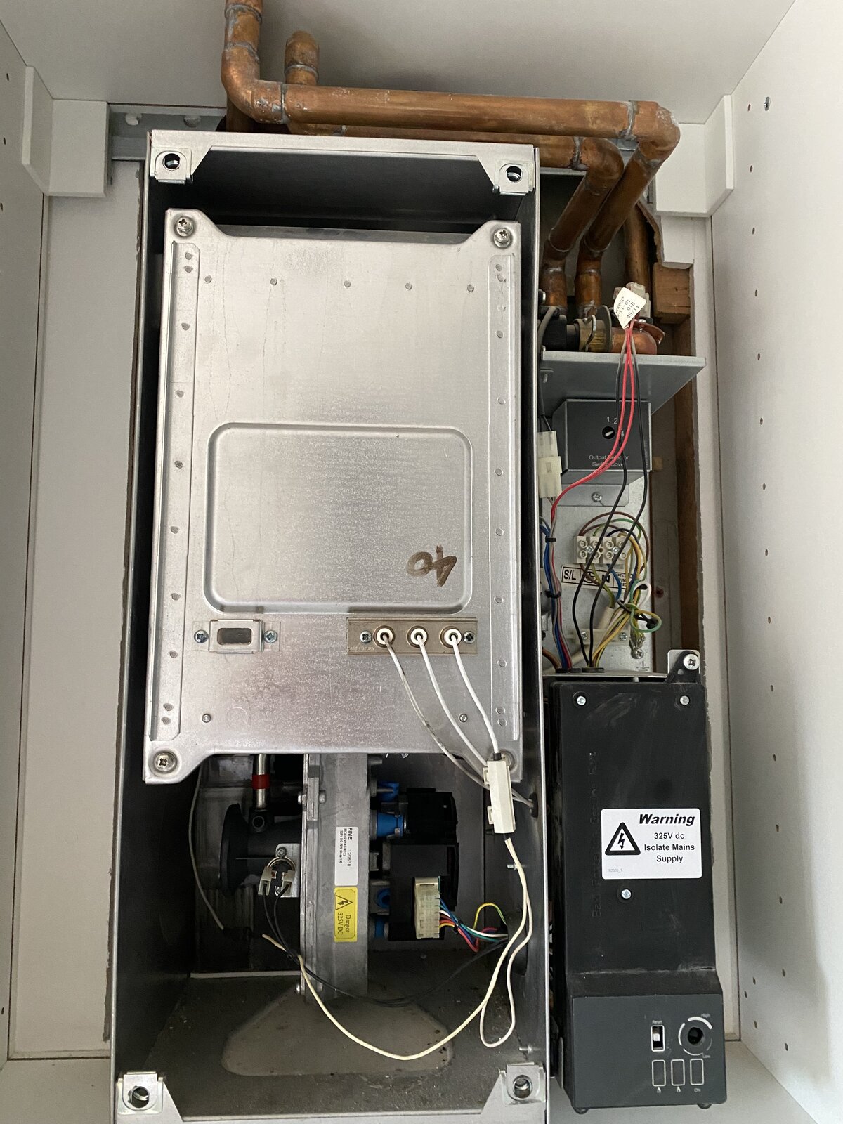

Bit more info, we have an unvented system, the boiler is in the kitchen and right above it we have the cylinder in an airing cupboard.
Some pictures of your system will make it easier to see what might be causing the problem.
Can you easily see the flow and return water pipes on the side of the boiler?
When it is running, cautiously feel how hot the flow pipe and return pipe get and report back.
I’m guessing the flow will quickly get very hot while the return pipe will remain cold, in which case there is a circulation problem. In which case there may be a blockage somewhere or a faulty pump.
Yes the flow does get hot, but over a couple cycles the return pipe will get lukewarm as well. Also the pump does not stop, so it keeps circulating the water. So no blockage or faulty pump.

Turns out we are covered by our home insurance so we got an engineer sent over.
I don’t think he figured out what’s at fault. So he ordered a new PCB cause the reset button is faulty on it.
Unlikely to be the pcb....id say its probably flow related. Either the system isnt circulating as well as you think it is and the boiler is going off on temp rise or the boiler believes it isnt flowing well. The flow switches are poor on these. Hard to say without being stood in front of it.
Update:
After the PCB was changed, the boiler worked fine for about a week... then the issue returned. This time it wasn’t turning back on unless I was resetting it.
So I called insurance again and they sent another engineer who blamed the flow switch. Then another engineer came out to install the part. He wasn’t very happy as he had to drain the system to fit this...
But great news, as it’s been working fine the past two weeks! ‍♂️‍♂️
It’s still making a bubbling noise and it starts at the boiler. Feels like it’s getting air as the water crosses then boiler? Is that a thing? I keep bleeding the system but doesn’t seem right. I hope it’s not going to cause more problems along the way...

That flowswitch design has been around the boiler industry for over 20 years and caused so much trouble wherever it's fitted...the braindead designers of that device didn't
understand that heating system water contains ferrous particles so they placed a nice magnet in the switch mechanism...you can guess the consequence including melted heat exchangers.
What's so hopeless for Potterton (Baxi really) is that they had previously used an off the shelf flowswitch that's bulletproof and almost certainly cheaper.
I'd love to know who came up with that boilers design...it ranks among the industries all time dogs..
