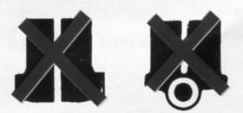

Not only does it appear to be fitted with the shaft at an angle above the horizontal, but it has been fitted with the electrical connections underneath instead of on top!
Reminds me of when I had pointed out one like that to a trainee who mentioned it to the installer.
The installer replied he had fitted hundreds like that. Trainee replied " well you have fitted hundreds wrongly then!"

Exactly!
It shows that you must not mount with the shaft vertical!
With a little thought you will deduce that it should not be fitted at about 45 degrees either.
For exactly the same reason which all RGIs should be aware of!

Exactly!
Tony
:ROFLMAO::ROFLMAO:...what has it got to do with a RGI FFS..
Shaft should rise slightly above the horizontal.
RTFM..
BTW ..why are you fitting circulators when you're clearly NOT a heating engineer.
Tony there is no denying the pump shaft should not be vertical, (marked with a big cross in the manual), else Grundfos people would be cross and you could get smacked for fitting the pump like that :ROFLMAO:
The video does not show pump in that orientation!!
