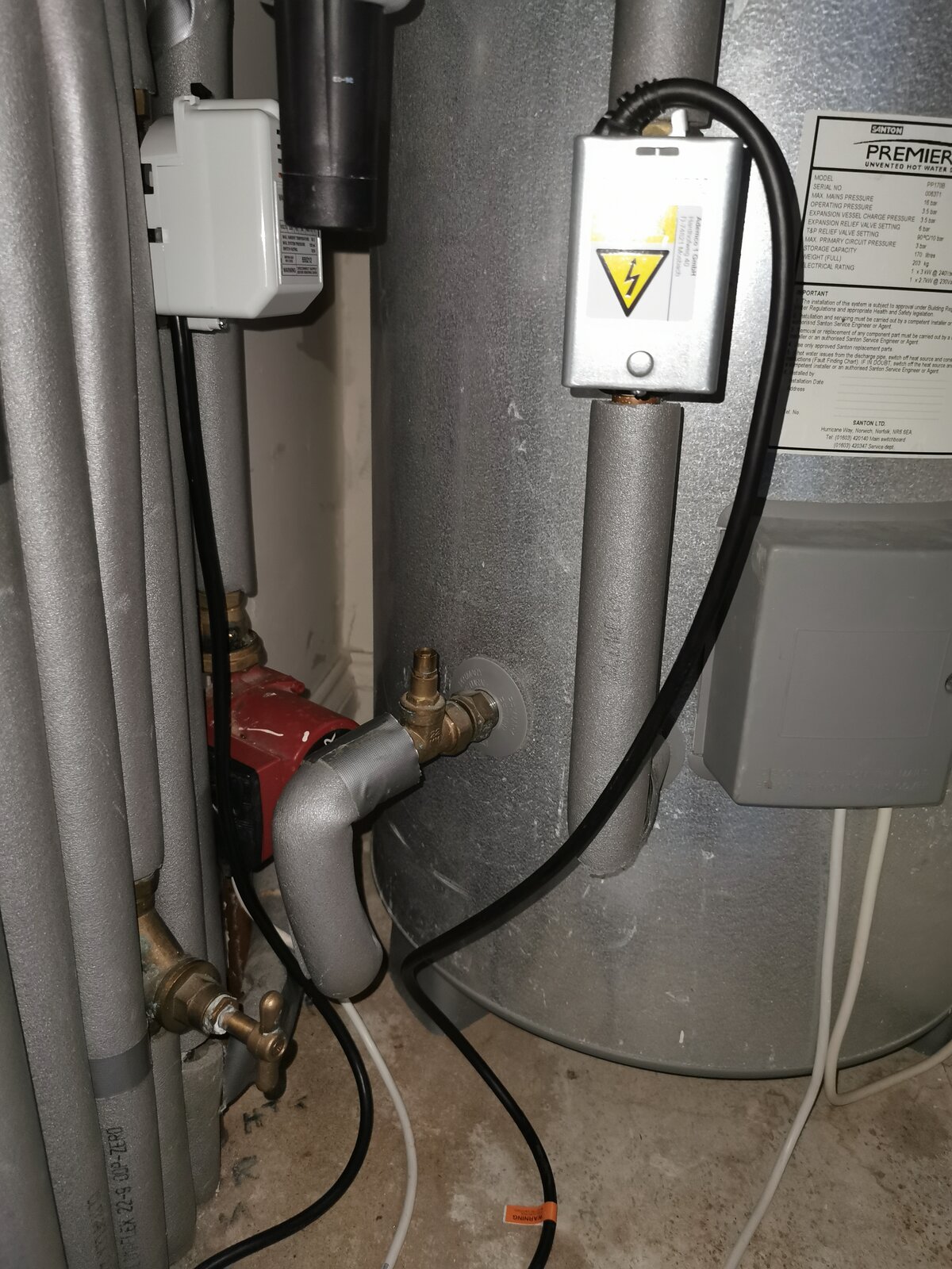

Hi got a potterton promax 15 he. Pumps with the cylinder in the airing cupboard but boiler is in utility room. So recently I've found in that can hear a loud clunking noise (around the pump I think, not sure) and then the boiler locks out. When I go to the boiler I hear a hissing sound as if steam is escaping and then notice wetness on the worktop.
Done a bit of investigation and it looks like theres a leak at the flow switch. As I'm not qualified for a repair like this I've called out an engineer but was wondering if anyone knows what this would be and what the approx costs normally are?

sounds like you have more than one problem , but you dont really give enough information, you mention pumps, it is possible that you have more than one pump , but unless you have underfloor heating that would be unusual, the water drip needs sorted but cant see how that is the cause of your problem

Hi sorry for the lack of information. From what I can see there is just one heat pump in the airing cupboard with the unvented cylinder and the expansion vessel. There are also 2 zone valves there. We don't have underfloor heating.
That's kinda what I was thinking. However it feels as if they are related.. There's no drips when it's working fine but intermittently, say once a day I hear the loud clunking and find at that point the flow switch is leaking and the boiler has locked out. During normal operation of the boiler there's no leak.
yes that is normal , you have an S plan system, post some pics of your valves and pump, if motorised valves are fitted the wrong way round , they will work but sometimes clunk when trying to close, the boiler leak will still need to be addressed, but unlikely to be the cause of the clunk
Here's a pic of the valves, pump etc.
Both of the levers of the zone valves are at the top, so I assume they are correctly installed?
In the past I have had the heating zone valve not close so the heating came on with the hot water. I took off the valve and manually rotated the spindle after a squirt of WD40 and its been fine since. Thinking about this further... it does seem like the problem with the loud clunking happens when the heating has reached temp and needs to switch off.
