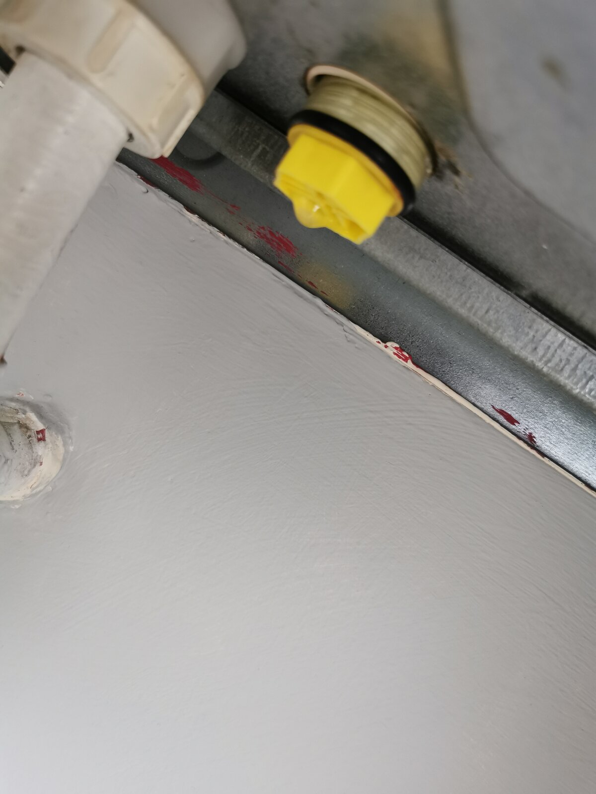

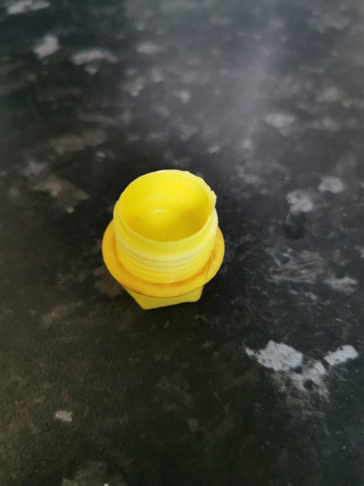

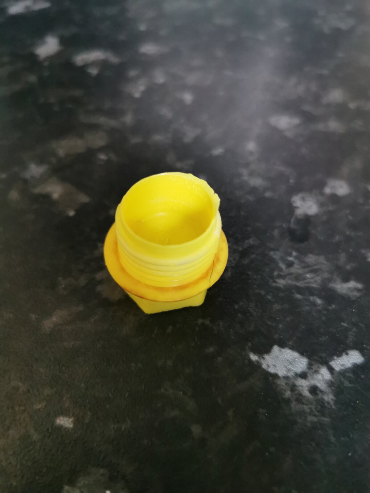

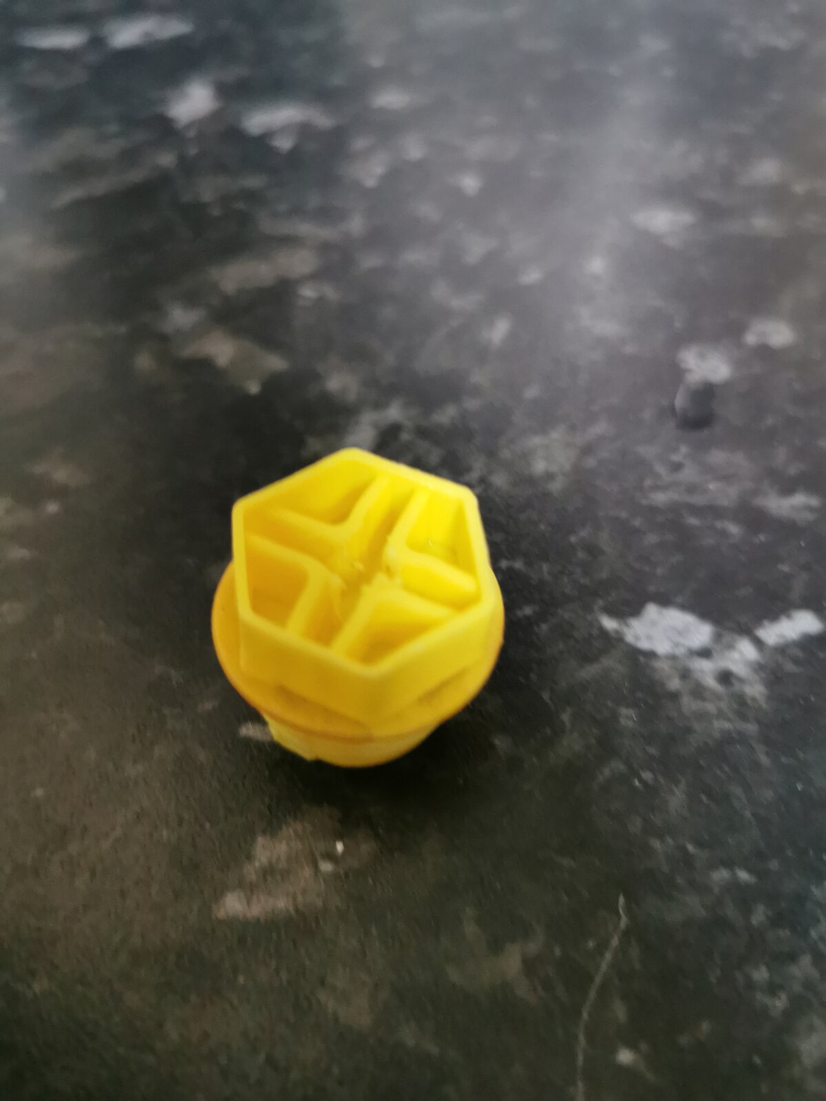

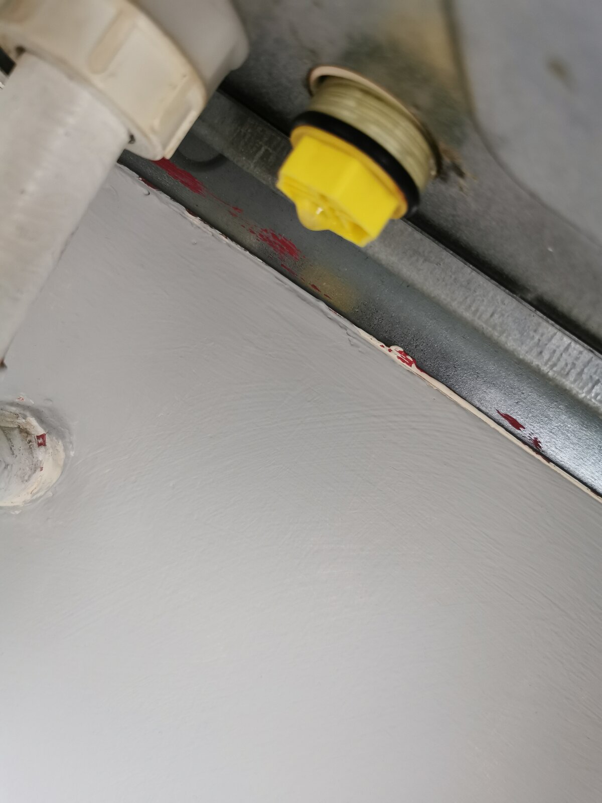

Hi,
Got a potterton promax he with a leak coming from the drain plug on the condensate trap. It appears to have a crack in the plug which is probably from overtightening.
Does anyone know if this part is replaceable on its own and if so what size is the plug? Where would you go for a replacement? Thank you

That's the only part number relating to the plug on the parts diagram, so I think that's your only option. It's only £11 anyway so hardly breaking the bank...
Ah ok, thanks for confirming.. Will get it ordered :)
