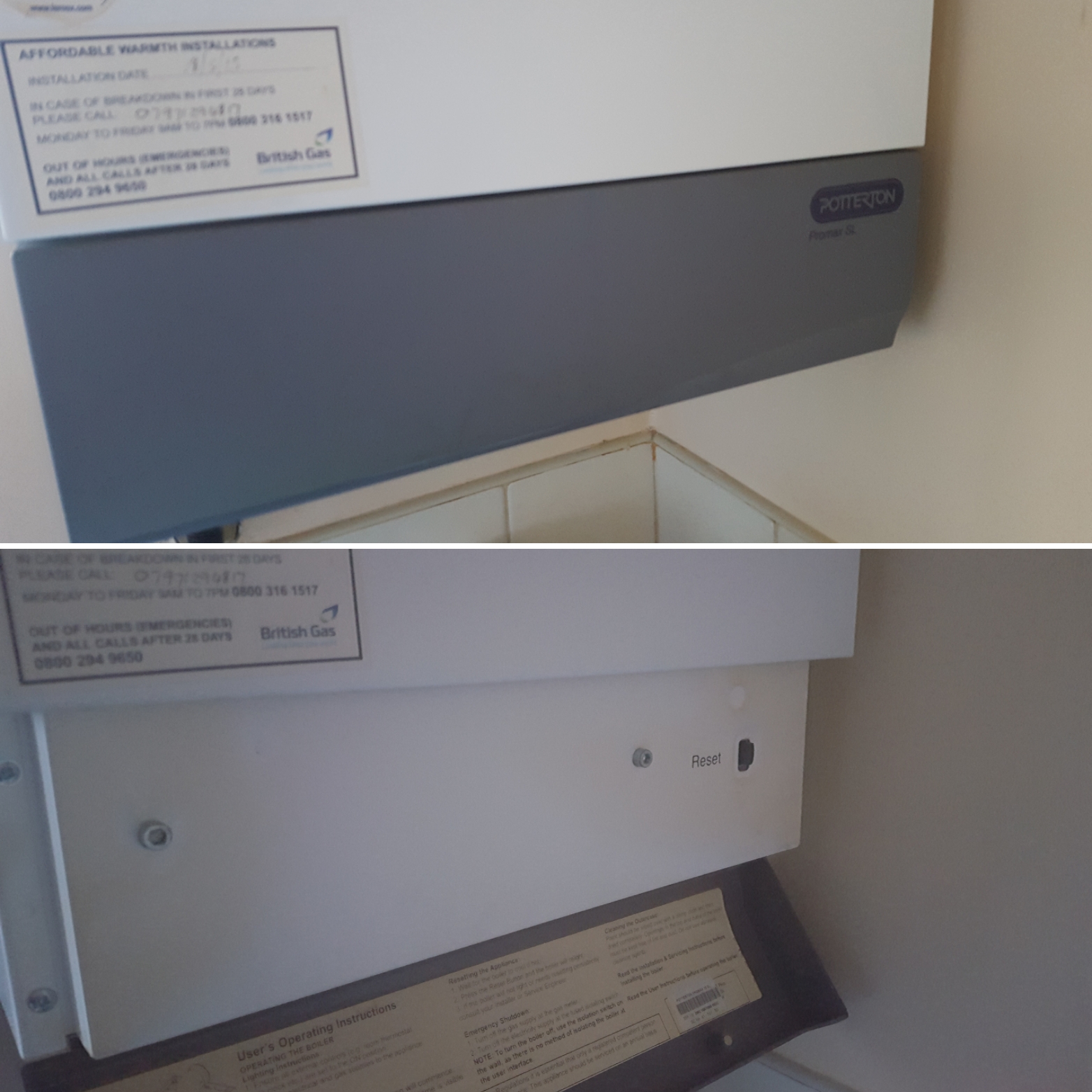

Hi all this is my 1st post
We have moved into a property, which has a Potterton Promax SL (not sure of the model number) it is a gravity (cold water tanks in the loft) condensing boiler)
it was installed for the previous owners in 2015. We had all the radiators replaced in the summer, and are now using the heating.
(Attached)
However when calling for heat, the boiler will spin the fans, light with a bit of a cracking? Clunking noise and then switch off after 10 min and will stay switched off for another 10 min (sometimes a lot longer) as a result the radiators do not get warmed up properly.
If you press the reset switch on the front, sometimes it will fire up, most of the time it does nothing.
It's totaly random when it does it, and everytime I call the plumber to come out and look at it - it works perfectly fine!
It is totally doing my head in., sometimes it works better if you have it set to heat only, and not Heat & Water, but its just so random that its impossible to predict when it does it.
Otherdays it will work as it should - but most of the time it keeps switching off randomly, on and off every 10 minutes.
As anyone else had a problem with these boilers.
Thank you in Advance

When was it last serviced ? it sounds like you may have a partially blocked condensate

Hi all thank you
So the plumber comes round to take a look, it works absolutely fine! and does so for the next 3 days or so. and now its back to the same problem.
I hate this boiler apart from the fact it plays up like this, there is no controls or anything just one reset button that does not do anything!
It was installed by BG do you think that they will have a better understanding of these boilers (know for certain what the problem is, when they behave like this) or will they just simply write it off to flog a new one
when you say circulation problem do you mean to much, or to little or is it impossible to tell.
kind Regards
You assume this is the boiler at fault, maybe erroneously so.
You state the system is a gravity one. I doubt that, more probably open vented, but fully pumped.
See post number 4 above.
More like a circulation problem.
I would suggest your plumber checks that the circulating pump is in good order, and changes it if there is any doubt. In fact I would go as far as to suggest you buy a new pump so that the plumber can fit it without delay.
