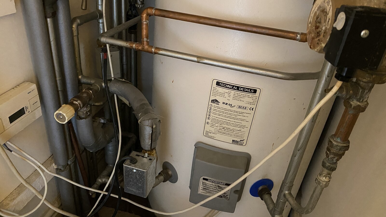

If it is tripping the rcd it would suggest the possibility of a water leak. Might be best to get a gas safe heating engineer to have a look.
Could it have anything to do with this?

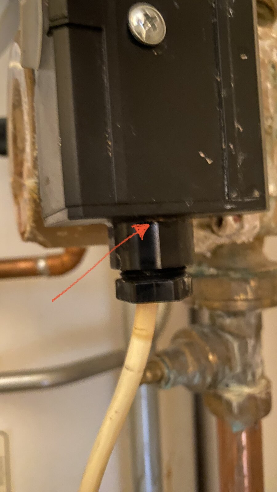

I haven’t noticed any leaks but the line scale there would say otherwise. Also that black box on the side with the cable going to (controller box?) looks to have a little water around the point of the red arrow.

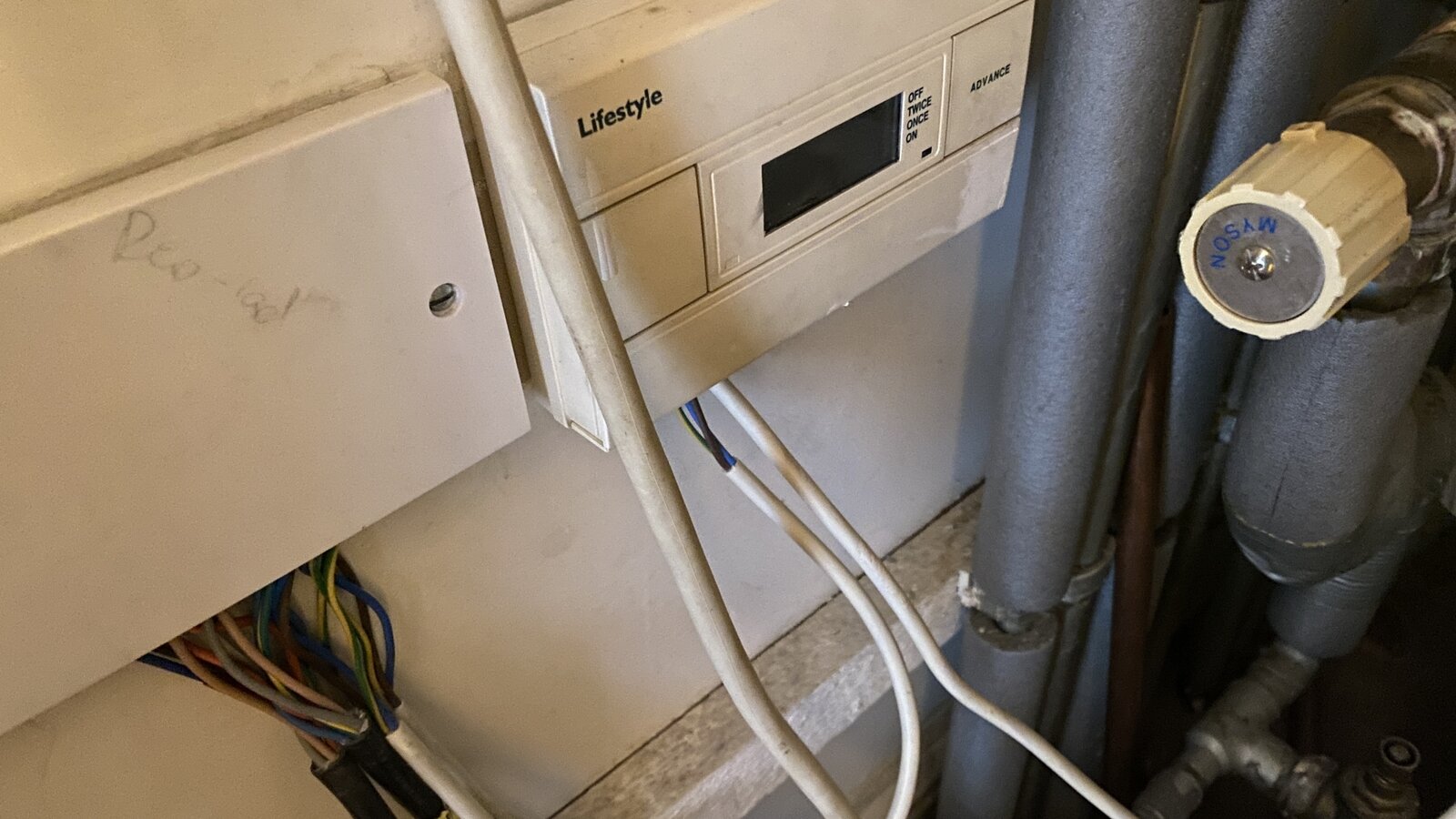

That cream box isn’t used anymore really. I don’t touch it. As the Hive was fitted years back so it stays always on.

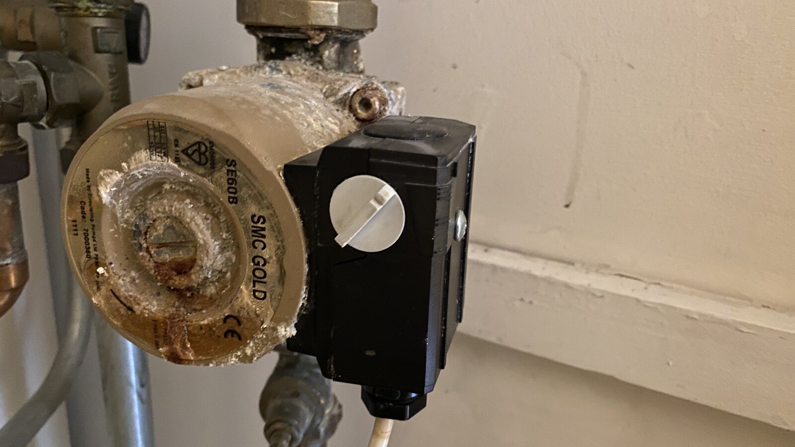

The first thing the engineer should do is determine whether the fault lies with the boiler or with an external component. Pumps are a regular cause of tripping electrics. The fact that yours looks like it does points to it being the cause.
The wiring looks like a poor diy job and certainly needs checking, tidying up and securing.
Thanks. It was indeed the circulator pump that had a slight leak. The cable coming out of the black part of the pump was disconnected from the control box on the wall and the boiler came on with tripping the rcd.

I didn't look too closely at the pipework in the pictures and didn't notice it was secondary circulation. Its job is to push hot water round a loop bringing it closer to hot outlets so that it doesn't have to come all the way from the cylinder each time a tap is opened. They are expensive as they are made of brass to cope with fresh water. There will be another similar looking pump nearby to push water around the heating system.
