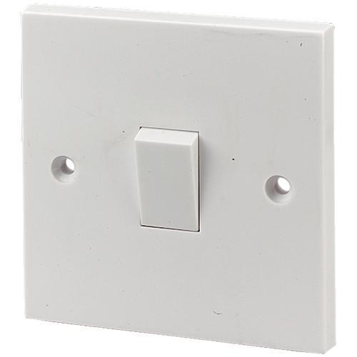

:LOL: I'll happily cater for useful daily light switches and sockets, but I don't like the idea of an FCU sitting anywhere within eye-line which will be rarely used/touched.
I did consider however instead of a ceiling mounted socket, I'll position the FCU there, sitting neatly beside the unit (mounted into the ceiling itself).
I'm still scratching my head on this one...
That seems strange reasoning, what's the big aesthetic difference?
Light Switch
FCU
Because this method of switching/isolation is for an island cooker hood - lets face it, it won't get switched that often as the unit itself has controls...
Read my first post.
