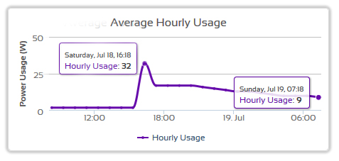

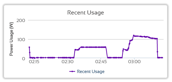

Unless paying out £90 plus or hiring a meter one is unlikely to get much better than the simple energy monitor. I have three plug in energy monitors odd but the more expensive versions tell you a lot less, OK you get a graph
but it rounds off the corners, so as far as inrush goes cheaper stand alone units are better. I use the energy meter to check the freezer is OK, the inverter drive easy, you see it is using around 60 watt, and when the defrost cycle cuts in you see the 180 watt as the heater turns on as a peak, but with the non inverter drive from memory the start amps is some where around 5 amps, as said varies, so I could not return to see if the defrost cycle was working. With the computer logged display I could, but no peak, power factor, etc, in fact a lot less than the cheap model.
