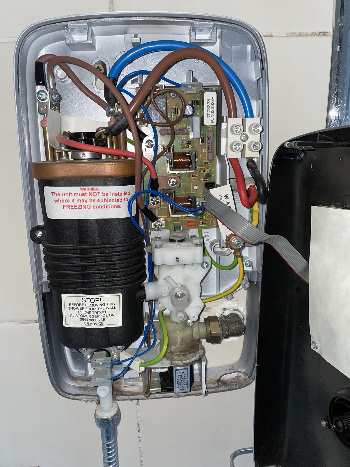

Hi,
does anyone know the power rating of this shower?
thanks for any help
J

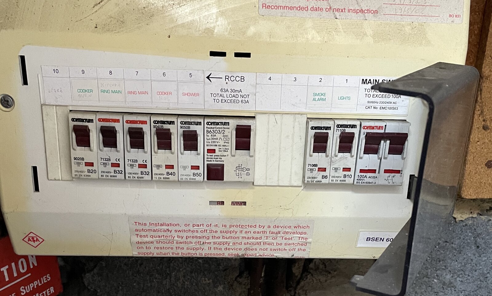

Nothing obvious. Is there a sticker underneath or on top?
What amperage is the MCB ,or fuse that protects the shower circuit ?
Thanks for your help. All I know it is a Triton Opal Chrome, but unsure of the model or KW. It meant to be underneath but it isnt and on the inside, which clearly it isnt either. So bit stuck, as need to replace it because of a fault with it leaking from the stabiliser valve I think.

You could measure the resistance of the shower and calculate the power rating.

Thanks for the info. Eventually, it worked out to be 10.5kw. As you can tell I am a complete novice, but could you confirm that this covers the shower?
thanks for your help.
The overcurrent protective device ( MCB) is 50 amp, and the RCCB to the right of it supplies it / protects against earth leakage. So in those respects it does " cover it".
The cable currently connected ,as in your pic, has somewhat damaged insulation and needs attention, can't make out the cable size . I would hope it's 10mm² ,is the earth conductor of that cable single solid copper ,or stranded copper ? Hopefully it is the latter
