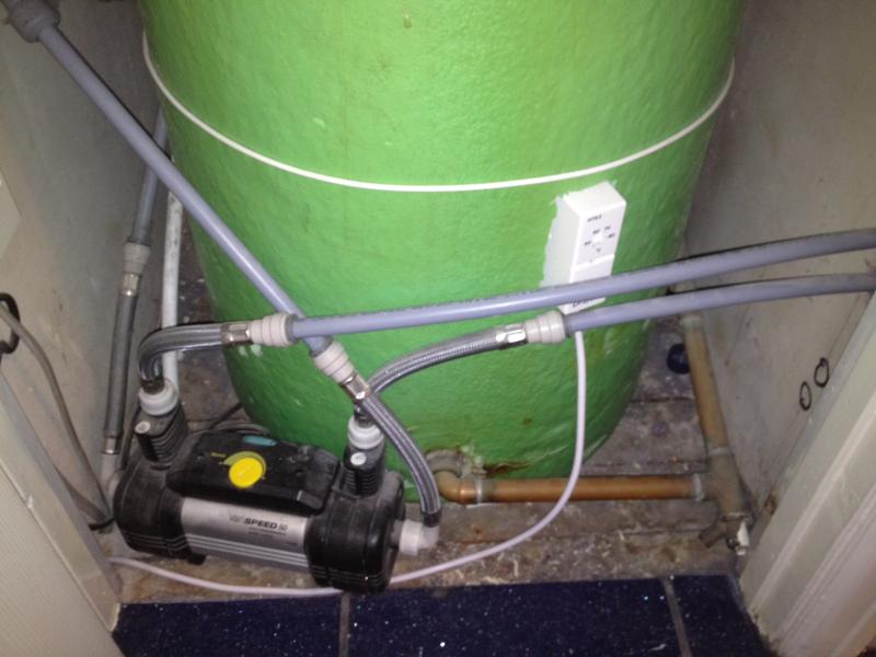

I have taken some pics of the hot water cyclinder so hopefully you can help me out!

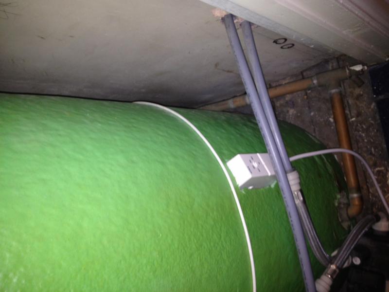

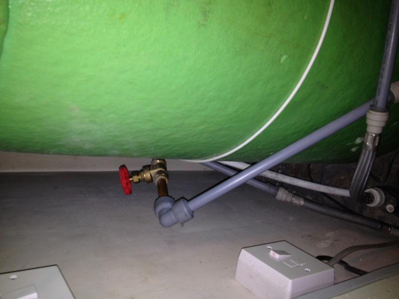

Look at the pump 2 top pipes go to shower.
2 bottom pipes 1 to hw cylinder 1 to cws

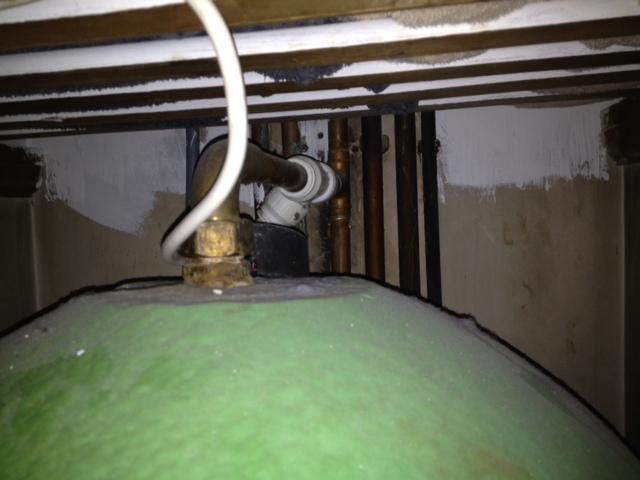

Show us a pic of the hot pipe connected to the top of cylinder.
and wheres the cold one connected straight to the cws or another pipe ?

The cold looks like it go's straight up the back wall to the cws.

Trace the cold feed to the pump all the way back to the cold water cistern supplying it (or where it tees into another pipe). The pump should have a dedicated cold feed from the cistern ie. no tees on the pipework. It reads like it isn't and you're getting a airlock on the cold feed to pump.
From your photo the pipe to trace looks like the lower of the two pipes running to the pump from the LHS of the cylinder. The other pipe will go to the tee at the top of the cylinder.
You've said once 'reset', the shower (& pump) runs fine until you next run a bath. So forget the small bore pipes, non return valves, blocked pump filters - these are not induced by running the bath, or miraculously fixed by the actions you describe to 'reset' the shower again.
