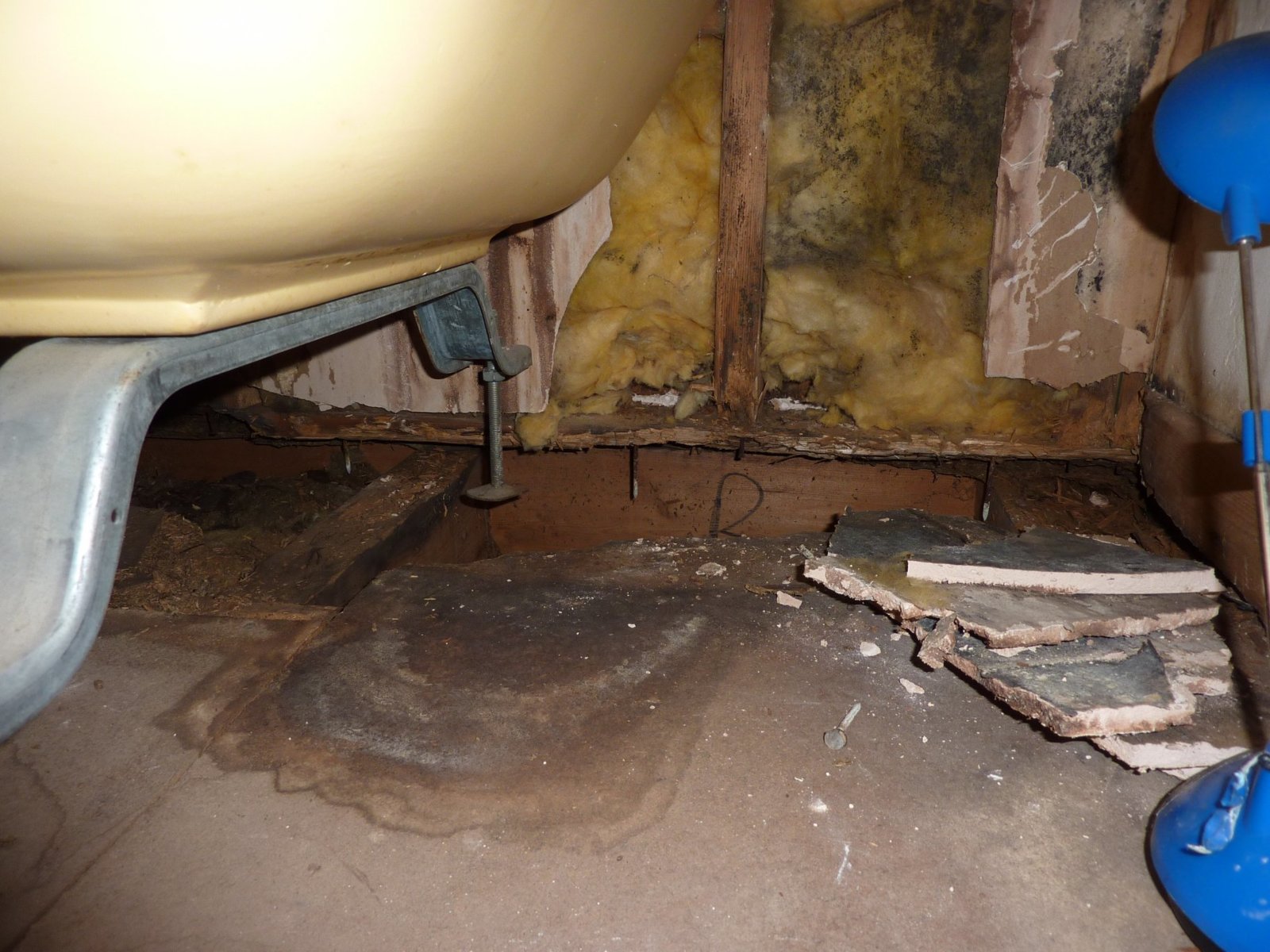

In the meantime I have discovered some other little diy job that needs some attention....
