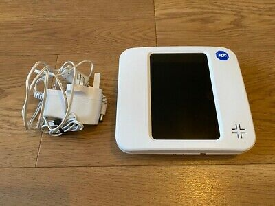

Can someone please help.
I am thinking to purchase Visonic Powermaster 360R and having looked at the manual, it looks like it cannot be hardwired but have to use the plug-in socket for ac powersupply. Can someone confirm this is the case and whether it can be hard wired at all?
Thanks LK
From the many pictures on the web:
It appears that the unit is powered from an (extra) low voltage power supply.
You will need to plug it into a socket.
Is there a particular reason you want it hardwired?

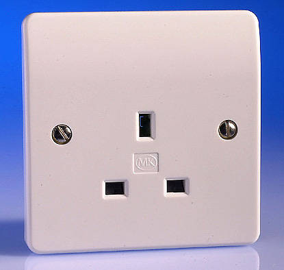

Thanks Randomgrinch. It's just that I have never seen any alarm systems powered from sockets as such but I suppose things are changing all the time. The reason I prefer direct hardwire is because there is no accidently turning of the switch or if the power to the socket goes off, there is still a mains supply to the alarm
An unswitched socket may be a halfway house?
