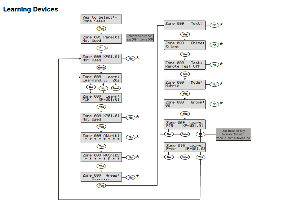

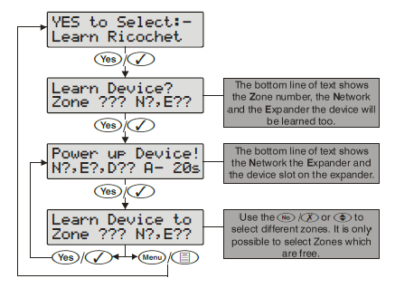

I have a new premier elite 64w and when I go to learn ricochet then press learn the power up device does not come up. I have tried defaulting panel.
Any help would be great.
It just sits on the learn screen and when I hit yes nothing changes. Yes this is the first device.
which device you trying to learn on? and how far do you get based on attached diagram.
I get to the learn device
Zone 9 for example. But when I hit yes
I get a single tone and the screen does not change to power up device
I am trying to learn a keypad. Pir. Or contacts. I can’t get it to the power up device screen.
okay so you have just the wireless keypad plugged on to the engineers port currently?
Okay.
1. check that the commissioning jumper is in the off position (texecom advise it shouldn't make a difference, but I have found it can cause issues when learning)
2. Go to zone 9 and start the learn procedure, ensure its on address 1,put the batteries in the keypad and remove the lead, should be promoted regarding learn the keypad.
