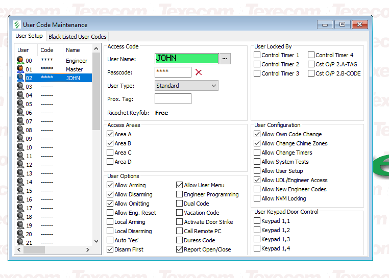

So what is programming for user 2 don’t need the code just the settings, then need to know zone programming
User type standard
Access areas a&b
Allow arming
Allow disarming
Allow omit
Disarm first
Allow user menu
Report open closed

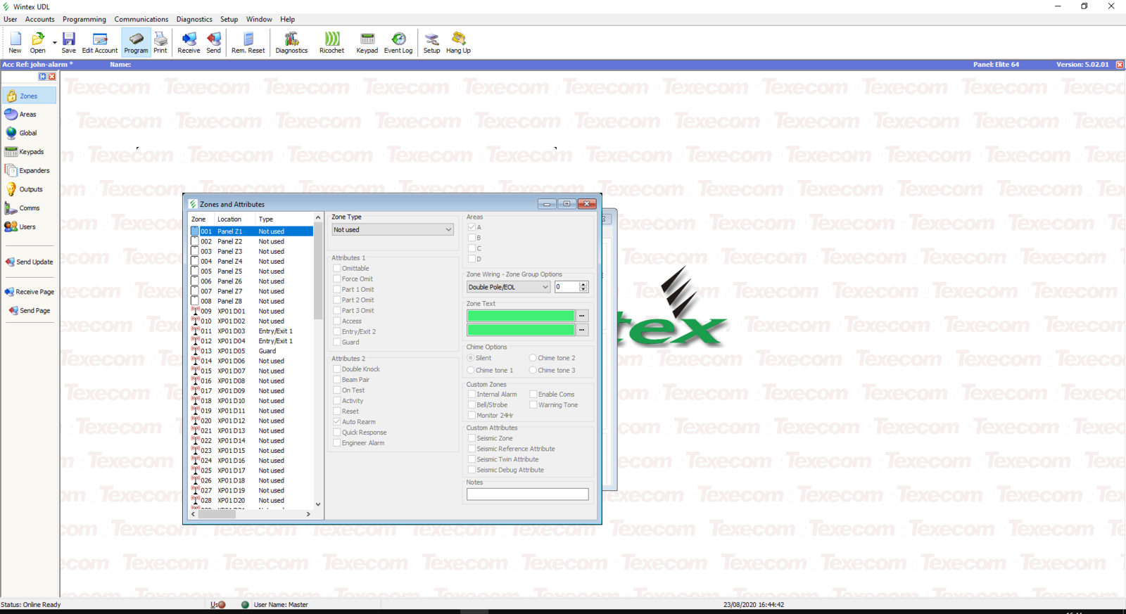

zone 11 entry/ exit Area a
Zone 12 entry exit Area a
Zone 13 guard. Area b
i went back into engineer and confirm devices then exit , now allows me to arm and disarm
