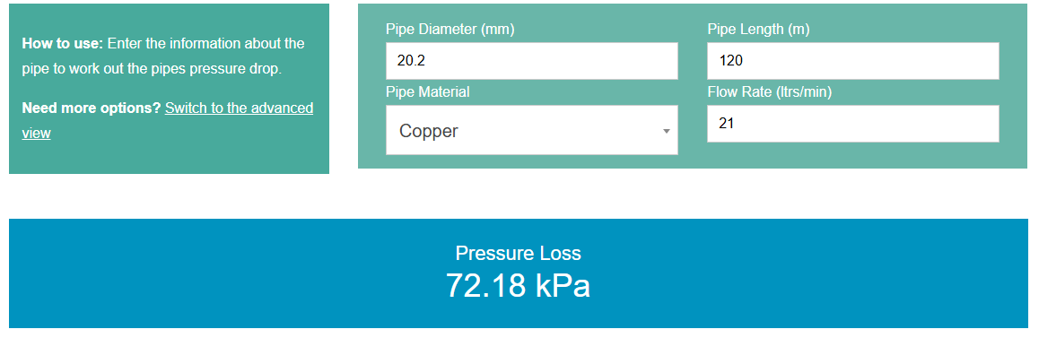

Has anyone used these or recommend one?
I'm trying to get a rough idea of the theoretical pump head needed for my CH pipework.
Currently there is one circuit for upstairs and one for downstairs. Each circuit is about 60m in total (when you add together flow and return). So overall that's 120m.
The calculator I tried shows that it needs 7m of head. But my pump only gives 3.5m head at the current flow rate. So that doesn't make sense. Unless I've made a mistake :)
I get 101.6 (10.16M) using this one (copper pipe) so your pump will "only" flow 21*(3.5/10.16)*0.5, 12.33LPM, but the pump head will rise as the flow decreases so say ~ 4.0M pump head = 21*(4/10.16)^0.5, almost 13LPM (12.96), (12.6LPM per the omnicalculator)

Yes as there are 2 circuits does each has its own pump or is it some how split off, if its split off then depending on the frictional resistance of each circuit will depend how much of the flow each circuit takes. The frictional resistance of each circuit depends on length of pipework, number of different fittings along the route and frictional resistance of the pipe (new or clagged up?). I think your expectations in obtaining any realistic results are slim. No doubt central heating installers go on a rule of thumb when sizing the pumps, a bit like when working out heat losses/requirements to size a boiler, get somewhere near, add a safety factor and pick the next size up.
I get a similar figure, using pipe roughness 0.05mm. Not clear how the link defines Pipe roughness coefficient.
But 120m pipe is OTT, for a typical house 12m effective length more likely. For one thing, usually the flow splits into parallel paths.
