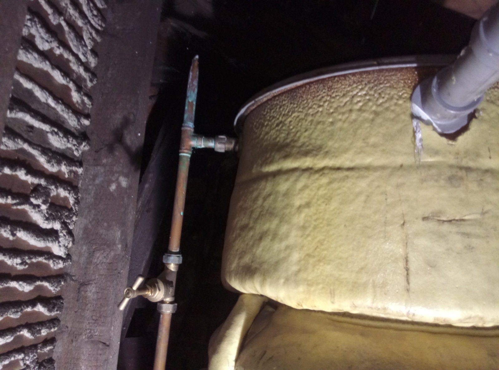

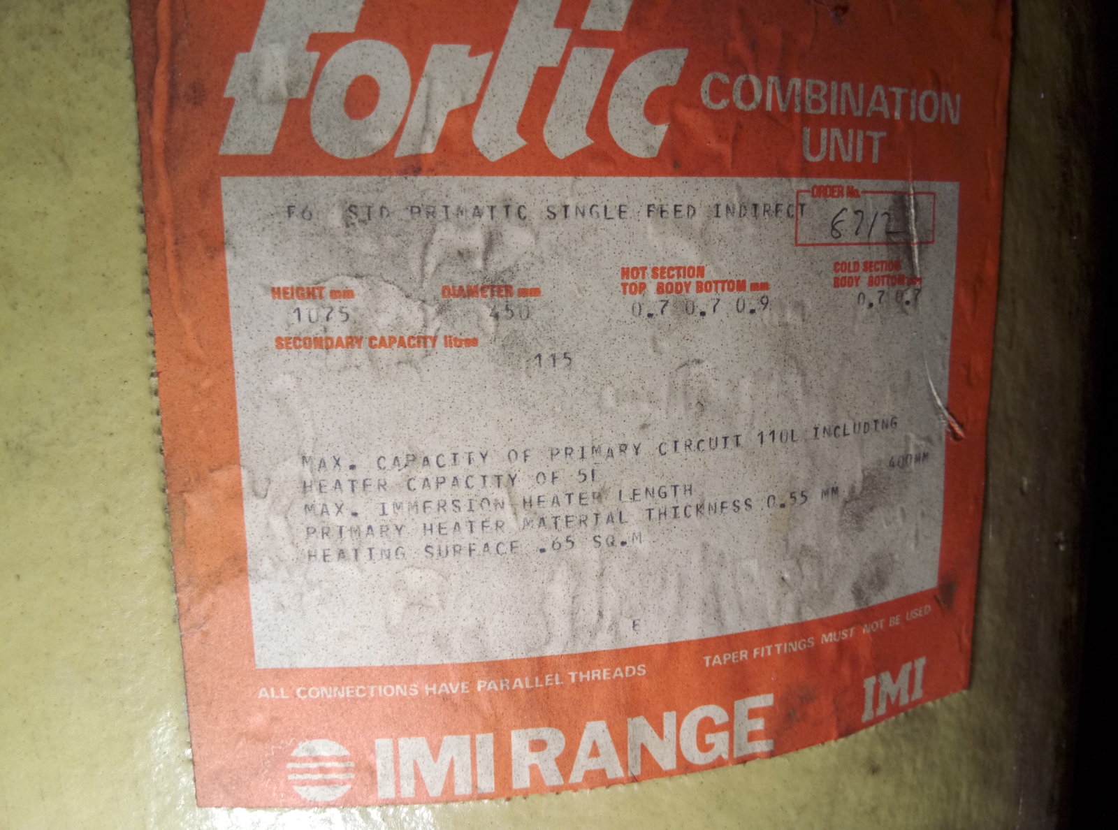

Primatic cylinders
Fortic indirect Primatic cylinder

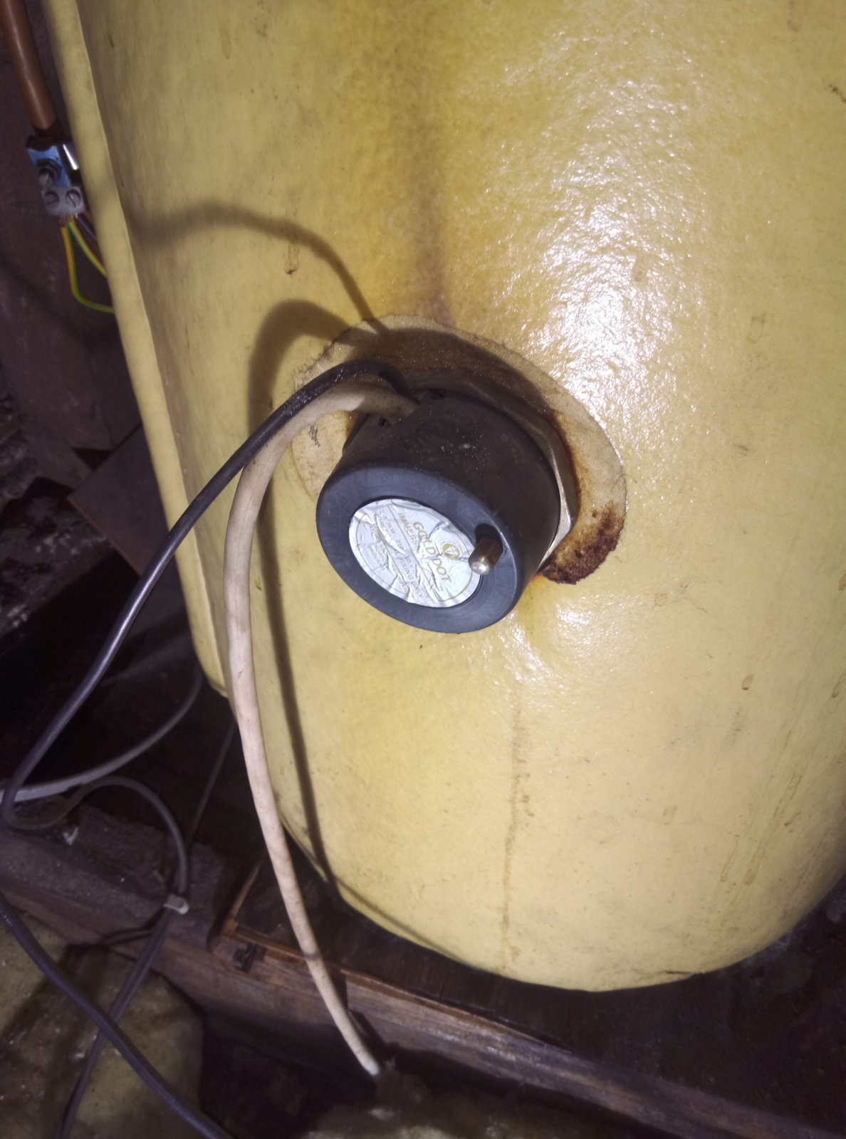

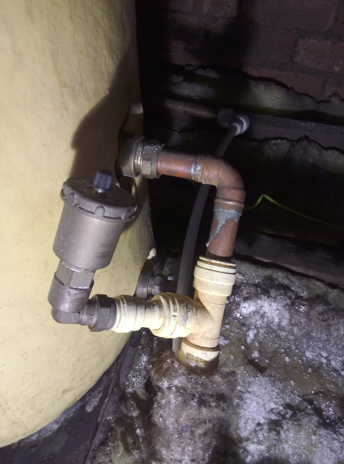

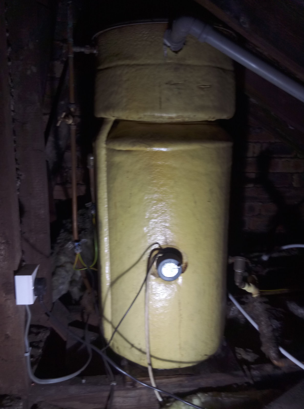

More pictures
That is a primatic cylinder with its own cold water storage tank (not an F&E tank).
If the CH can be pressured (sealed) with an expansion vessel then do it, replacing the Fortic primatic with a Foric indirect cylinder.
Well I got one from my supplier for about £400 which was only about £100 more than conventional combi cylinder. I don't have time to faff about and covert it and I just want the job done to be honest so I'm just replacing it like for like. The only advice I've had with regards these is to fill them slowly to allow time for the air bubble to form so if that's all there is to take into consideration than that's cool.
