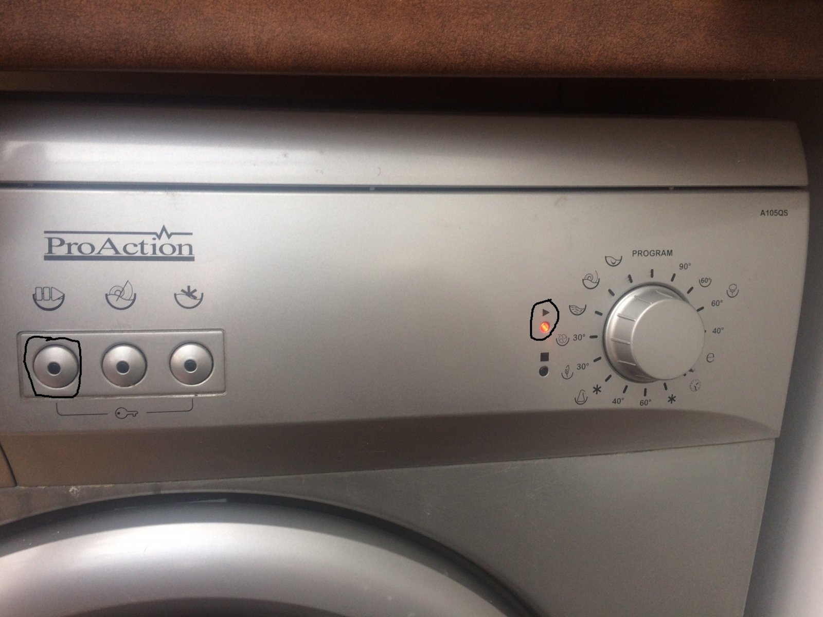

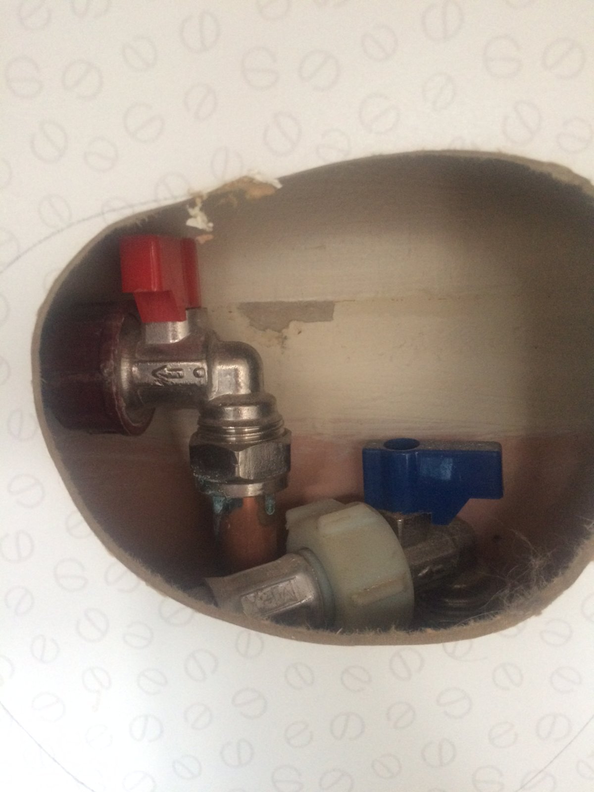

Hi.
My washing machine is playing up. After a while of being on one of the cycles, 2 lights start flashing red. Please see the pics attached.
The lights flash quickly and the machine stops. This last until you turn it off and on.
Not sure what to do....any ideas anyone? PLEASE?!
Thanks!

I know nobody answered your OP. But now you have got it working, and I usually get blasted for saying this but there you go, please tell us what you did.
This is a help forum and others might have the same issues with their machine.
the filter was clogged up so it didnt want to work. I had to clean it out about 3 times. messy!
