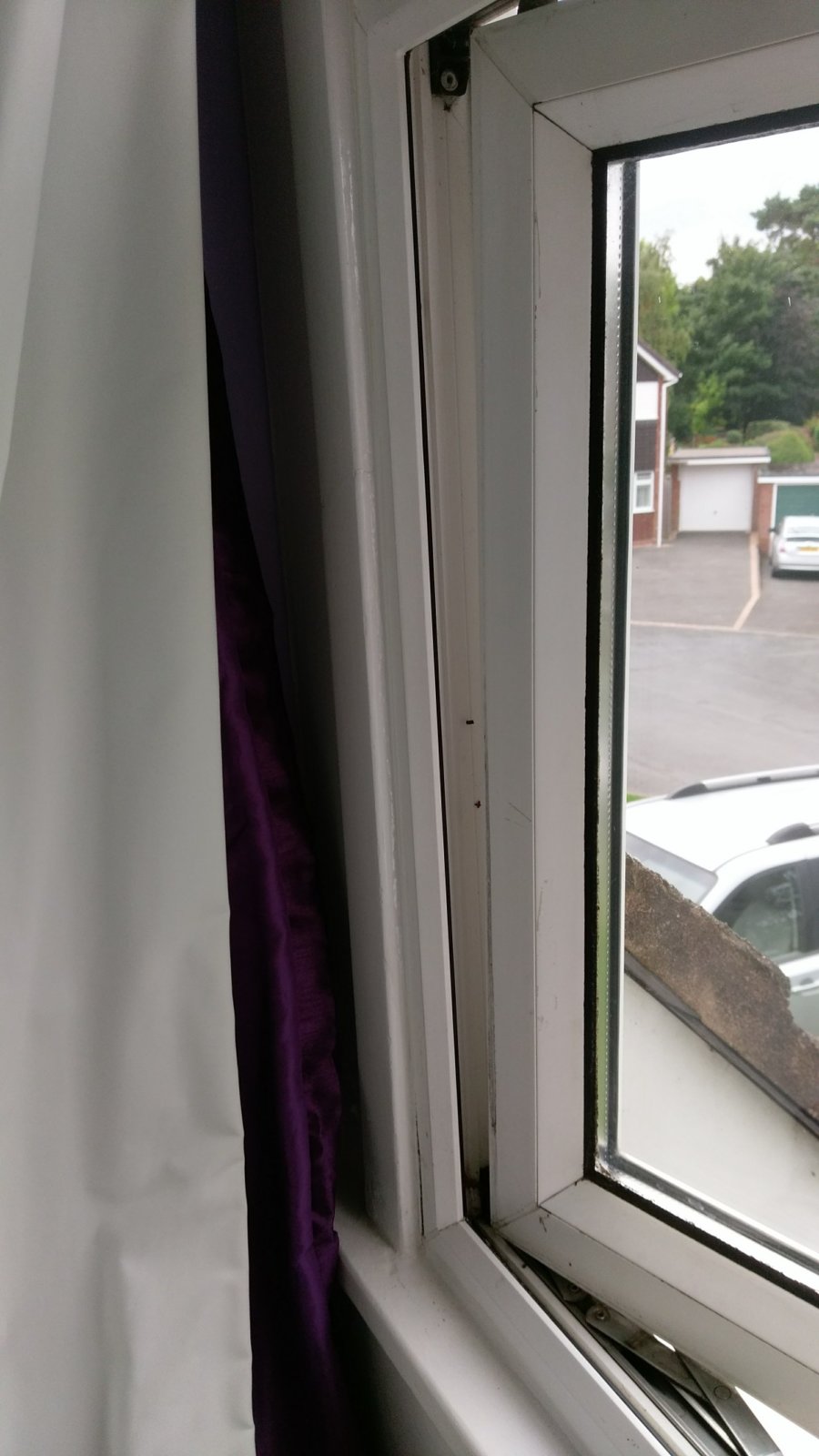

Hi there
First time posting so hopefully someone can help. I have seen similar enquiries but need advice specific to our problem.

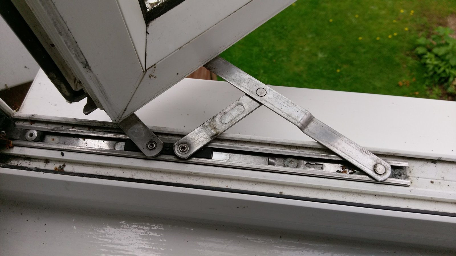

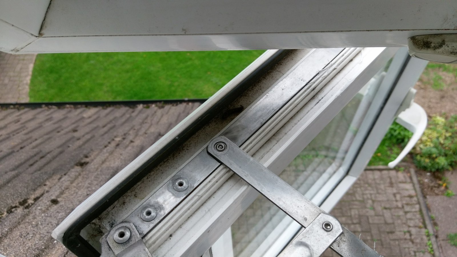

Basically a bedroom window suddenly won't close properly. If you look at the pictures, there's quite a big gap at the top compared to the bottom. I can't see where on the hinges thst sny adjustment is made to bring the top closer. The runners all lok like they function corectly and dont appear to be getting stuck.
I did read on another thread that you can by new hinges/runners or whatever they are called but they look like they're riveted on.

Yep looks like you need new hinges.
I would recommend getting an expert in due to the pop rivets. Easy to get out but you need a good match on the replacement hinges (hole locations) and you will have no adjustment, So need to get it right first time.
All rivets will need drilling out with a 4.8mm drill bit.
as an aside
you can often push an opposite corner to the out off alighned edge to line up the loose hinge to work properly
