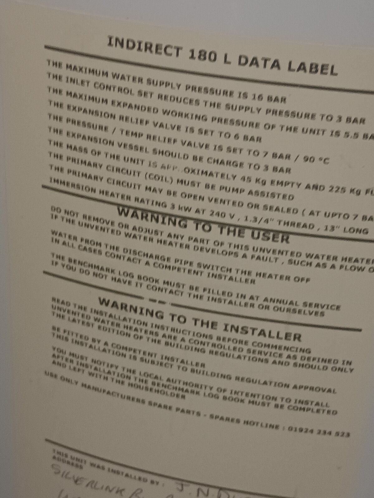

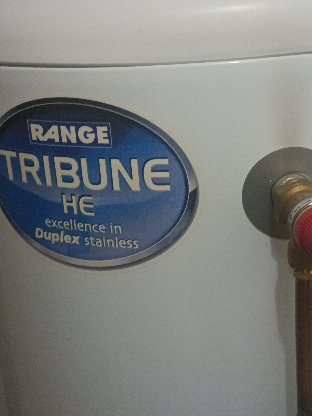

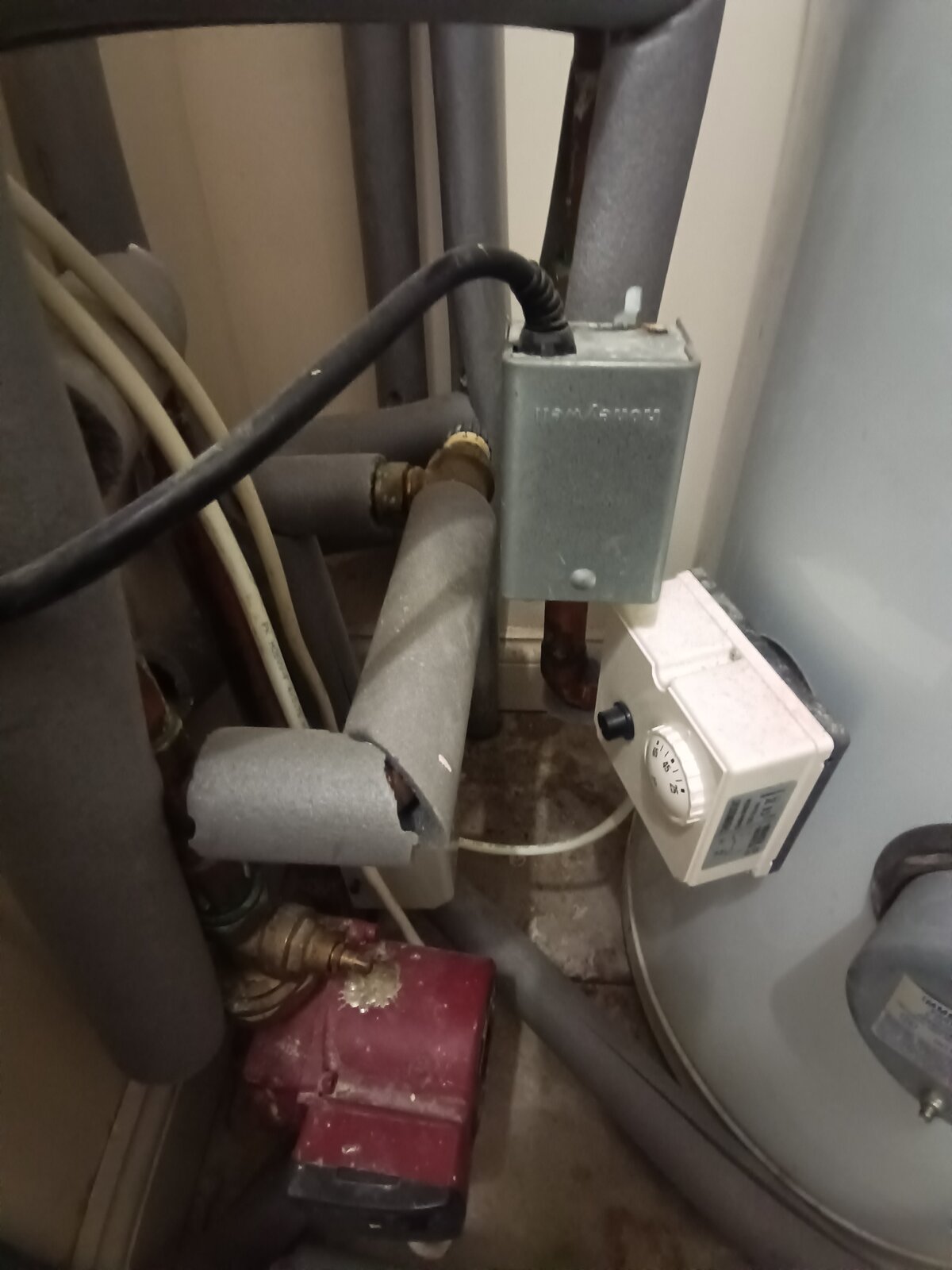

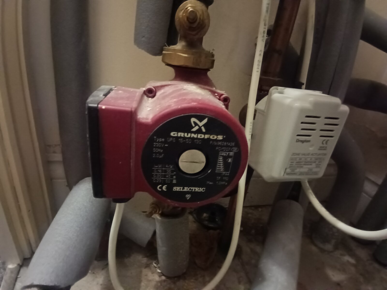

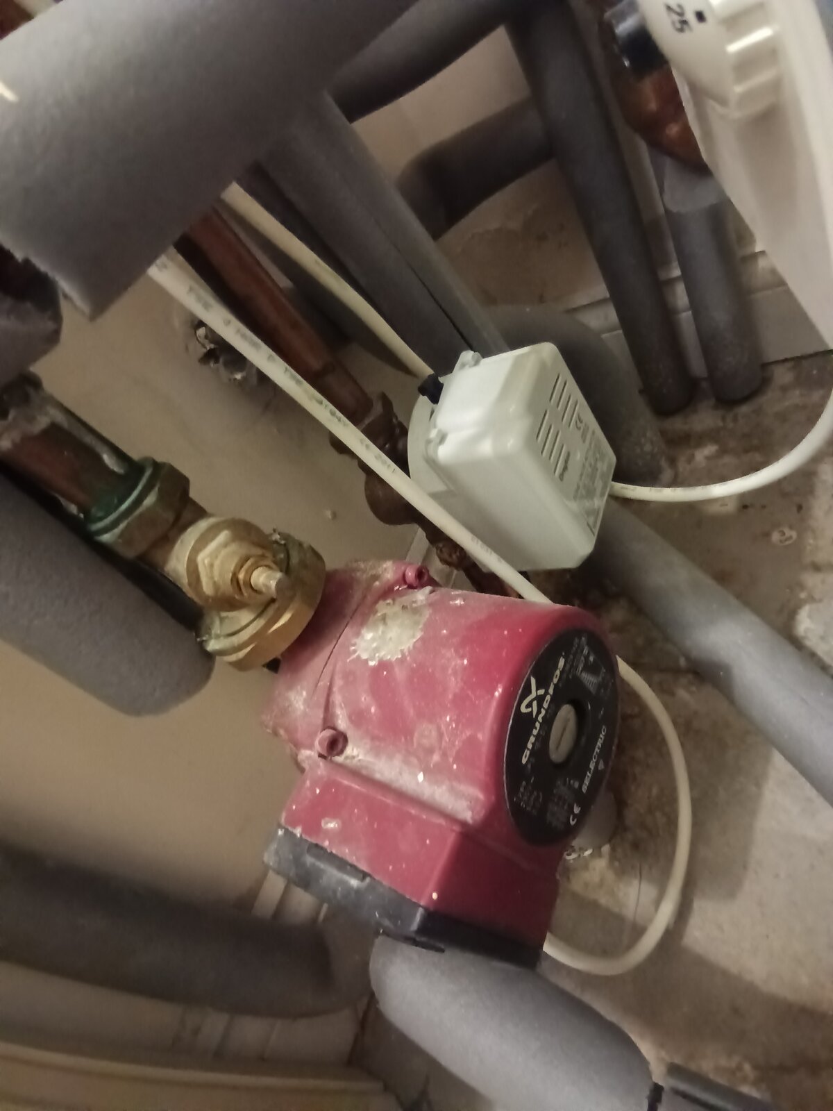

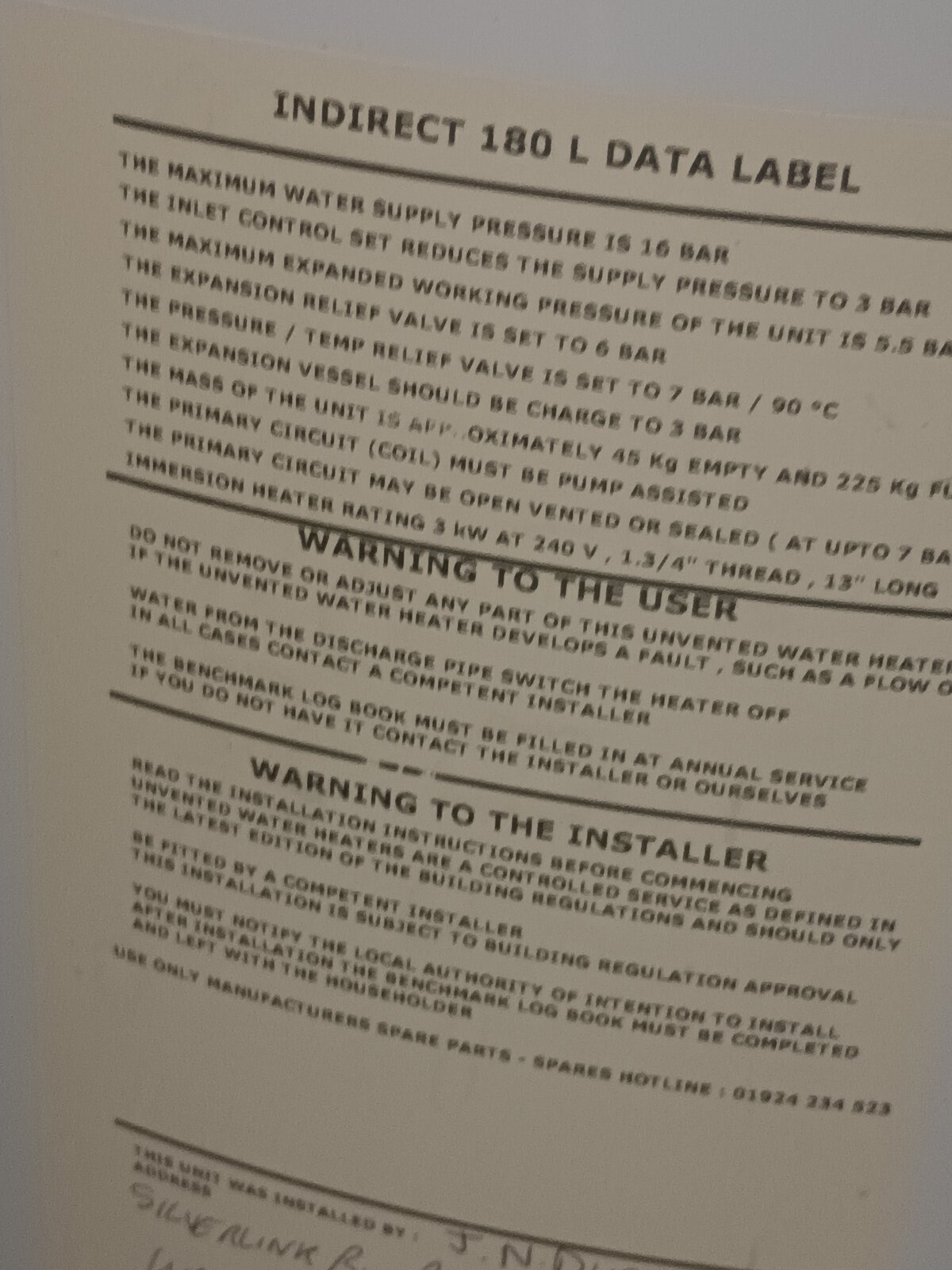

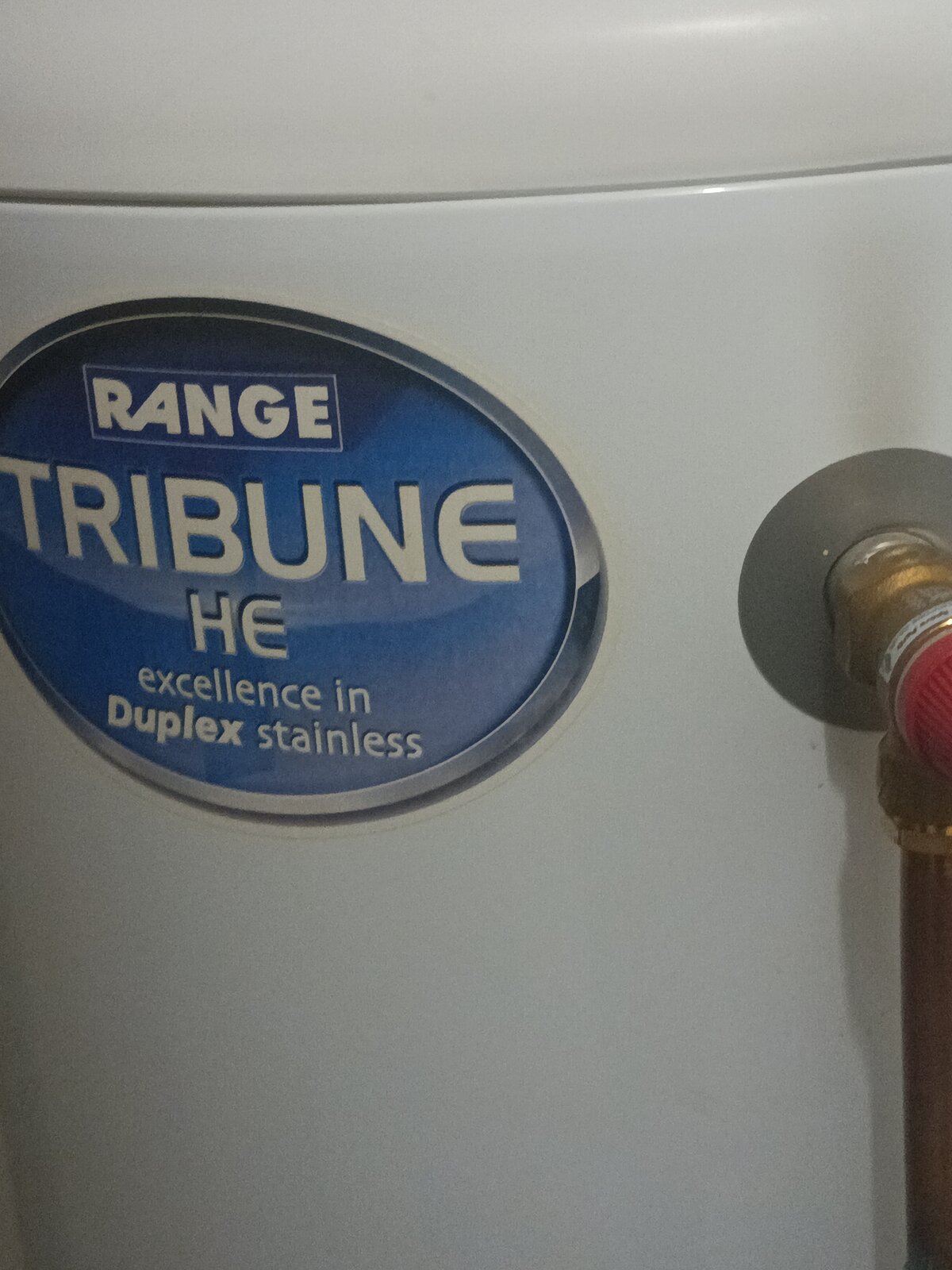

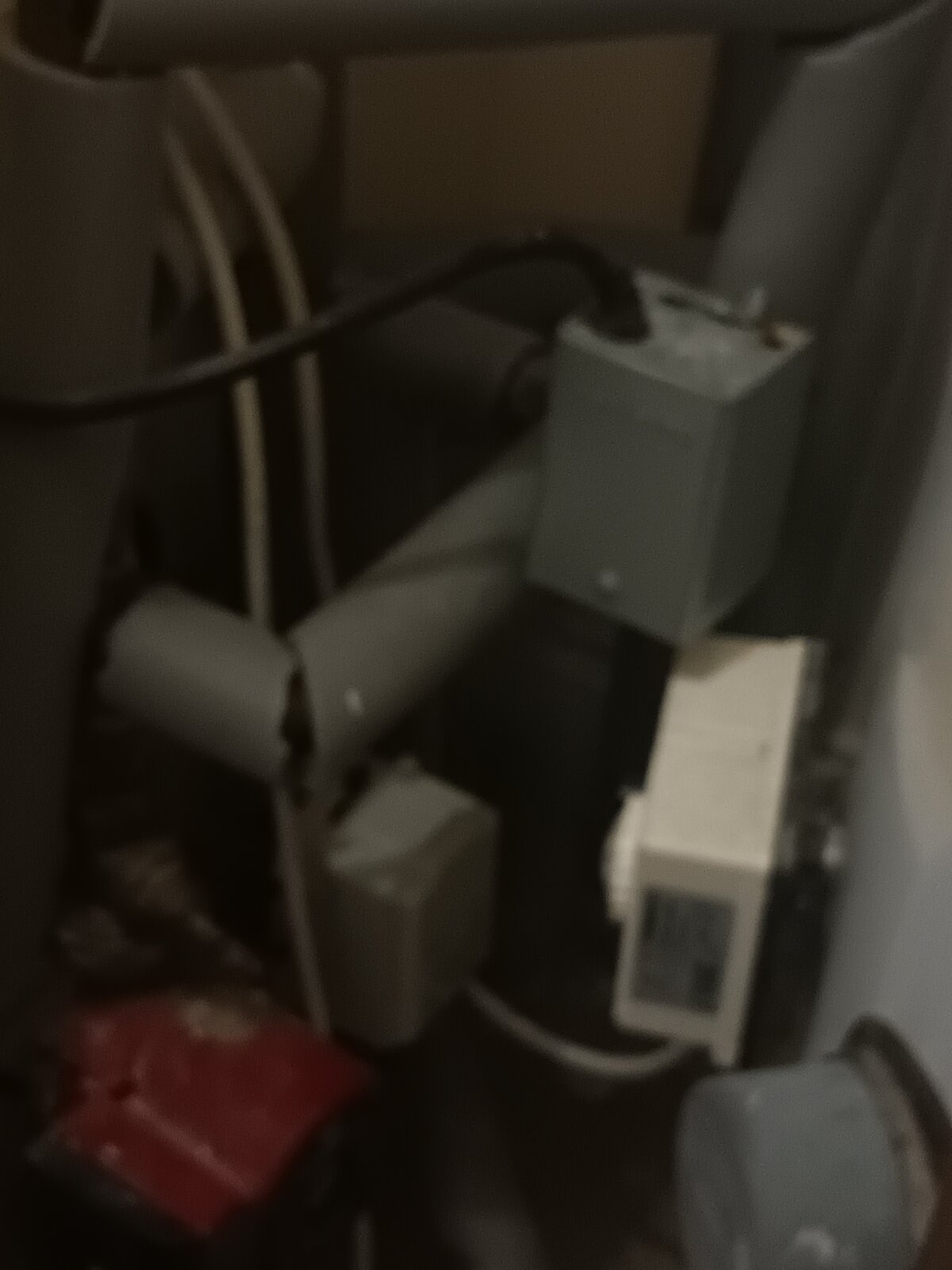

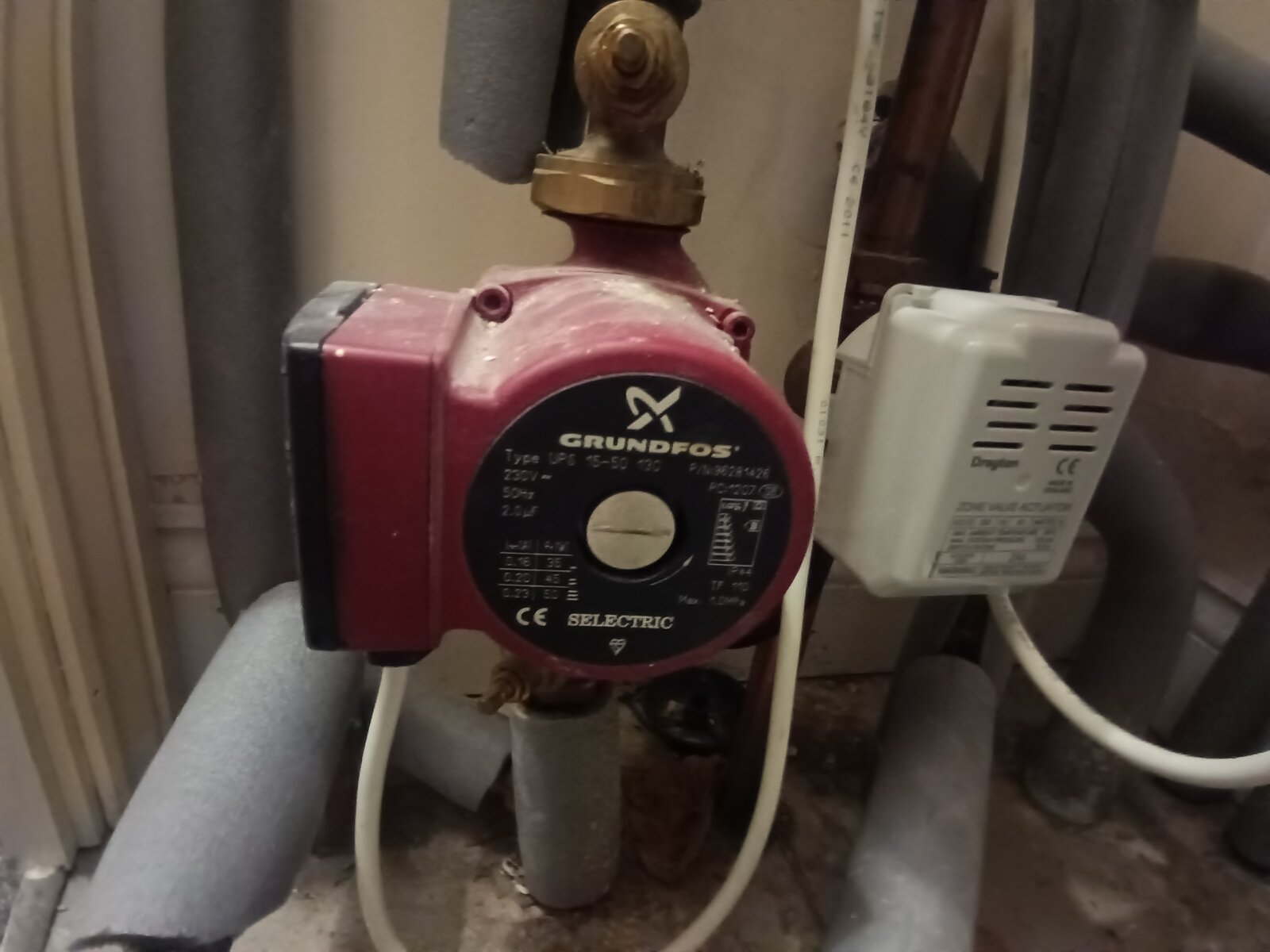

Pictures of the HW cylinder and especially this pump - general views and closer ups showing make and model plates if possible.
Picture of other controls :
isolator and programmer for the CH in kitchen
room thermostats
stuff in the HW tank cupboard, or elsewhere, such as motorised valves
Do these help?

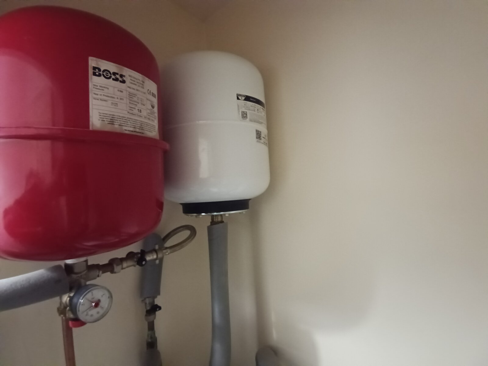

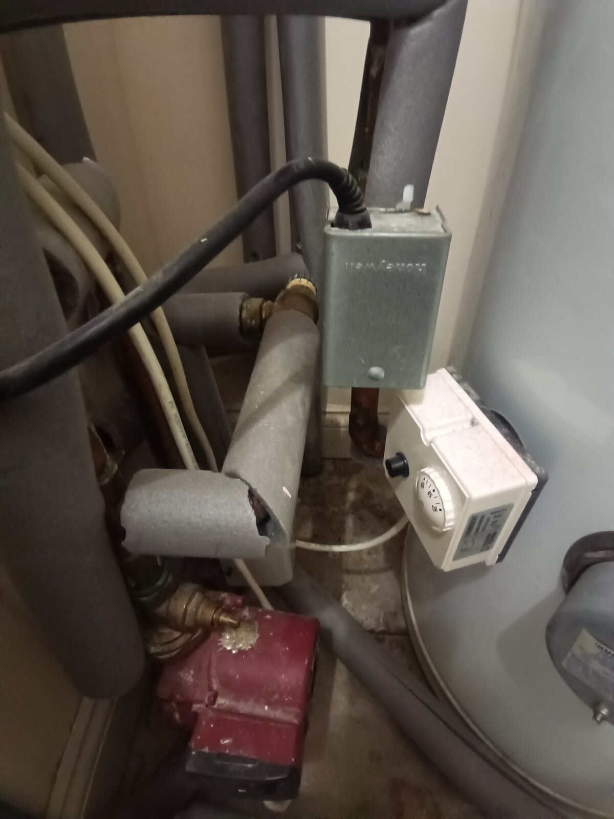

Getting there.

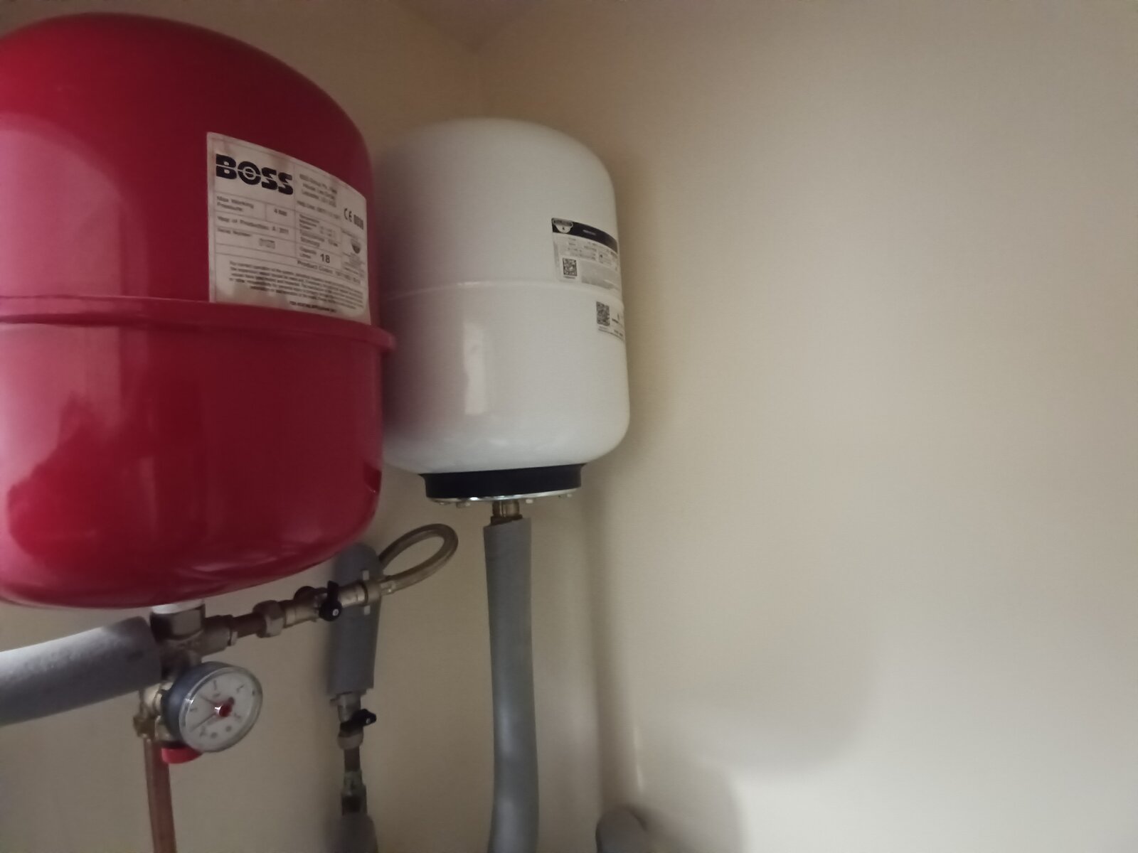

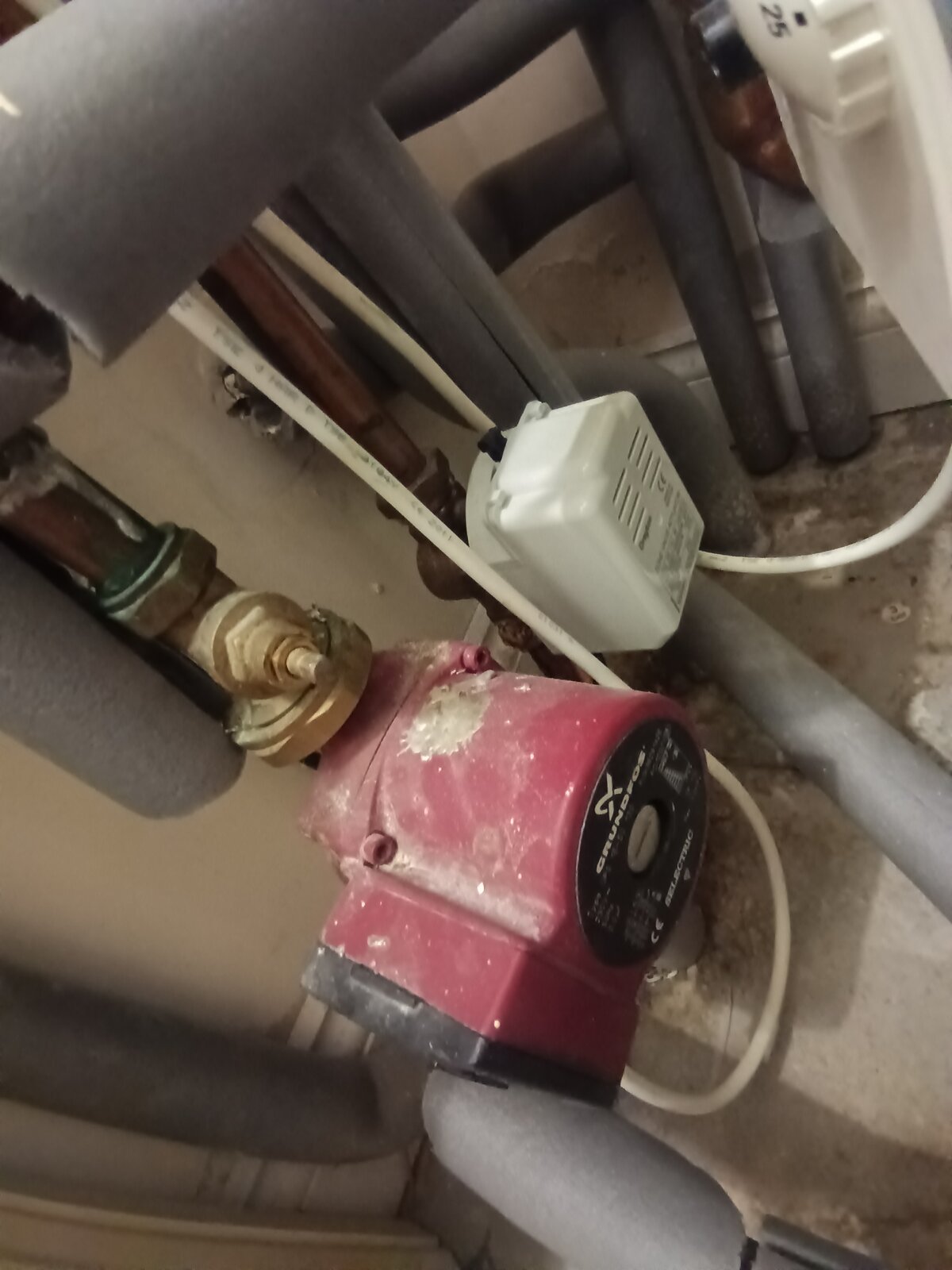

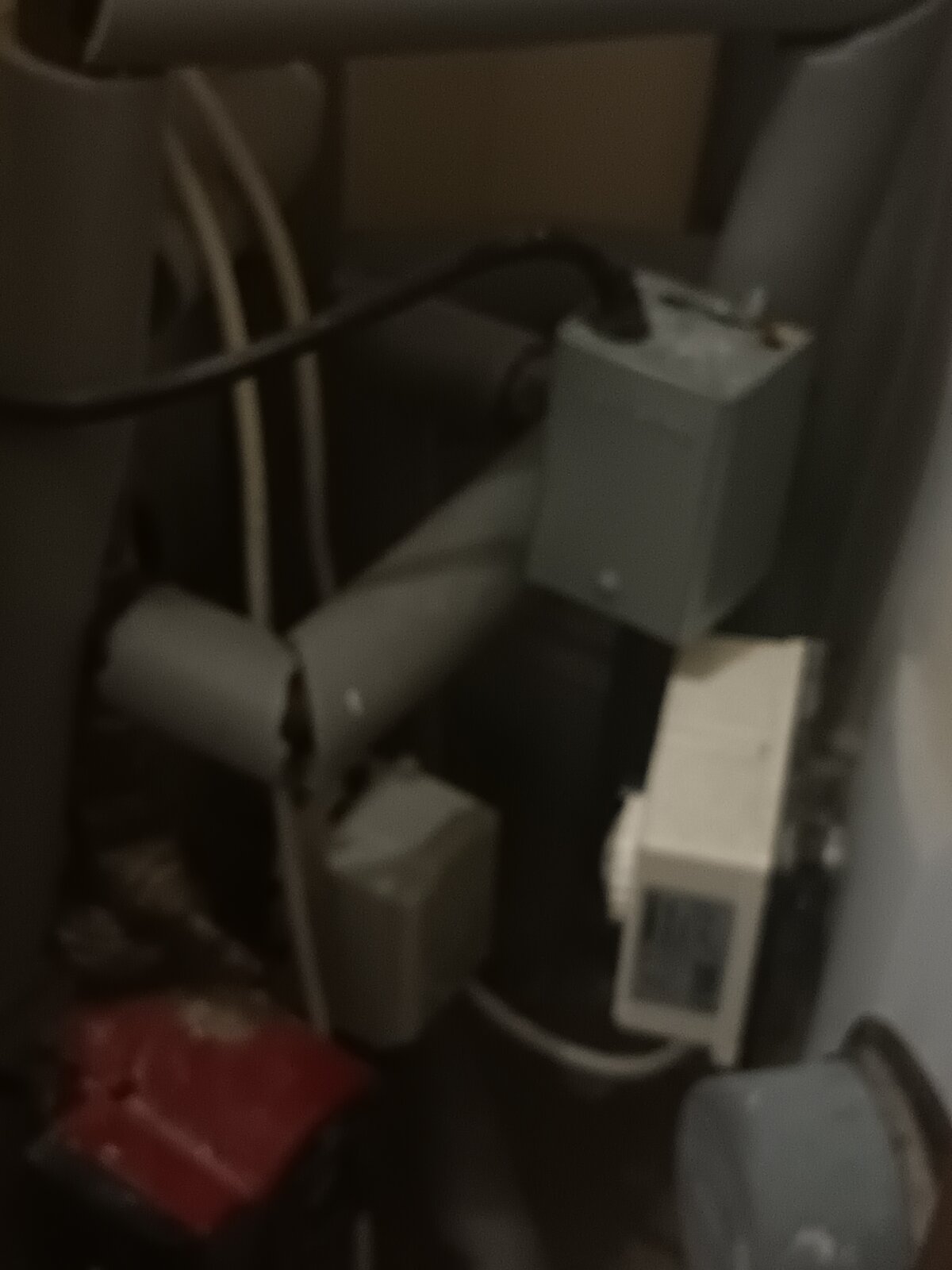

You have two motorised valves, one for HW the other for CH.
A red CH expansion vessel and a white potable EV for the HW cylinder.

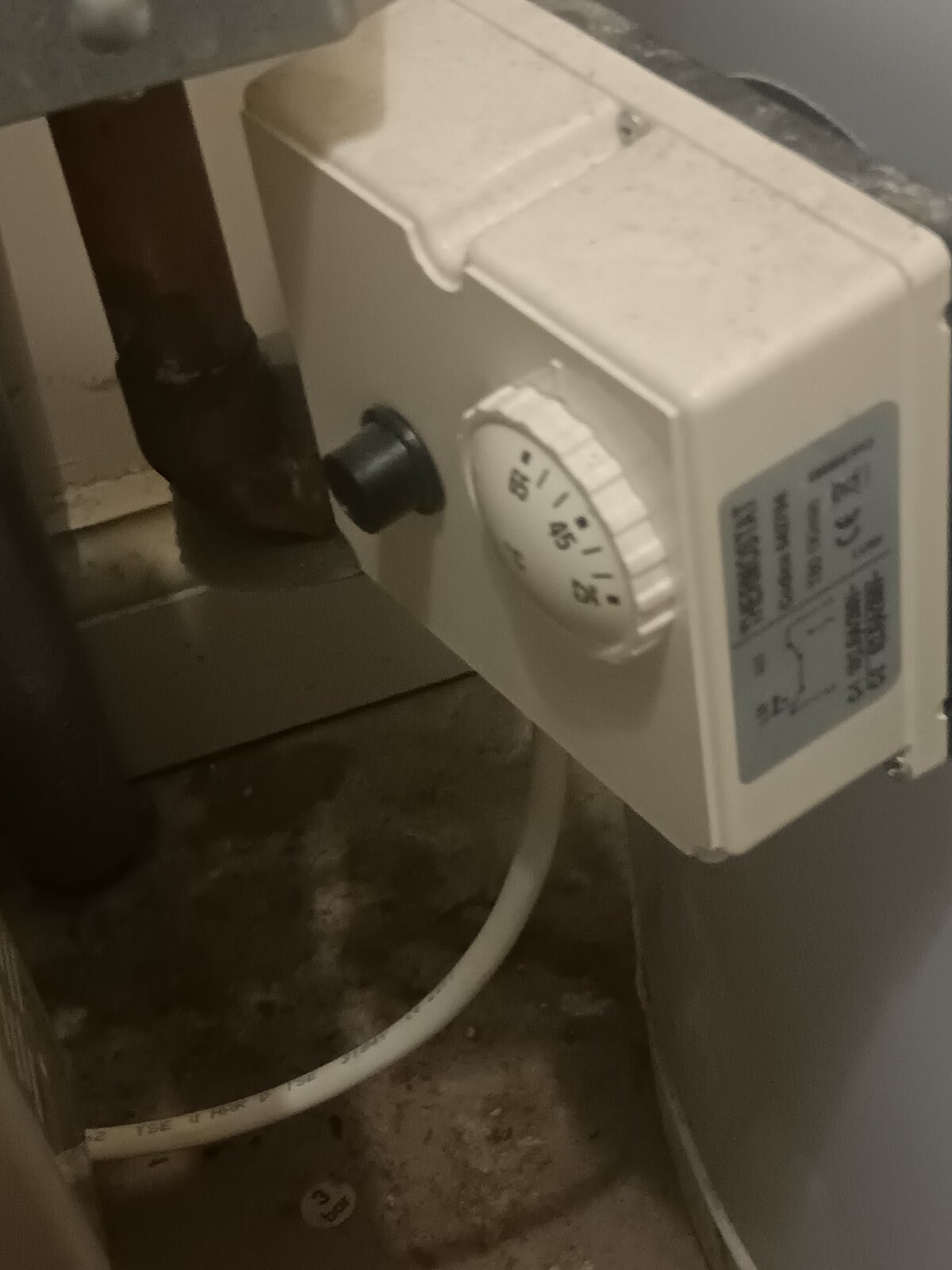

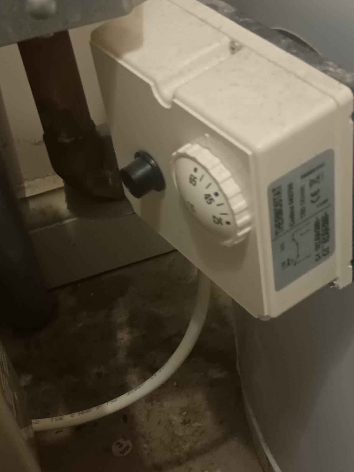

The HW cylinder thermostat is set for a scaldingly hot 65C :eek:
The Grundfos is the circulating pump for the boiler/heating.
Nothing there that should cause the Grundfos to randomly start. Assuming both CH and HW on the programmer are OFF overnight.
Other expert plumbers and heating techs are required methinks.
Thanks. Yes the hw is scalding out of the taps. What should it be set as?
55c should be more than enough. You can get a temp sensor to gauge how hot the water is on the tap and adjust based on that. The reason for heating the water to this temp is to ensure legionella is killed off.
