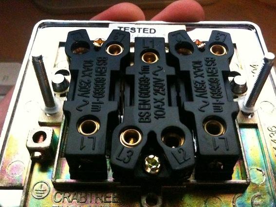

Hi. I'm hoping someone can help me with a problem I'm having swapping a light switch.
I'm redecorating the house and replacing old switches as I go, using crabtree platinum. I've come to do the one in the hall which will be operating the porch (1-way), hall (1-way) and landing (2-way). The switch is a 3 gang, 2-way (see below).
The hall switch (middle terminal block) works fine, but when I connect up the porch to the left hand switch (RH on pic)- Brown to L1 and Blue to L2 (nothing in L3) - the porch light is on when the switch is off and vice versa. I've tried connecting the porch wires to the other switches and when I connect to the middle switch it works correctly but the same problem occurs when I connect them to the right hand (LH on pic) switch.
Has anyone got any idea what's going on and how I can sort it out?

Thanks for the advice. I'm very aware of my limitations and am grateful for the links as I'm trying to read as much as I can to improve my understanding.
I had thought that a 'simple' like for like replacement following the wiring diagram provided would be straightforward and within even my limited ability. Apparently not.
As these are metal switches the front plate MUST be earthed.
This will require you check and confirm the earth wires are connected to the front plate AND that they are continuous to the Main Earth Terminal ib or by the consumer unit ( fuse box ).
Thanks very much for the reminder.
The three switch wires are all earthed to the back box and I have connected that earth terminal to the earth terminal on the front plate and sleeved the wire with green and yellow sleeving.
