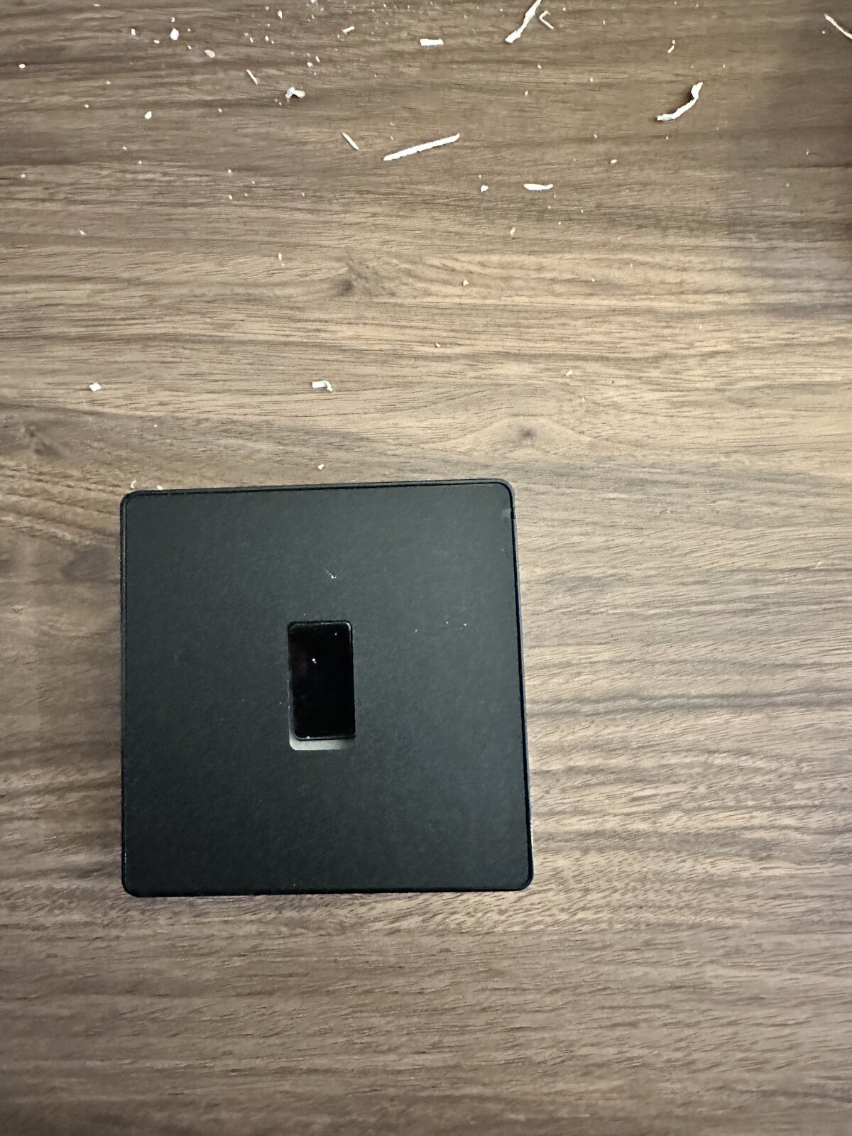

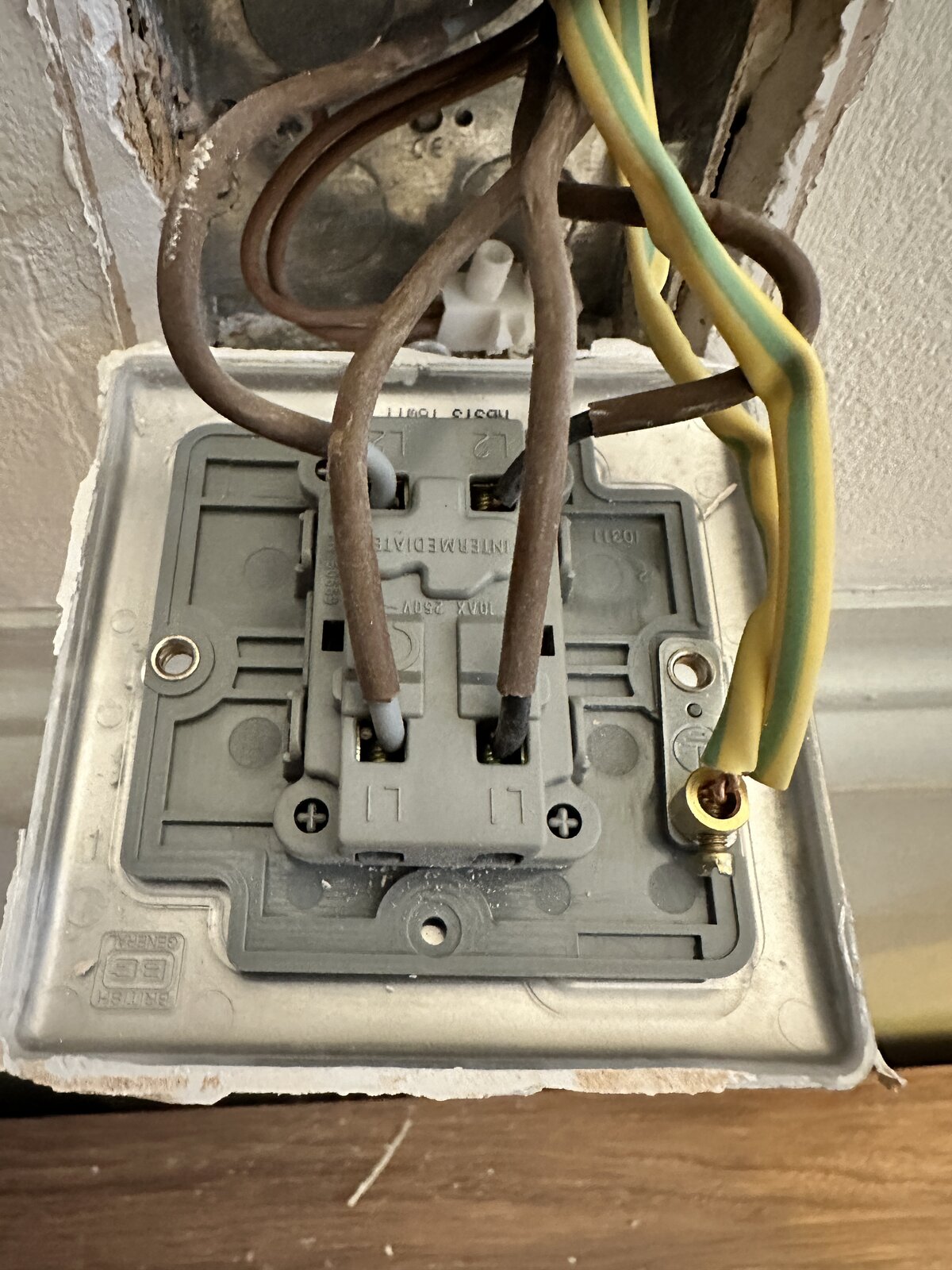

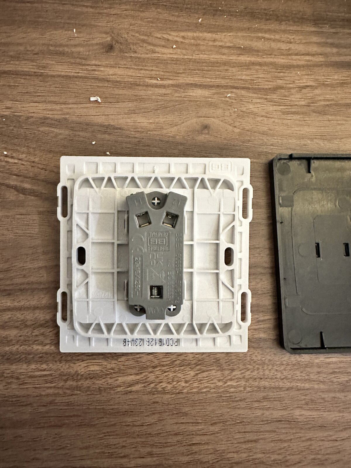

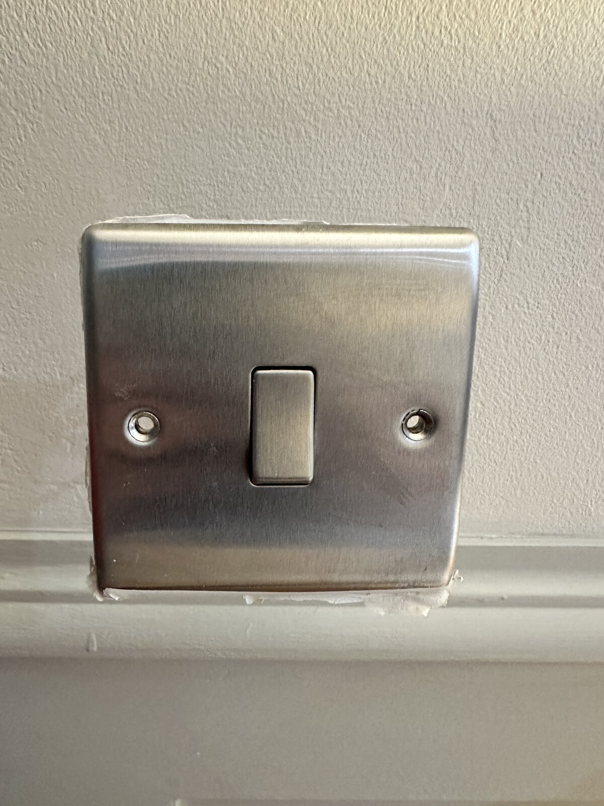

Hi folks
Looking for some quick assistance
Old light switch has 3 switch at end of hall for porch, outside light and hall light.
The switch I want to replace is the other end of the hall single light switch for the hall again with L1 L1 L2 L2 (no common)
All ports are occupied by brown sleeves wires.
Is there a way to wire this into new Light switch with L1 L2 and common?
Thanks in advance

No, you need an intermediate switch, as is stamped on the current one, if you want to retain the same functionality.
