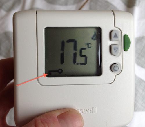

The new unit worked fine until last night when the key symbol appeared and then the boiler failed to fire when the next programme time came up. I had to manually trip the relay as the red failsafe light was lit. Does this mean that radio communication was lost between the two units?
What does this symbol mean?
This is exactly what happened with the previous unit. Although the heat demand symbol at least is still there this time.

Honeywell just advised that I take the batteries out of the thermostat and then when reinserted it'll reset... This doesn't work as after a few minutes the key symbol reappears and the system is locked again.

That symbol means the function you are asking for is locked for some reason... The possibilities escape me at the moment.

In this case it seems that the setting functions have been locked. I dont see that it would be necessary to lock it just because the unit had lost radio communication.

It could be in a tizzy and be thinking that the heating is off due to there not being a signal on terminal A of the BDR. Hence the lock symbol.
