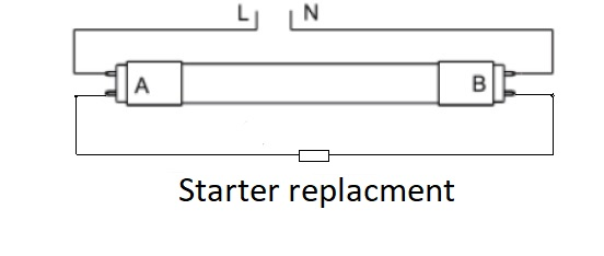

What do you mean by strip light? We used to call the fluorescent tubes strip lights, but today the flexible LED units are often called strip lights.
The same goes for rectifier, not sure what you are calling a rectifier? A LED replacement for a fluorescent is normally wired like this
The starter replacement is basic a fuse.
It’s an led strip light that you normally use with a driver, but this one is 240v and wired firstly to 2 Core T&E and uses this to connect to the other side of kitchen where the lights are stuck underneath the cabinet
