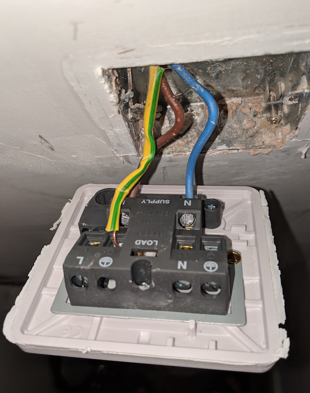

Hi there,
Having real difficulty getting through the knockthroughs on this backbox in a new build.
I am trying to install some cable for an intruder alarm control box. Wanted to run the cable for it behind the plasterboard where possible so it can't be tampered with.

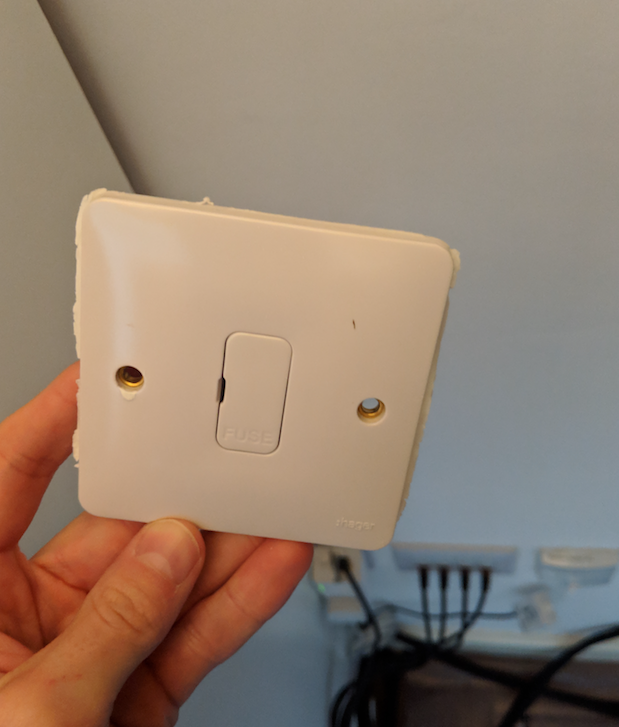

I have a fused spur as pictured which is labeled security alarm on the consumer. Just can't get the backbox off of the wall, don't seem able to break a knockthrough off, starting to make a right mess of the plaster. Any ideas?
If not, I might have to get a different front plate with a hole for a power cable.
Any ideas or suggestions would be appreciated...
I can't see any retaining screws. Is there one? If you undo any screws and run a craft knife round the outside edges of the box, that will release it from the plaster so you can pull it out.
The bodger who fitted it appears to have omitted a grommet.
Yes there were two, have taken them both off. Have tried with knives, screwdrivers, not budging. Running an electrical cable / stud detector across the wall is suggesting it is smack bang where a stud would be.
I have managed to use a hammer and screwdriver to get one of the knockthroughs off and it looks as though it is thick plasterboard the same thickness as the depth of the backbox. There is then breezeblock behind backbox so my plan is not going to work. Going to have to get one of these and run some flex. Very annoying..

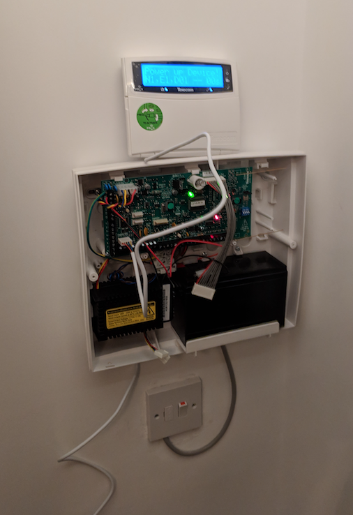

Thanks for all of the advice guys. Try as I might, the back box was not coming out. I don't know what they had done, but it was just tearing the plaster board apart trying to get it off. Have taken several other back boxes off in the house, with no issue at all.
Here is the final result, I couldn't wait for a non-switched spur so went for this for now. Will change to a non-switched when I get time, but as a few already mentioned, the fuse box is actually located in the same cupboard so an intruder could just flick the security alarm switch in the consumer unit anyway! It has a backup battery so should be fine.
Thanks for all of your help on this!
I know others might frown upon it but if you turn the FCU upside down you will then only have a tiny bit of cable showing
With a bit of judicious surgery (to the top 'edge'), one could probably achieve the same without having to turn it upside down.
Having said that, once the OP has changed it to an unswitched FCU, I don't think that even those "others" could really get very excited about 'which way up' it was installed!
