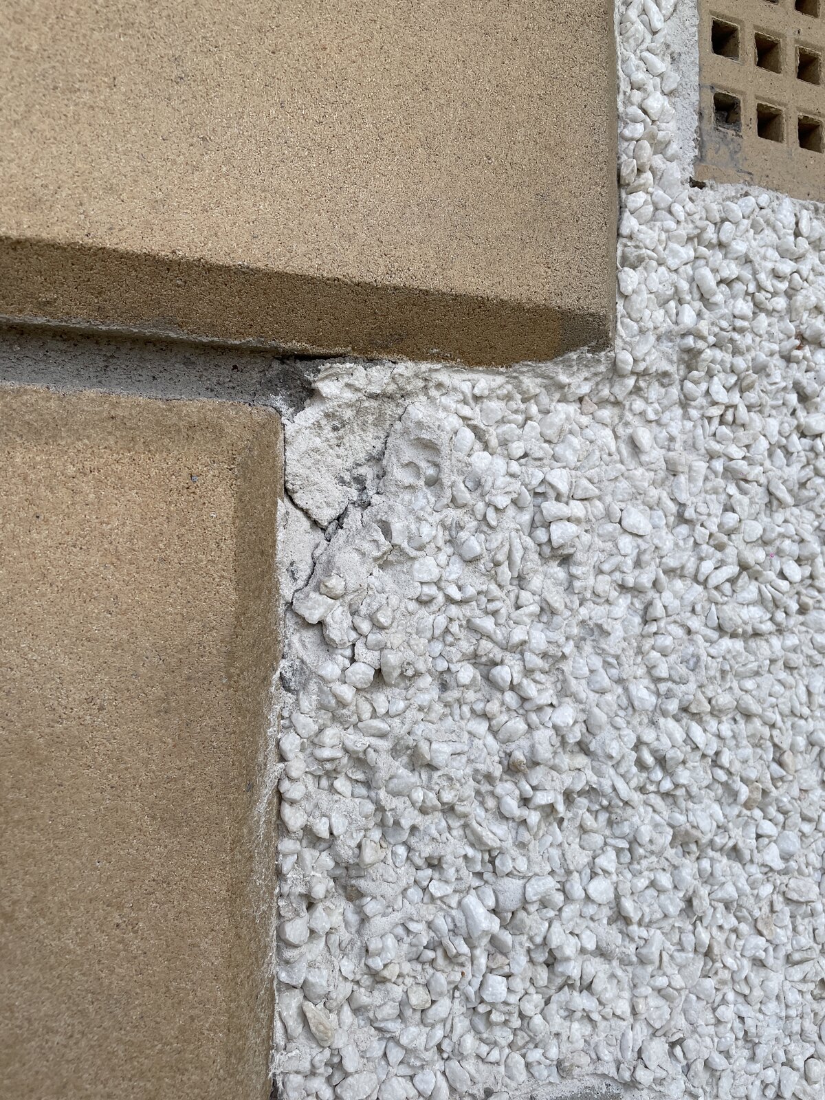

Hi
I’m wondering if there is a product you can buy in small tubs to do small repairs to pebbledash?
Keen to get it filled as it looks a bit worse than it did before winter!
It’s a white colour I need, picture attached…
Toupret masonry filler from DIY.
Stick some stones in and paint it to match in best you can.
Only other option is find local company that works with that sort of thing
