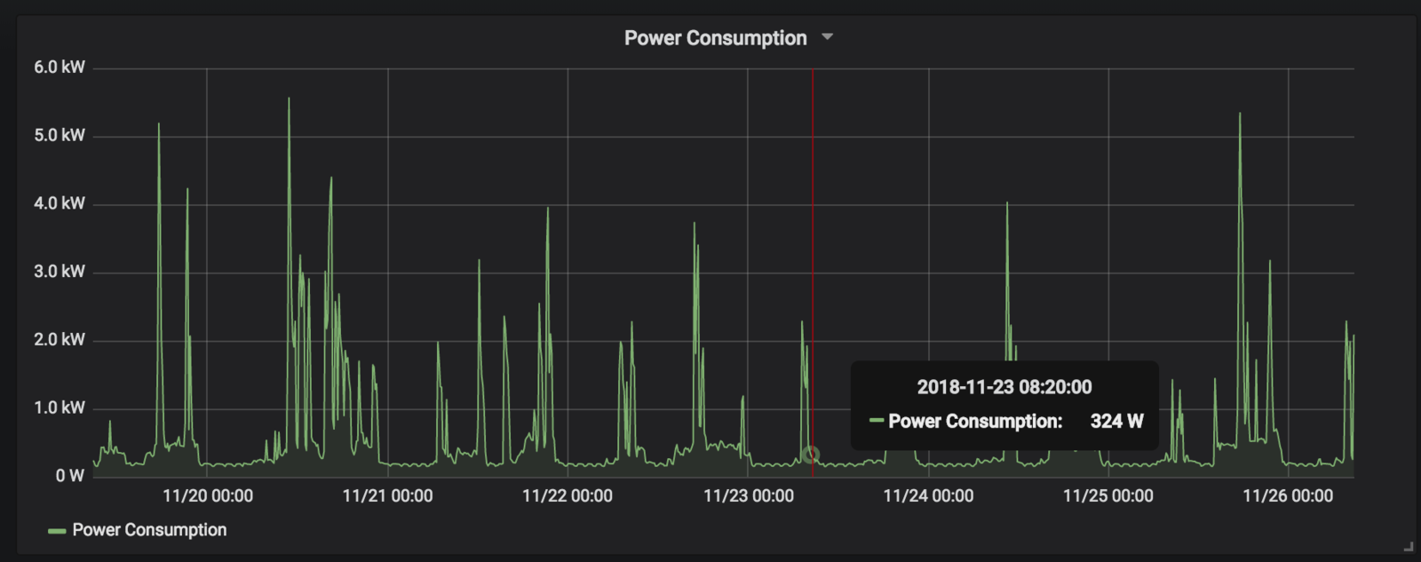

I would personally buy a CurrentCost ENVI, they are a 433mhz CT Clamp thats battery operated (batteries last for years) that you put over your meter tails and they report in the consumption ever 6 seconds, you can then intercept their radio using an Software Defined Radio USB stick like a NooElec and rtl_433 software (all of this will run on a Raspberry Pi), you can then use this to make decisions about switching relays... In my place I have no such need due to the abundance of power (100A supplier feed, 24KW) but I still log my electricity usage in this way so I can shout at the other half when the tumble dryer has been used on a sunny day :D. Of course 6 seconds is a long time and you'll probably (should almost certainly) trip your supplier MCB way before that.
