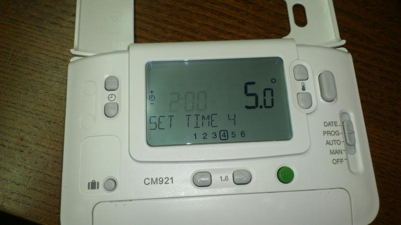

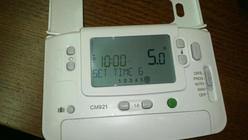

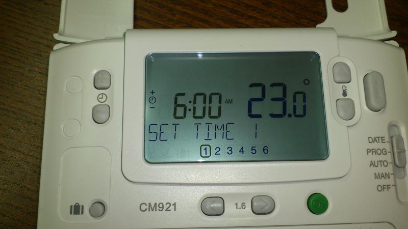

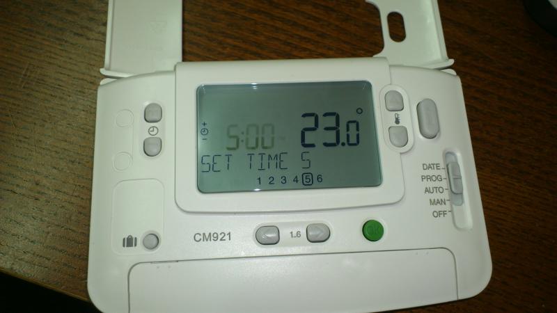

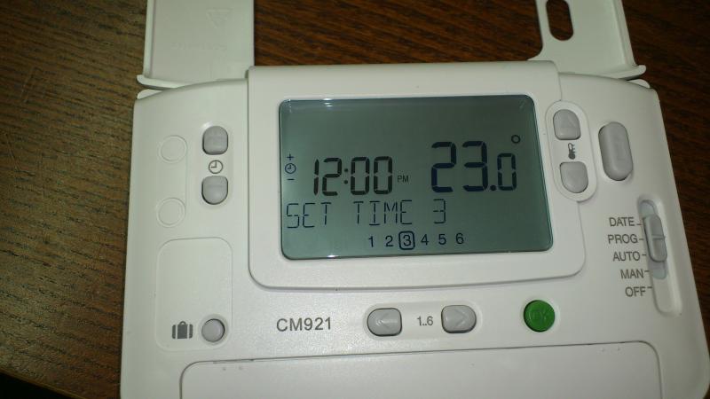

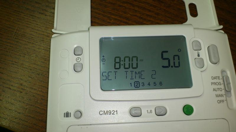

See these photos below of the actual CM921 I have. It will show you that there are JUST 6 settings which you can set on different Temp on set time.
So if I want to use it a time Switch it only count as 3 ON/OFF Programs. Which obviously it is not made for to be used as Time Switch.
So my question was if I could use a time switch like I had before on another boiler in this new boiler ecotec Pro 28 instead of honewell CM921!
Which has been confirmed by a member above.
