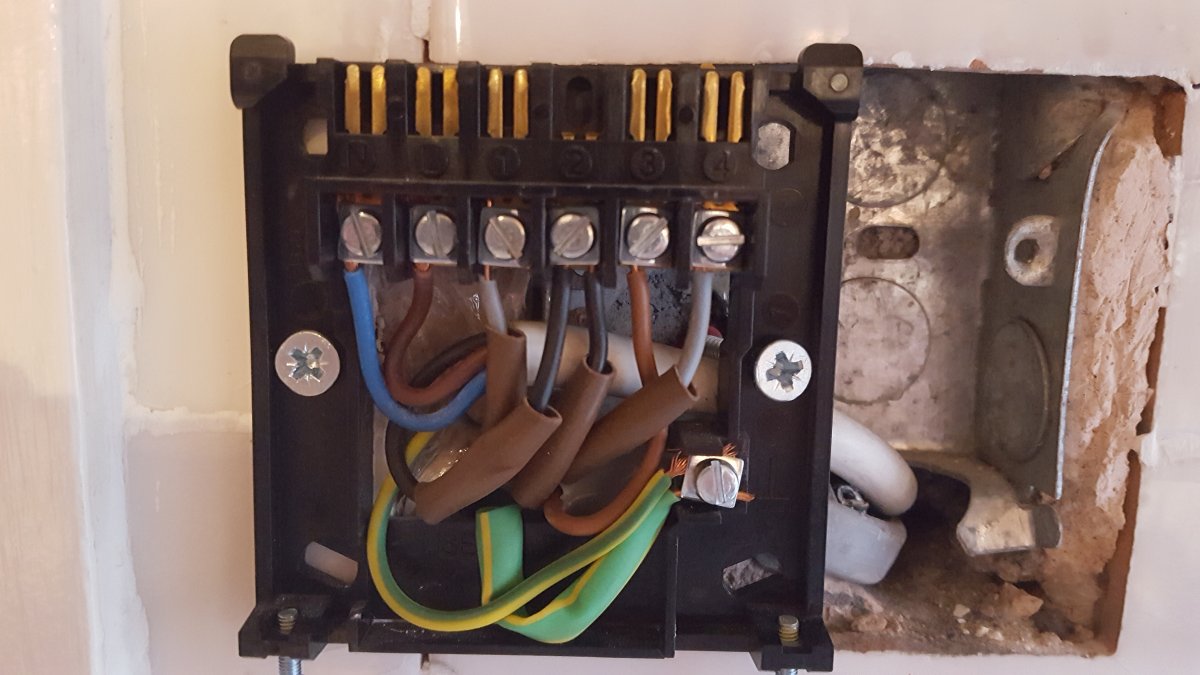

Hi,
My heating system no longer responds to the stat/programmer and can now only be controlled by turning the boiler down.

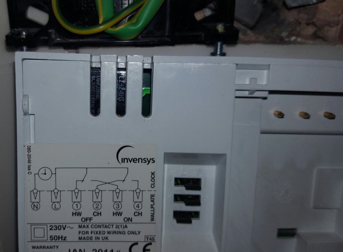

I've removed the front of the programmer (British Gas UP2, which seems to be a relabelled programme made by Invensys) and can see a pin missing - see first attached picture!
So am I right in thinking this is probably the cause of my issues?
And before I go ahead and replace this could someone please help me make sense of the wiring here? It's a Y-plan system, so is it normal that there are 2 wires going into the CH OFF terminal? (See 2nd pic)

No! The 'pin' missing is where the installer has cut it out so he can use the terminal as an extra one, If you were to replace it something boiler would likely run all the time the heating is switched off! You should fit the 2 black wires into a separate connector block if you are replacing the backplate as well.

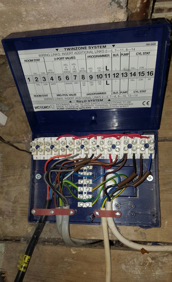

Good! Locate the wiring centre where the 3 port valve is wired back to and post a clear photo of the wiring if you can. With the heating and hot water off at the programmer, measure AC volts between the blue wire and orange wire of the valve.

Full pic attached
Leftmost black wire coming in is the 3 port valve. 2 greys next to it I have no idea. The next white cable along is the pump. And the very last white cable is the HW stat.
