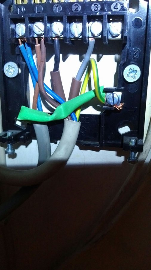

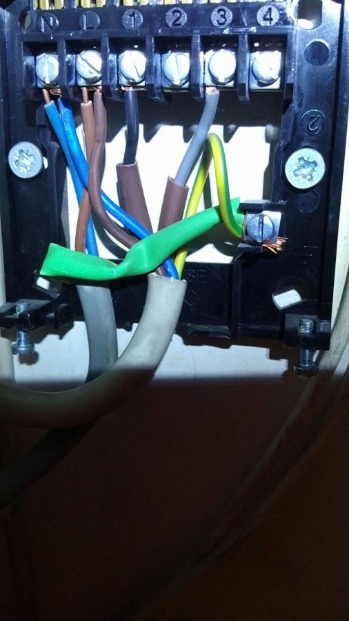

Programmer/stat not controlling heating - trying to make sense of wiring?
Can you post a photo of the receiver wiring? It's very odd that it can't override the programmer and switch the heating off.
Sure. Pic attached.
The wire on the right goes into the programmer
Thanks, now with the programmer back up on the wall and this time the thermostat receiver removed from it's backplate does the boiler run at all for heating. It shouldn't be able to, whatever you try at the programmer.
While its removed you should also check the voltage on the grey wire at terminal 3 of the receiver backplate both with heating set to ON and then to OFF by the programmer.
It should be 230V for ON and something closer to zero when heating is set to OFF.
Looking at the pic of the wiring centre, the grey from the valve (black cable) appears to connect to terminal 7, but there is nothing else connected to T7. Is this correct? It's very difficult to trace all the wires - even with it blow up.
