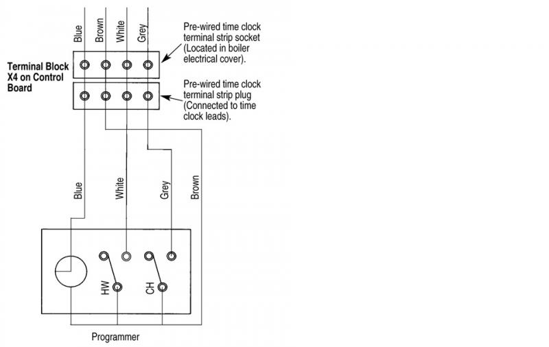

hi all
can i disconnect the c/h side of a programmer and just put a on/off switch on
till i get a new programmer
ta
It all depends. Make and model of programmer would be useful.
Programmers usually take live mains in to power the clock and the same live is then fed out as a call for heat, via room stat etc.
Sometimes the programmer does just provide a pair of switched contacts.
andytw
There is a manual on-line , see page 22.
I can't post in a tidy link, search for 'worcester bosch heatslave 12/14 manual'
Looks like mains live goes to the programmer as 'Brown' and this exits the programmer as White for 'HW' and as Grey for 'CH'
Take care, you are dealing with mains electricity !
