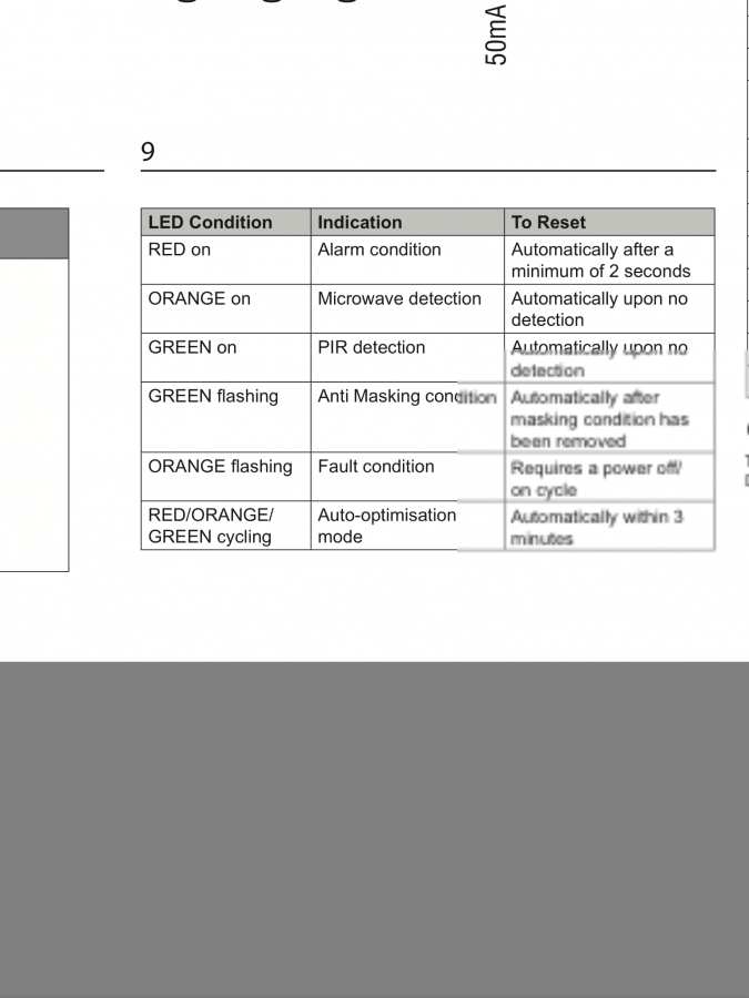

One further question is the PIR's......i used texecom Dual techs and some twins......i know i can disable the led's which im going to but whats with the green,orange, red ones?? Only ever seen PIR's with one LED.
Thanks guys
The led show different status on dual tech sensors
depends on which detector as to what the leds stand for its not the same on each one, it should be in each manual what the leds stand for on that particular model of "PIR" so the above is for an AMDT
