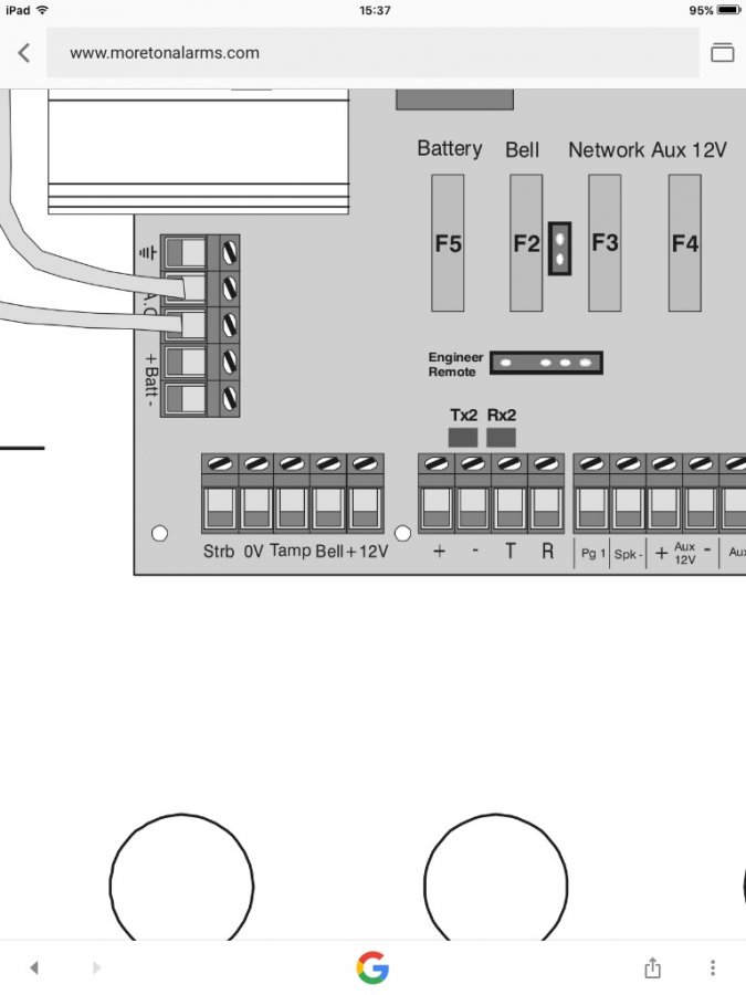

Apart from the external sounder rings when i test trigger the alarm even with the bell wire pulled out of the panel.........i have also tried to change the bell delay (temperorarily) in the programming so it doesnt sound yet it still goes off............any ideas if this can be done?
Post photo of bell wiring connection with trigger out
Is it external bell ring when you test?
Sounder should not sound if trigger wire out
Struggling with photo on this phone.
I have red 12v, blue bell, yellow tamp, black 0v and green strobe......same at sounder and panel end.
Log out of engineer mode with blue disconnected at panel and when i do a user set bell still sounds when i trigger a PIR
If you have not got your blue trigger wire in bell terminal in panel then the outside bell will not ring when alarm triggered

Something weird going on handymanjo.....i have the wire out of the bell terminal in the panel yet the outside sounder still rings when i trigger an alarm.......
Is the strobe trigger still the panel ?
Does the strobe flash when you trigger the alarm?
Check bell wire for shorts between bell trip and strobe trip ?
