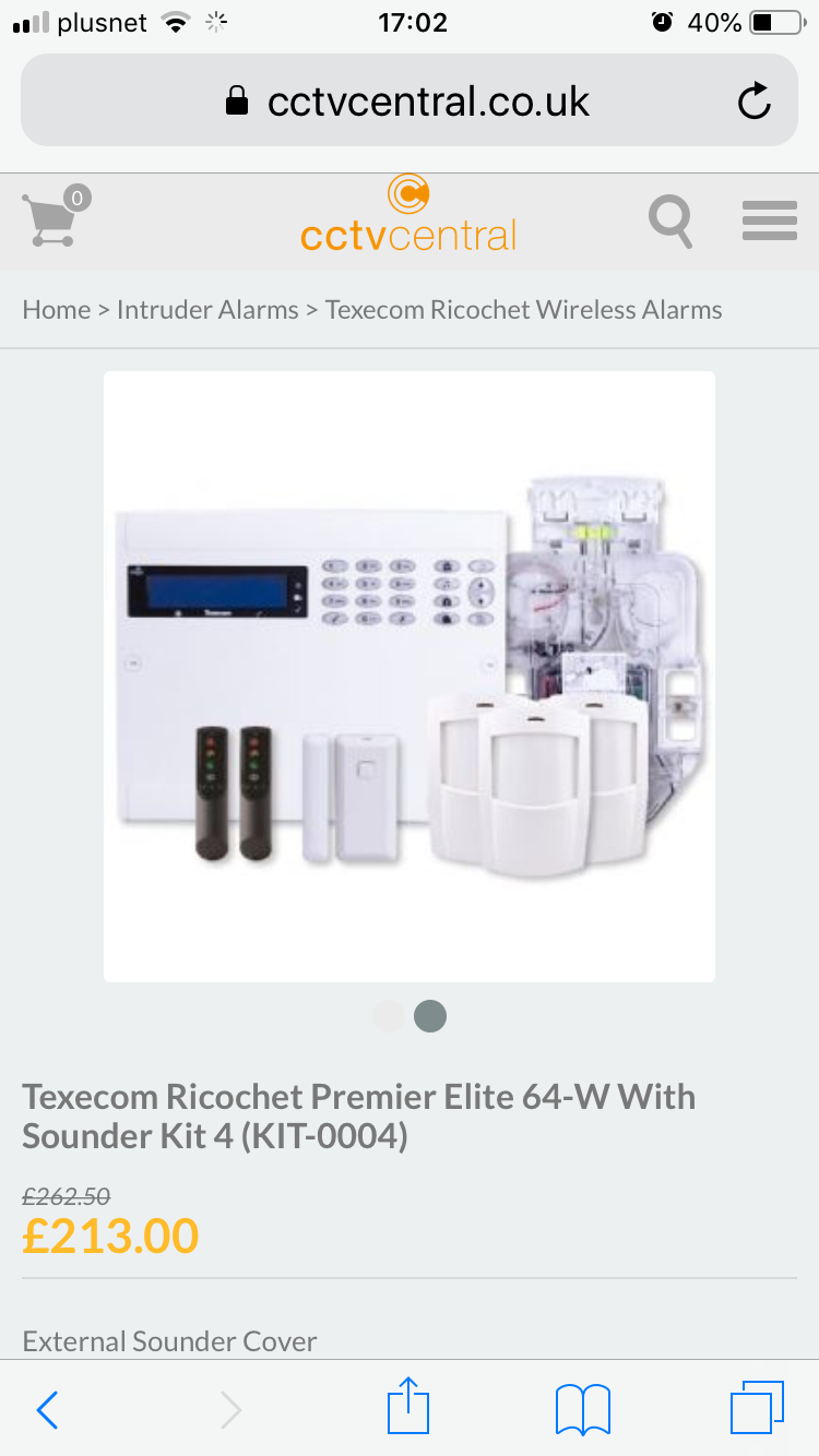

Am after a recomendation for a wireless alarm. Im an industrial sparks so dont generally do alarms but i have done a dozen or so in the past, Accenta or Texecom prem 24 usually. They have all been wired systems programmed with wintex.
I am wanting to fit a wireless alarm to a property. Wired would be better i agree but the cable runs are a total nightmare and it will have to be wireless.
System will consist of a panel and keypad (or an all in one), 3 PIR's, external sounder and 2 mag contacts.
Im probably biased towards the texecom richocet as used texecom before but will fit anything thats quality. Im looking for reliability and stability in the system as false alarms would be especially not desired.
The whole lot for around £300 would be ideal but they seem a little pricier than wired systems.
Any comments apreciatted.
Cheers
D852A6BB-FA23-4A1E-B261-46747EBB90F2.png Kit 4 is probably nearest
Or enforcer kit 3 ( my preferred choice on all wireless) although I am a long time installer of the premier

Kit looks good value, looks like id just need a battery and cover for the sounder (+another contact)??

3 points .....don’t like the pirs in the kits , not too keen on the bellbox , would rather fit an hardwired one or at least with the pyronix , psu in the loft via the 12v input and finally you get a free WiFi card with the pyronix ....it’s about time Texecom started adding the smart comm in kits ....
True, the PIR's in kits tend to be the lowest spec ones...........any personal experience with poor texecom wireless ones?
I don’t rate the wireless pirs included in kits 1 to 4 and 86. The compact pw.
First reason don’t like pet wise sensors.
Don’t like the built in aerial
Don’t like the way the tamper mechanism damages the pcb.
Maybe The Texecom MD who does come on here ocassionally can look at the kit comments, asked for it to be revised with others many times.
You can flog the pw sensors on eBay and recover the costs and replace with QD or DT in the wireless range.
Programming is the same wrt to function, just the commissioning mode and learning devices on where you will see the main difference.
As for pyronix over texecom, pyronix wireless has frequency hoping to prevent radio jamming stopping the alarms wireless devices from functioning during a jamming event.
